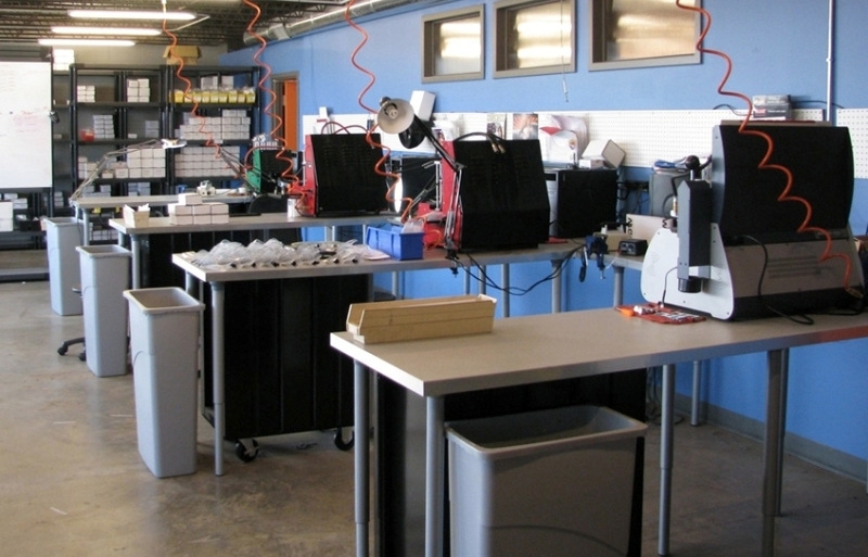

Thankfully, NICOclub.com has a long history with the team at Deatschwerks – a relationship that dates back almost to the beginning of their company in 2004. They started out with providing injectors for popular Nissan engines (SR, VG and VQ), and rapidly branched out into other brands and applications. They’ve expanded into a dedicated facility, housing a state-of-the-art lab where all the service and testing occurs.

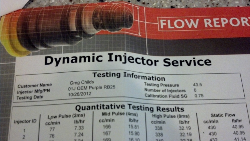

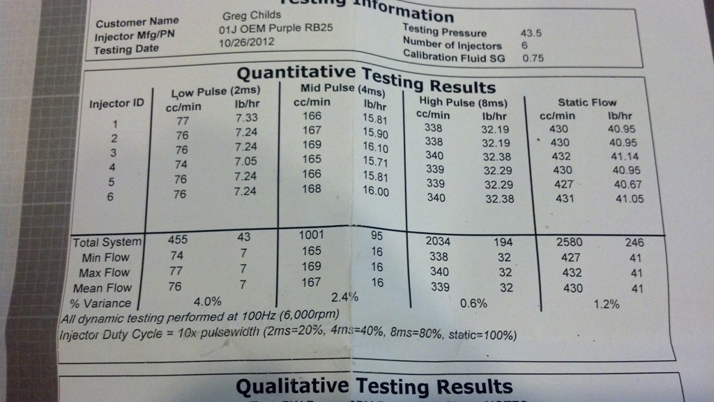

Last, but not least, you’ll get a personalized flow report printout about your injectors, including all the data from their intensive and thorough testing – Cool stuff for gearheads, and something no one else is doing. You can read more about the details of the Deatschwerks customized injector flow report here.

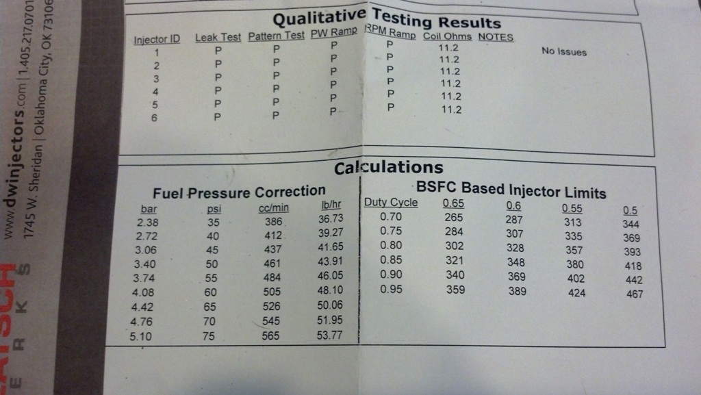

Here’s my report:
Okay, enough about the guys in the white lab coats – The outcome is all we care about, right? I’m happy to say that, as usual, the DW service was impeccable. The fuel rail for our RB came back looking factory-fresh, with new injector cap screws and ready to drop in. Three bolts later, she was ready to fire up – and the difference was impressive. Startup was quicker, idle was WAY smoother, and miraculously, that “over-rich” fuel smell was gone! I don’t have to tell you that a low-mileage RB25 in a 1900-lb classic Z is a recipe for tail-wagging shenanigans, but the power difference is even more noticeable now, with smooth, linear (and ridiculous) acceleration all the way up to redline.
