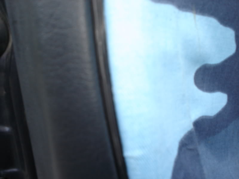

6. After the panel is removed, pull the old insert out.
7. Clean the area thoroughly.
8. Apply Masking tape to the surrounding areas to avoid overspray
9. Measure the panel and cut it at least 6" larger.
10. Apply the adhesive spray to the door panel, along with the back of the door panel. Note:Allow the spray to cure for the recommended time for the product.
11. Match the fabric with the door panel and work out any air bubbles. then press the piece onto the door panel, starting with the middle. Note:For best results work from the inside out.(Much like applying a sticker)
12. Insert the vinyl cording, and trim any excess fabric.
