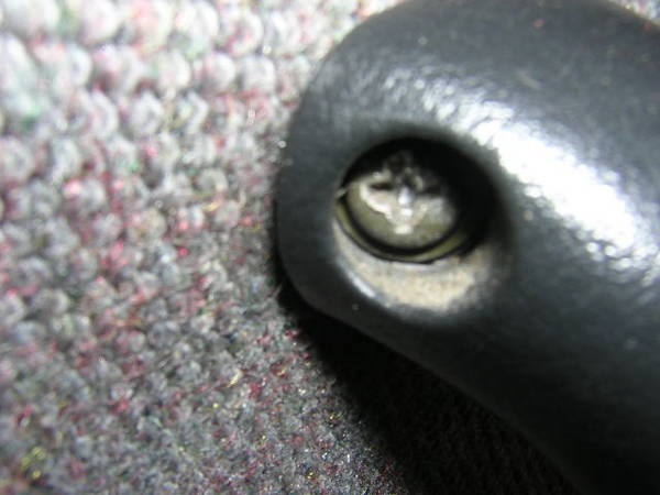

First, you take out the plastic handle. This is done by a screw in the bottom of it. There is a plastic covering on top of the screw that you will need to pop off with a screwdriver.
