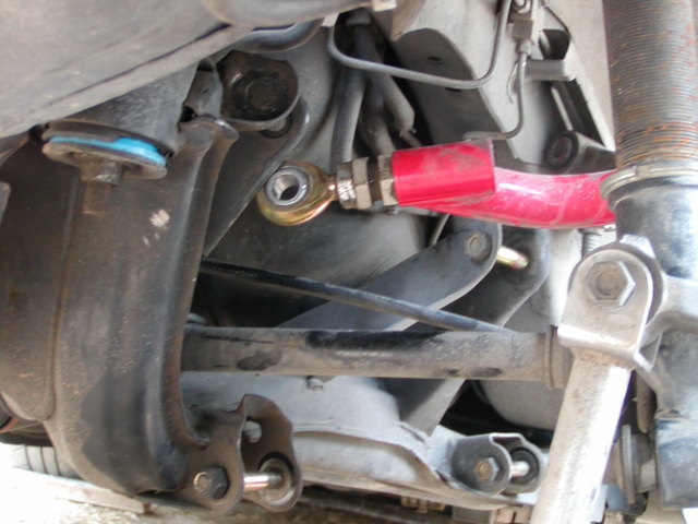

Take a good look at your subframe and how the suspension components are attached to it. Make a note of all of the sizes and types of wrenches you will need to remove the bolts attaching them. Go about disconnecting them.

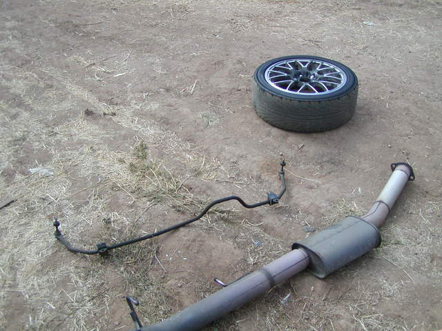

Remove your exhaust and swaybar (if you have one :P) and pull your axles. Next, pull the e-brake bracket and remove the driveshaft.
Place your floor jack under the differential and unbolt the subframe nuts in a cross-pattern. Balancing the assembly on the jack, lower the subframe and remove the differential.
