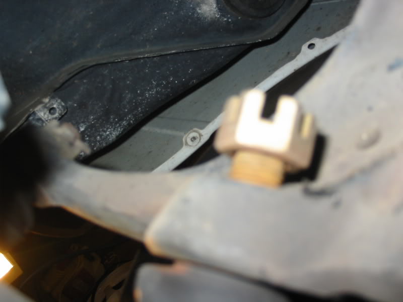

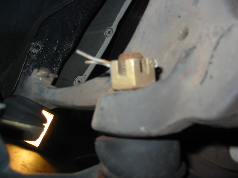

Use needle nose pliers to straighten and remove the cotter pin on the nut:

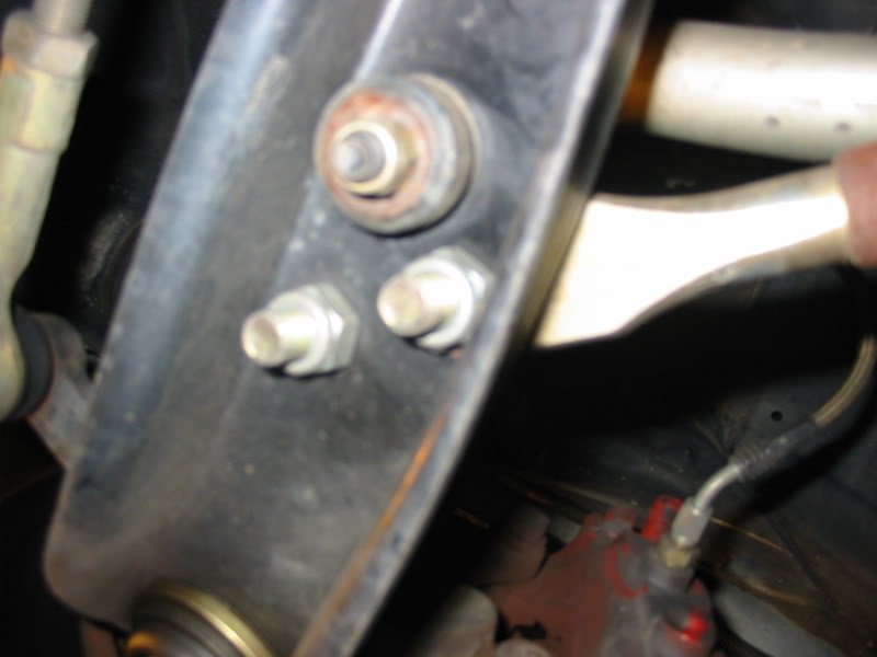

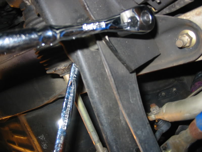

Remove the 14mm and 19mm bolts holding the old FLCA to the TC rod and anti-sway bar:

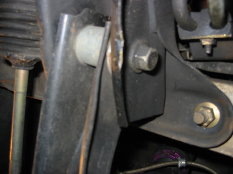

Remove the bolt holding the FLCA to the cross member. A breaker bar would be a handy tool to have in this situation. Remove the unit when done.

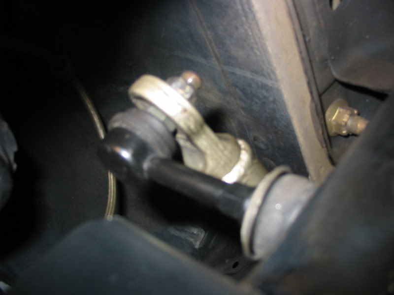

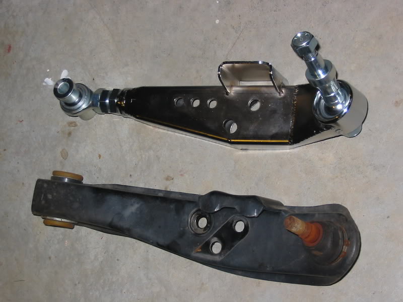

Comparison of the new and old FLCAs:

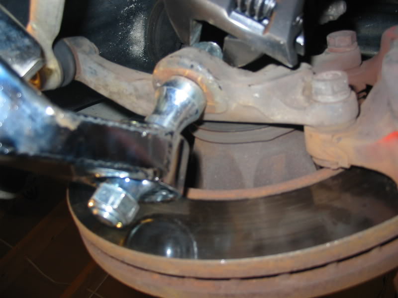

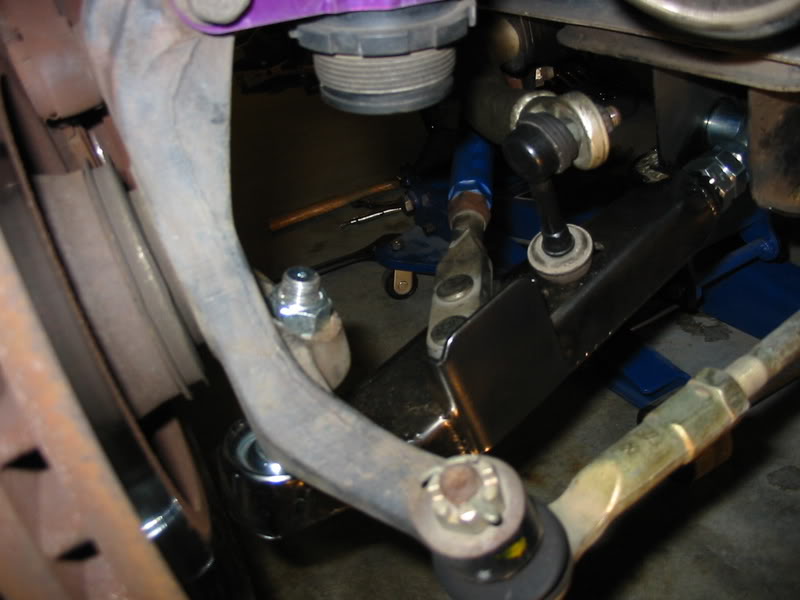

Put the ball joint in on the spindle and use a crescent wrench to tighten the nuts on both bottom and top of ball joint. I had to do this without anything else attached to be able to reach the nut:
Aftermarket sway bars may be too thick to allow proper maneuvering to reinstall the new FLCA. I had to remove the bolt on mine to gain clearance:
Also had to loosen (but not remove) the top of the the anti-sway bar end link, using 14mm wrench and 14mm socket. Just tightened both the mounting points and end links after everything was installed.

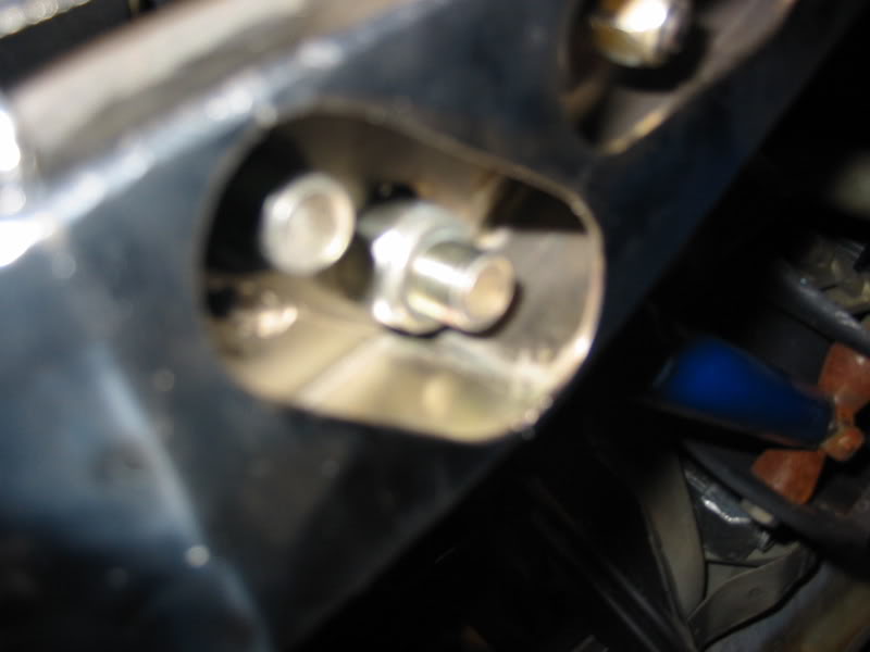

After you move the FLCA into place, you should be bolting the end link and TC rod using the 14 and 19mm nuts.

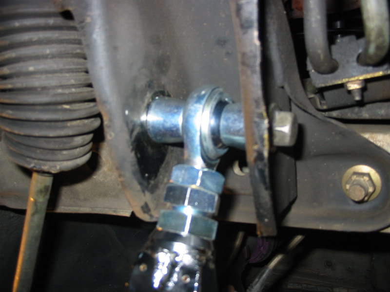

attach the cross member bolts:
All done:
