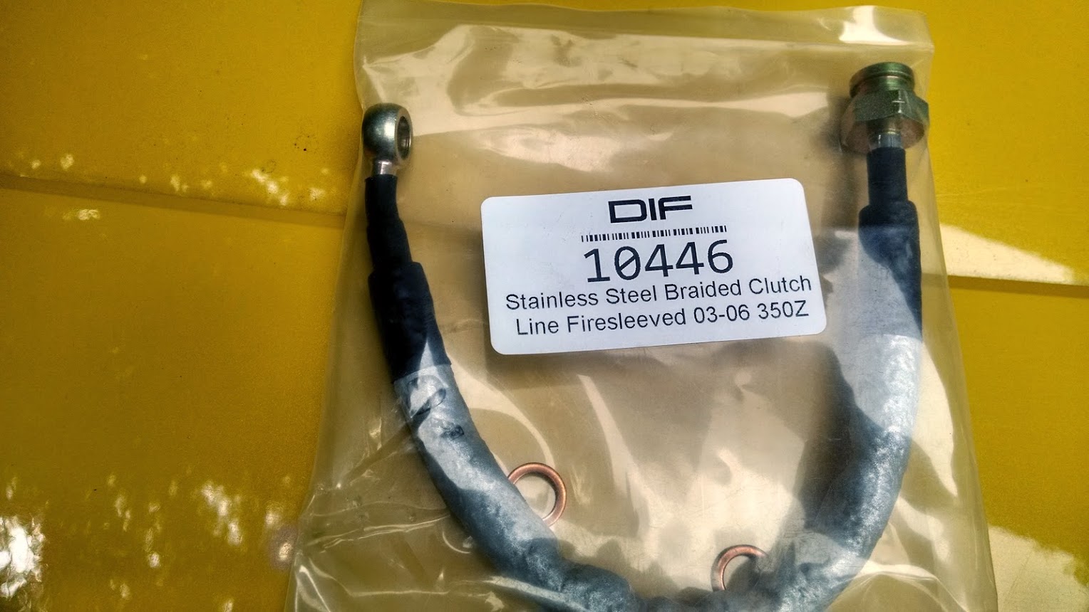

I called several retailers and explained how I couldn’t find the Nismo clutch line anywhere in the US and when I pointed out that it was the insulation jacket that I really wanted, they suggested the DIF stainless steel braided clutch line. The sleeve on the line is rated to 1090 degrees – CELSIUS, that’s nearly 2000 degrees fahrenheit for those that aren’t metrically gifted, heat will no longer be an issue!
DIF_Clutch_Line           Clutch_Install_Bits

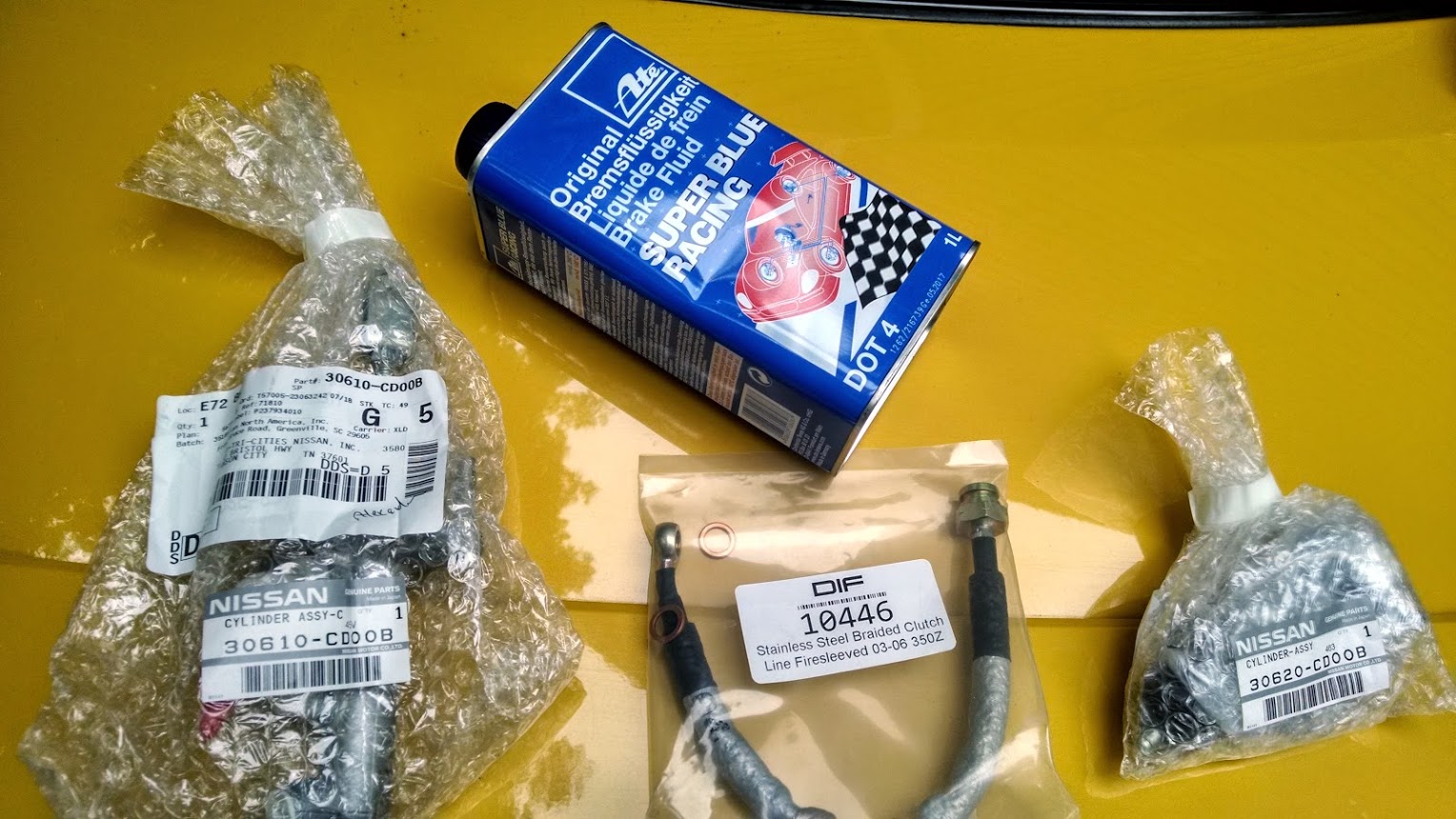

Armed with the new line, master and slave cylinders from the local Nissan dealership and one of the last unopened liters of ATE Super Blue brake fluid from my garage I was all set. Installation of the line is straightforward. More time will be spent on bleeding the clutch than anything else, but with the master and slave cylinder replacement that was going to happen anyway. I drove easy for a while getting used to the feel of the new bits but later took a 45 minute blast through the mountains and didn’t have a single problem. Well, I did have one… I wonder how long will it take for me to unlearn the gesture of trying to raise the clutch pedal with my foot?
