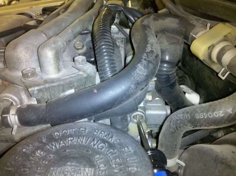

Disconnect the AAC connector from the IACV (Idle Air Control Valve)
seen here (yellow)

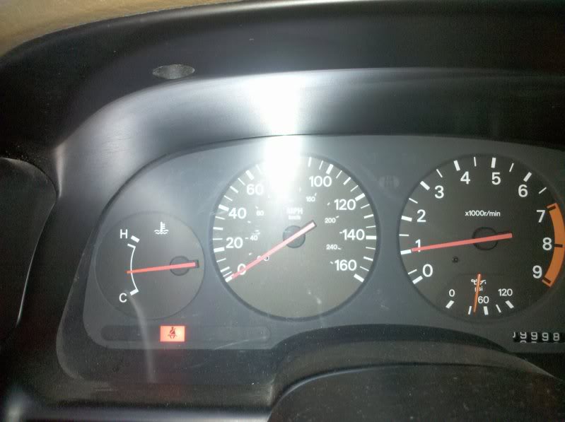

Start the engine and use the IACV adjustment screw to lower idle to 650rpm
Turn clockwise to lower RPM and counter-clockwise to raise RPM
Final step is to plug the AAC connector back in and your idle should rise and then settle to 750-800 rpm
