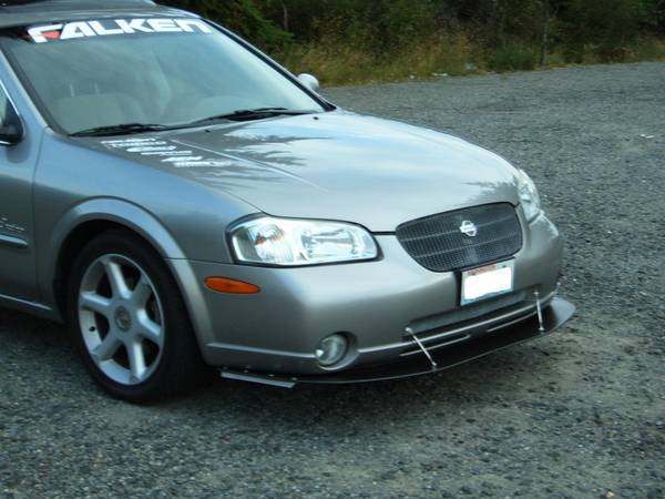

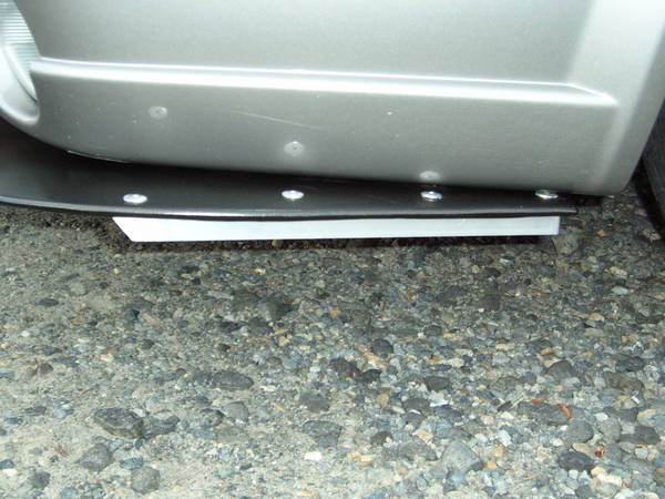

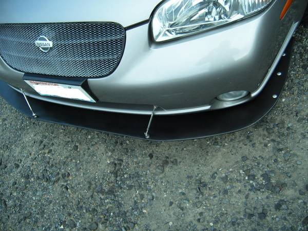

Put under front end, drill 3/16 holes thru splitter and bumper, and rivet in place (use 3/16 washers on backside of rivets to keep from “popping thru” the urethane bumper.

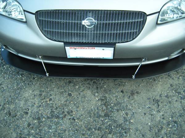

Optional- spend $50. on wind splitter support rods. Done, enjoy a beer, or in my case a Pepsi and enjoy your new aggressive look. (Some adjustment will need to be done to achieve the proper amount of downforce)
