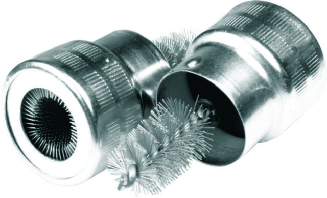

Next, go get a couple cheap wire battery post cleaners – keep one in your garage and one in your car. These cost no more than a couple dollars. This handy tool takes oxidation and filth off the posts and minimizes resistance between the terminals and posts. Use the tool to get bright, shiny metal showing on both the battery post and the inside surface of the terminal. Any barriers to conductivity will decrease the amount of current reaching your starter and your electrical system – AND can inhibit charging system effectiveness.

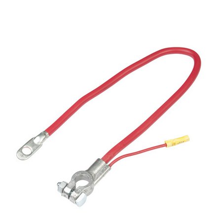

NOTE: If, after cleaning, your terminals look damaged, corroded, or just plain funky, replace them. Corrosion will travel along the copper stranded wire, inside the insulation, and prevent adequate flow of current, rendering all your efforts useless. In fact, you may be better off replacing the entire cable. Make sure to use the proper molded-on clamps and heavy-gauge replacement cables – Typically, replacement cables are less than $10.
Don’t be tempted to strip back the insulation and slap on a set of $5 “universal” replacement clamps. They’re junk, and you’ll be doing this same dance all over again in a short period of time.
