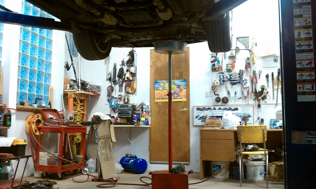

1. Jack the car up in a safe manner so you can get under it to do the work.

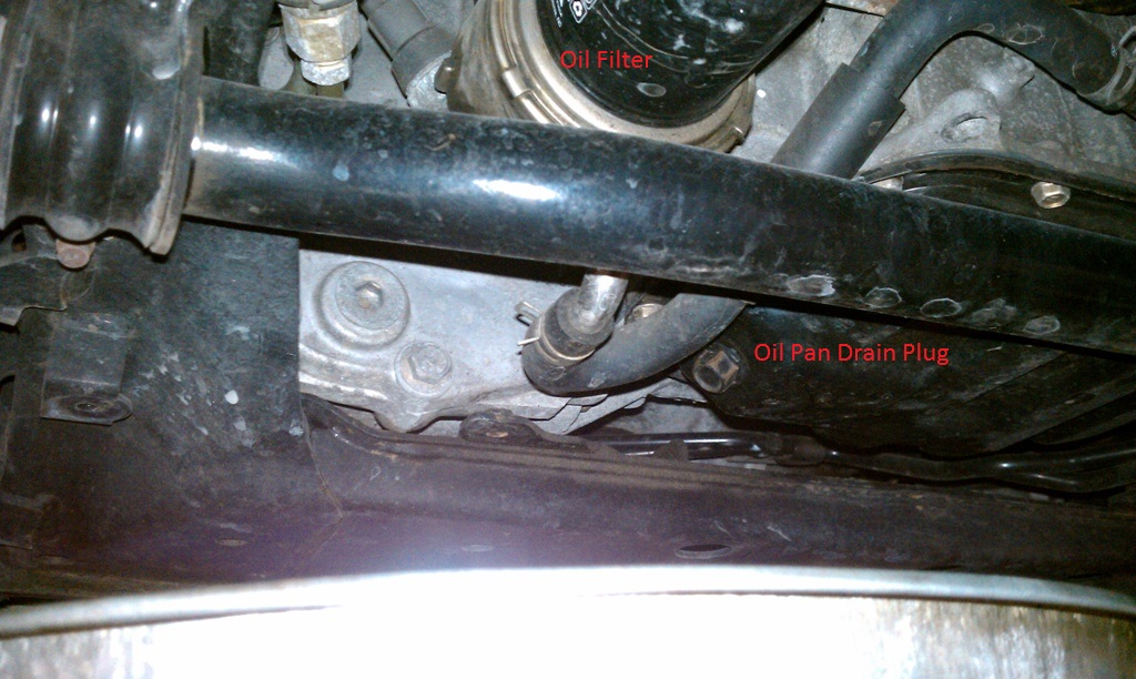

3. Unscrew the drain plug and drain the oil into your catch basin using the 14mm wrench you have. Let it drip until there is barely anymore drip left. Screw the plug back in as tight as you can.
4. Unscrew the oil filter and let that drain (I completely remove it – not shown in the picture). Prior to installing new oil filter, take your finger and dip it in FRESH OIL and gently lube the rubber seal on the new oil filter. Then install the new filter and get it nice and tight. Use the rags to clean up the oil that’s on the stabilizer arm, etc.
