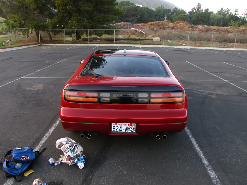

-Prep the tbl by masking everything off around it, make sure and take your time cause you don’t want to get any paint on anything other than the tbl. I also suggest masking off the actual brake light part withen the tbl to keep it stock looking a sharp razor blade will help alot with getting the correct shape for this. Also remove the nissan sticker your tbl may have like mine in the pic.

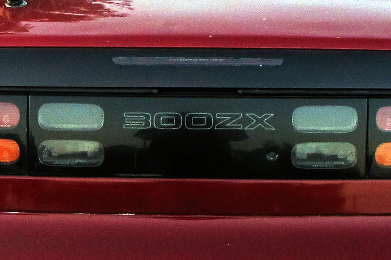

Final outcome should yield you the following
Before
After
Note you can see it still looks slightly dull in the pic above, that was before the zona polishing paper.
Here are some a year later with how it’s holding up, shows no sign of being any different than when it was just done.
