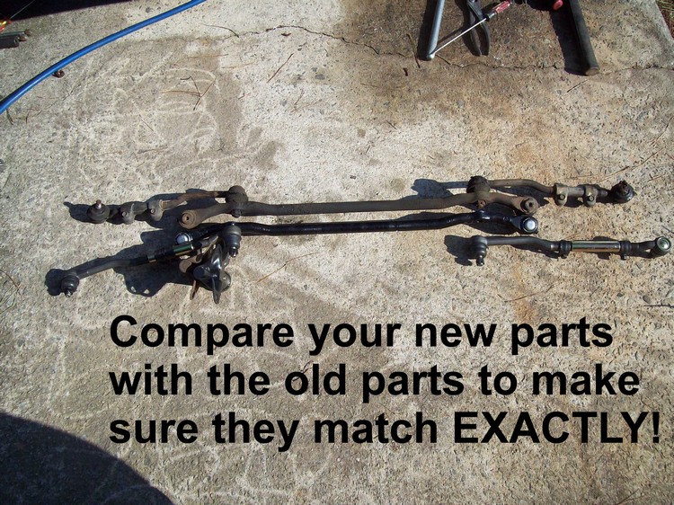

I got great prices on these parts at Rockauto.com.

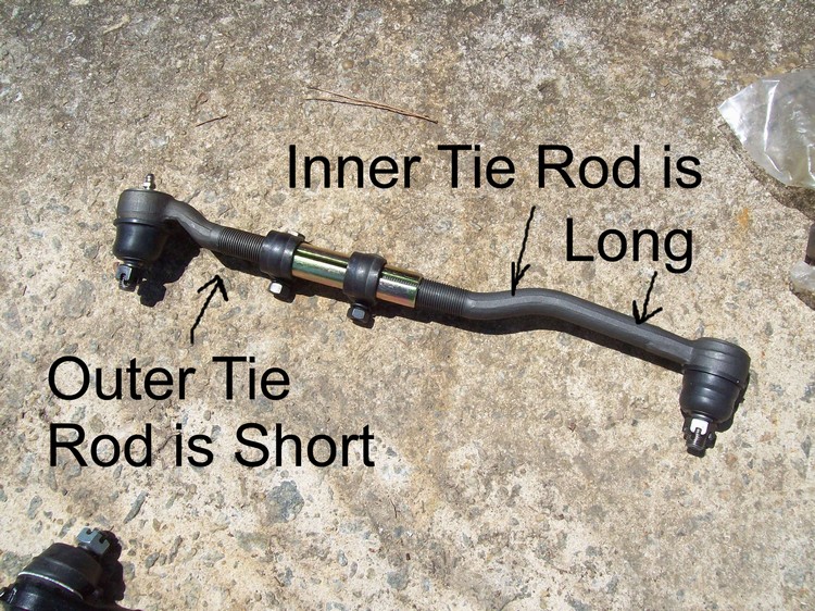

Inner Tie Rods were $11.41 ea (you’ll need 2)
Outer Tie Rods were $10.23 ea (you’ll need 2)
Tie Rod Adjusting Sleeves were $6.80 ea (you’ll need 2)
Center Link was $45.79 (you need 1)
Idler Arm was $27.79 (you need 1)
Total = $130.46 plus shipping

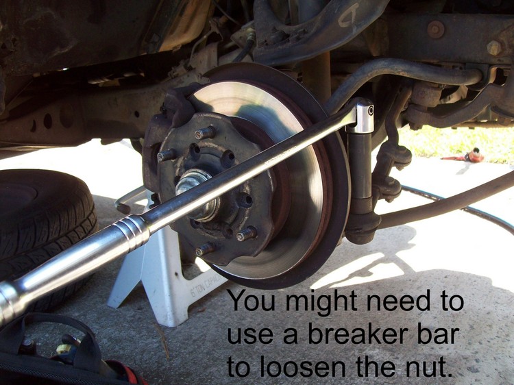

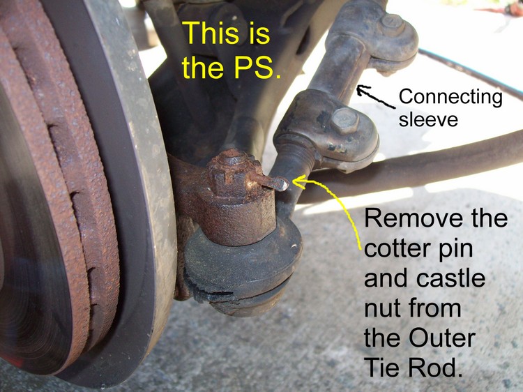

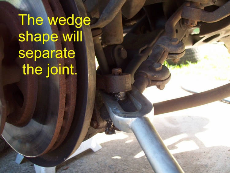

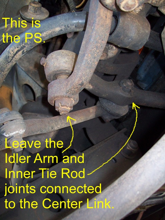

You will disconnect the steering linkage at only 4 places.

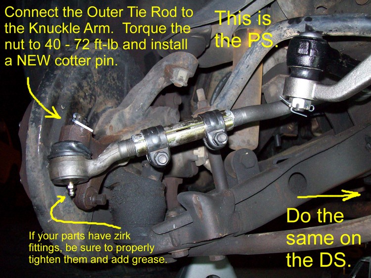

1. The passenger side Outer Tie Rod end from the Knuckle Arm
2. The driver side Outer Tie Rod end from the Knuckle Arm

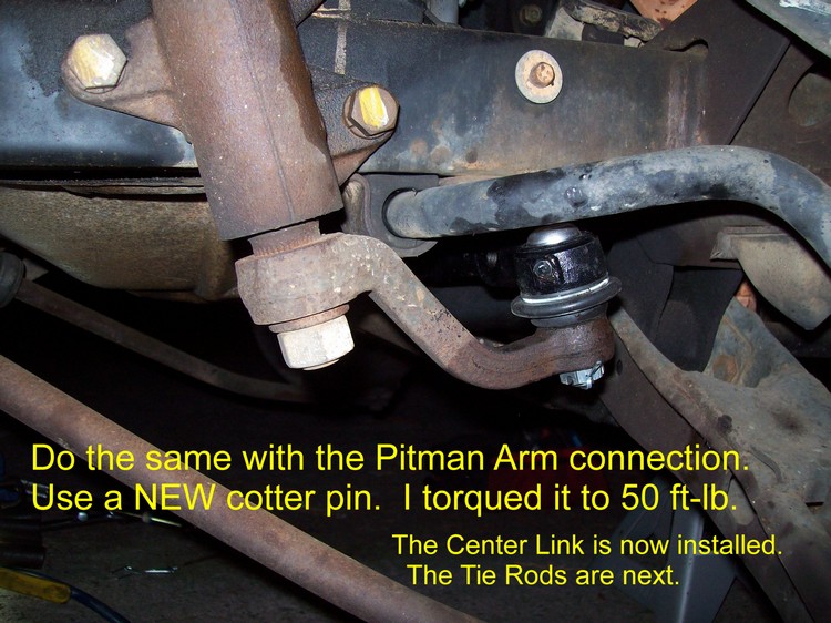

3. The Idler Arm from the Frame

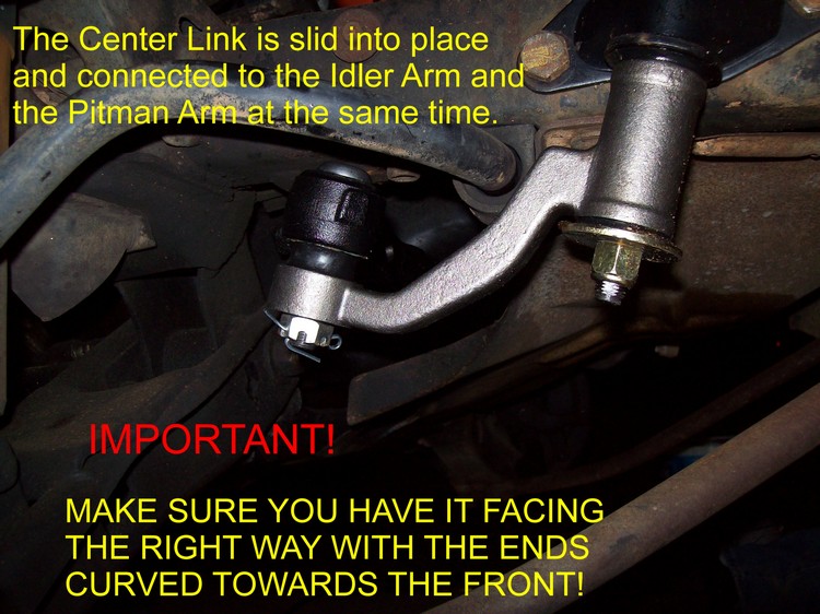

4. The Center Link from the Pitman Arm.

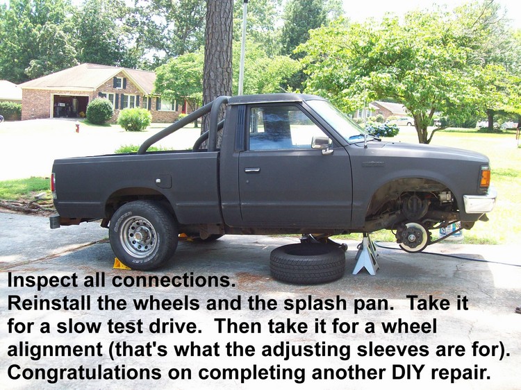

Follow along with the photos, and you’ll be amazed at how tight and precise your steering becomes!
