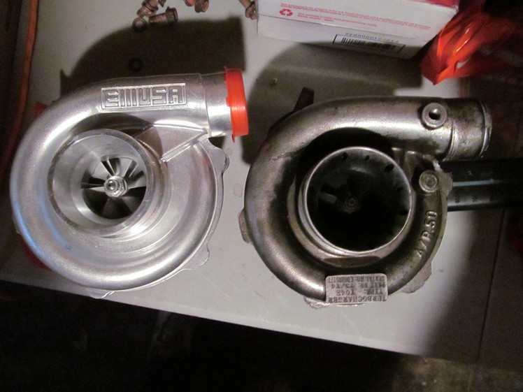

The Speedyracer.com website claims that all their turbos have been high-speed balanced. So that was one of the first things I looked for. If you notice in the following pictures you can see where a part of the turbine was shaved off on both sides, and if you look closely on the compressor side you can see where the top of the lower bolt has been shaved.

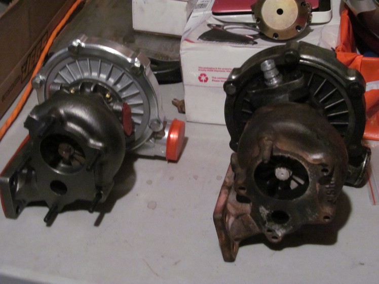

This is supposed to be a sign of high-speed balancing. I also checked the axial and radial shaft play. I found no radial shaft play and very little axial shaft play. Nice and tight. A problem I had with my CXRacing turbo was that the turbine housing was cast rather poorly. If you notice in the picture below you can see signs on the T3 flange of the CXRacing turbo where the bolts actually rubbed against the turbine housing.
This made it impossible to tighten the bolts down flush to my T3 manifold without adding a bunch of washers. On the EMUSA turbo the casting was very well done and the bolts do not need any washers for the them to clear the turbine housing.

I prefer to do a pre-install on all new parts before actual installation. This keeps the install going smoothly. And this is when I noticed a couple problems with the EMUSA package. The first thing I noticed was that the downpipe studs that came with the EMUSA turbo were too long. In the picture below you can see that when the studs were fully threaded into the turbo that there were still threads showing.
Problem, yes, but nothing a little modification couldn’t handle. So I used a grinder and got the studs to the correct length. No threads showing.
