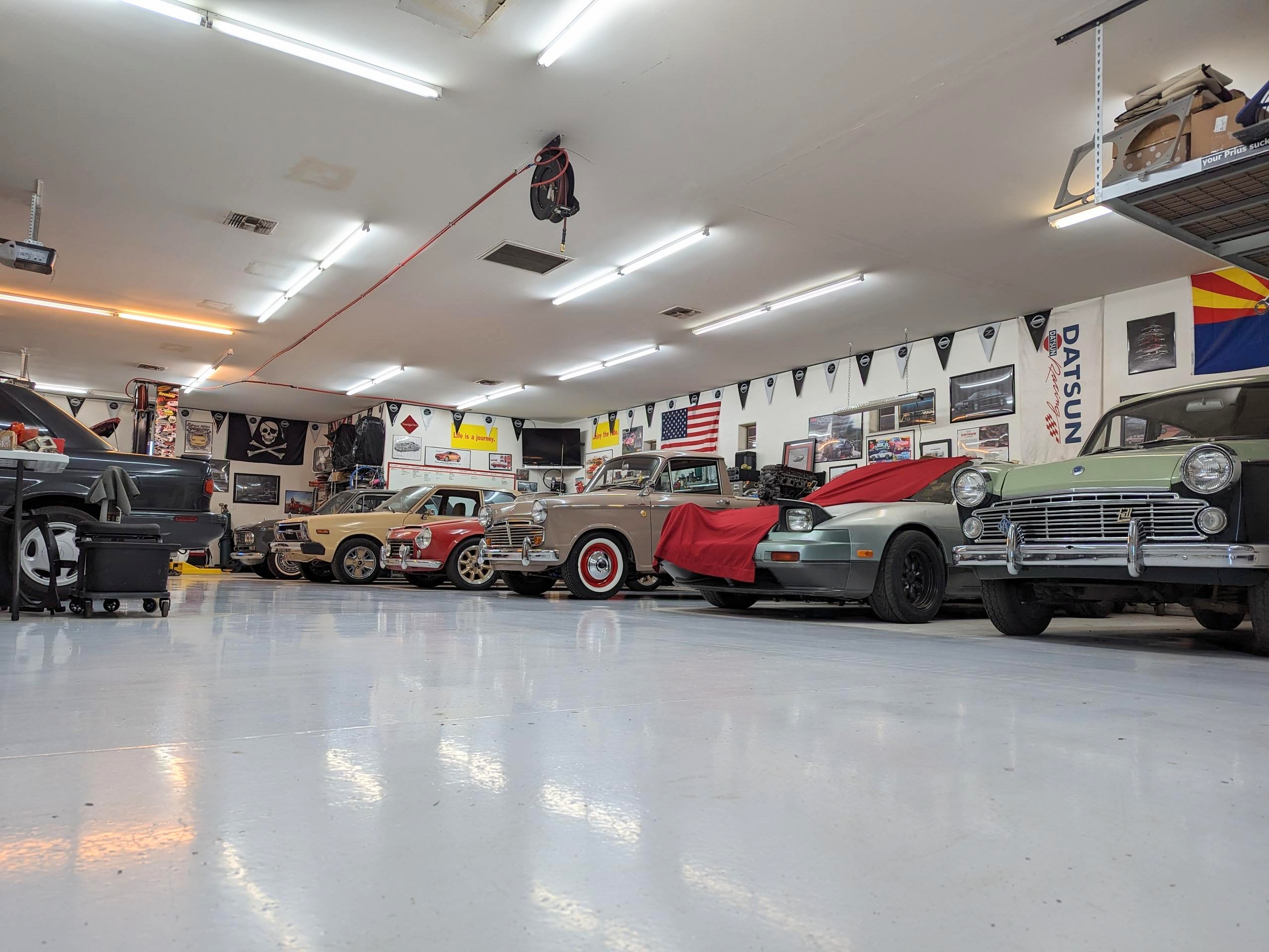

We built Datsun Ranch in 2014, and it was the culmination of a lot of dreams, hard work, planning and 8 months of construction. 2800 square feet, three bay doors, lots of room for the collection and all the associated restoration and maintenance shenanigans… it really is a dream shop, and we love having people over to wrench, borrow the lift, build something for their car, or just hang out.
However – and there’s always a however – we’re in AZ. Not far from Phoenix, to be specific, and we have about 6 months of extremely hot weather – hot enough that you don’t want to be working on a car outside. We keep it about 82* in the shop (cool enough to be comfortable, but not cold enough to get lazy and stiff). Some of you in cold climates have the same issue, so this applies to you as well.

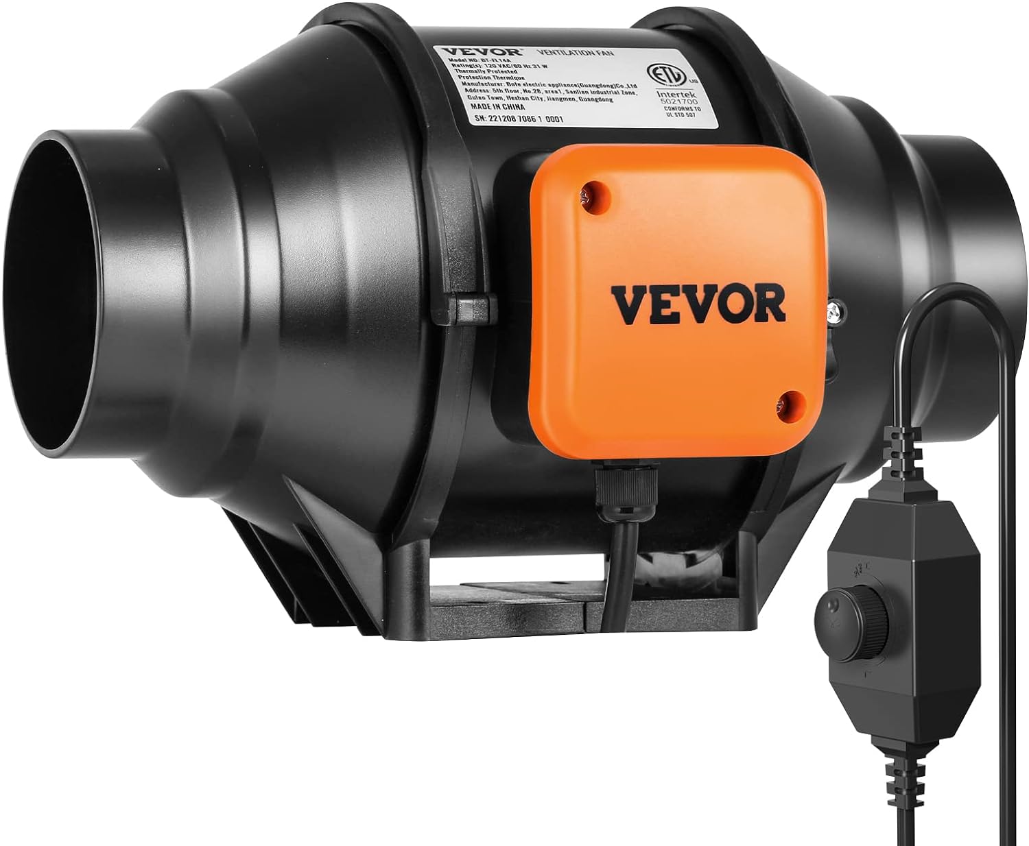

VEVOR 4 Inch Inline Duct Fan HVAC Exhaust Blower Kit AC Variable Speed Control – $54.99

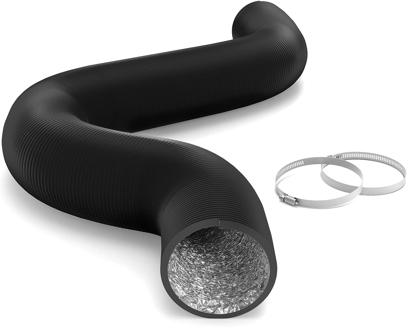

iPower Flexible 4 Inch 25 Feet Aluminum Ducting – $13.99 x 2

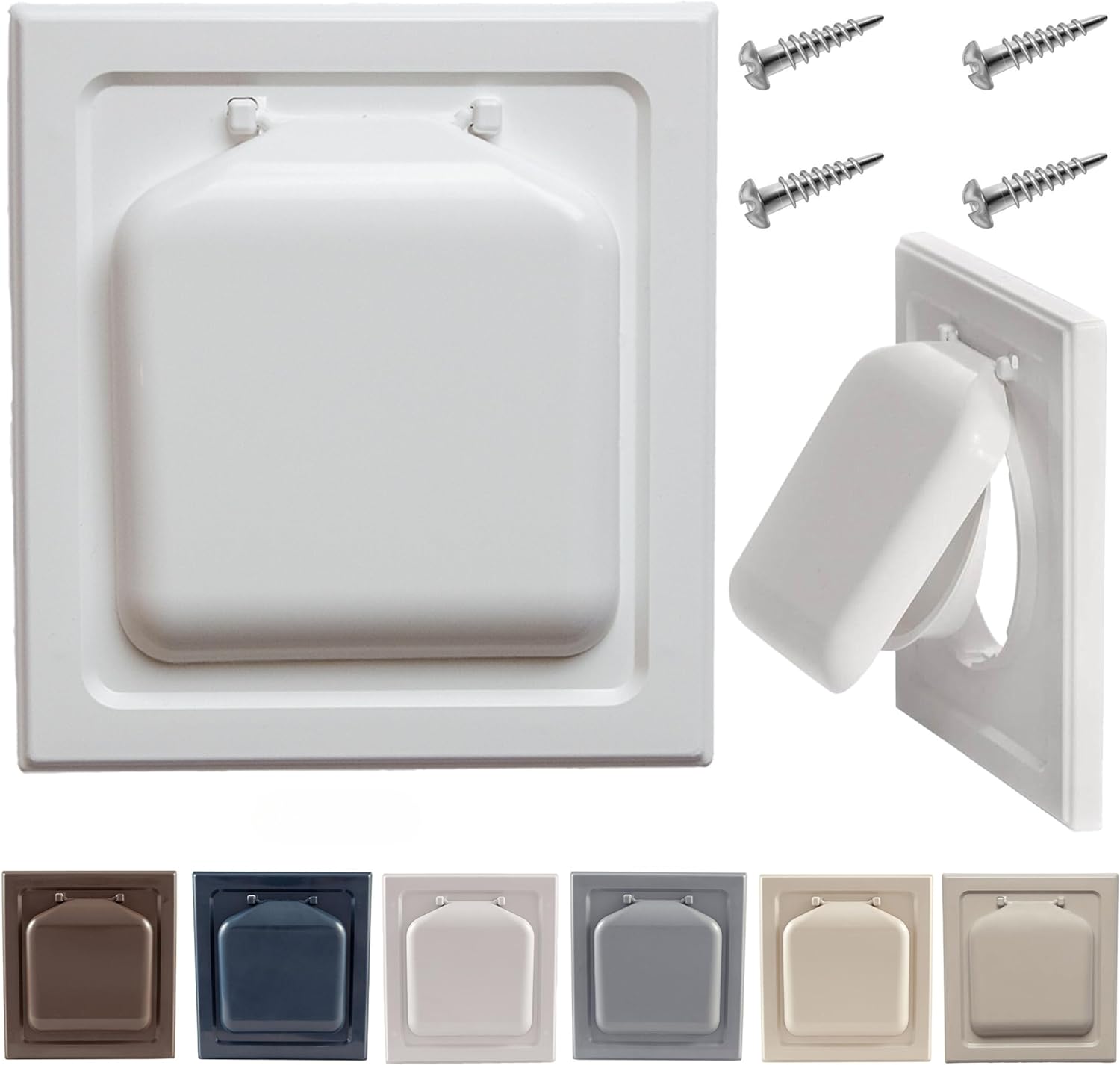

NO-PEST VENT, Dual Door Dryer Vent Cover Outdoor 4 inch – $16.99

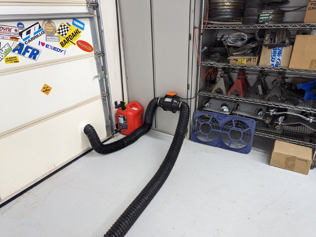

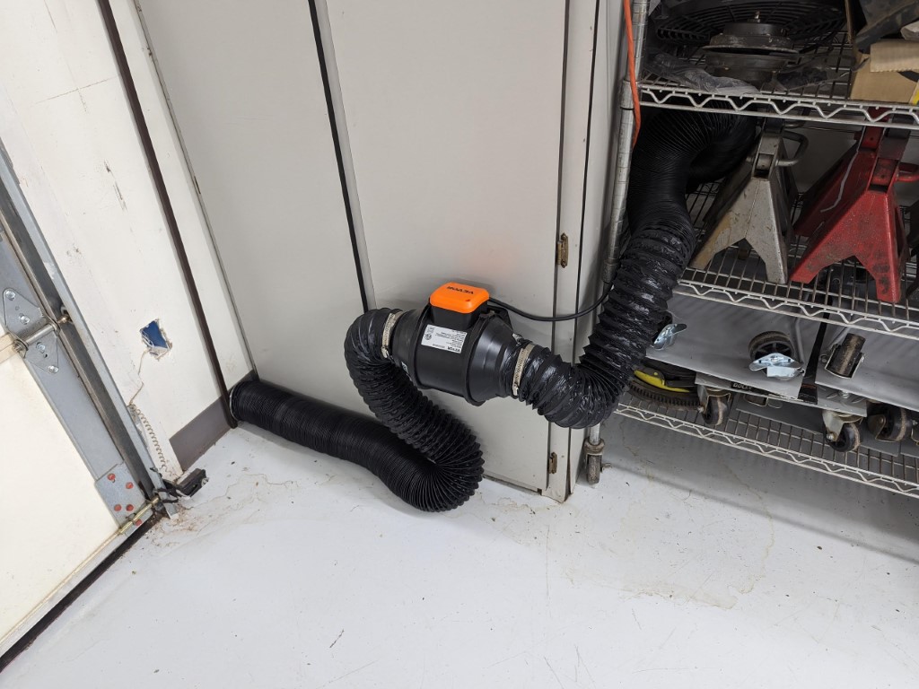

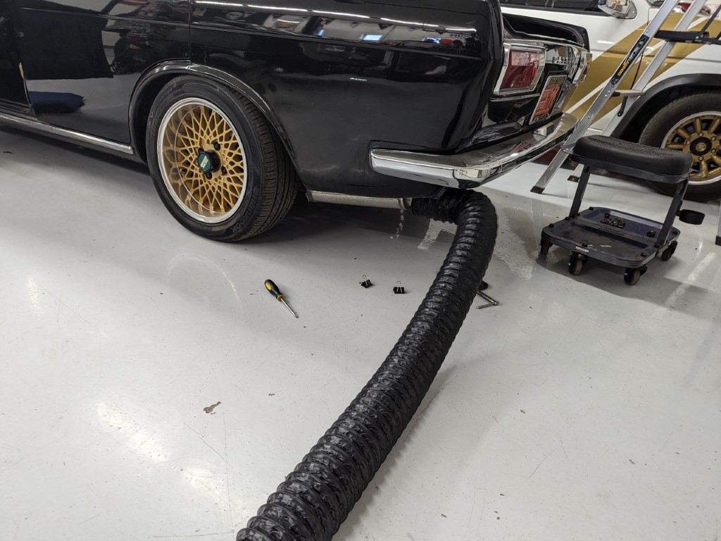

I wanted the unit near the lift, so I vented the extractor through one of the garage doors (rather than cut through drywall and stucco). The outdoor flap swings open about 30* when running, and I was excited to see the old Silvia belching smoke out through the port on initial startup.
The hoses collapse and sit on the shelf when not in use. Since the shop is always evolving, and stuff gets moved around a lot, I’ll rig up some hooks and maybe even add a second unit on the other end of the shop later. You also may want an assortment of spring-loaded metal clips to secure the hose. I used a pair of binder clips to keep the hose from slipping off past the rear valance.

And here’s the completed project.
So far, we’ve tuned a set of SU carbs on the CSP311 using this setup, and most recently, used it to chase a TPS issue on the 510. Works like a charm, and the venturi effect created by the fan keeps the hose from getting too hot from the exhaust. Shop temperature stays at 80*, no air-conditioning the neighborhood, and everyone’s happy.
