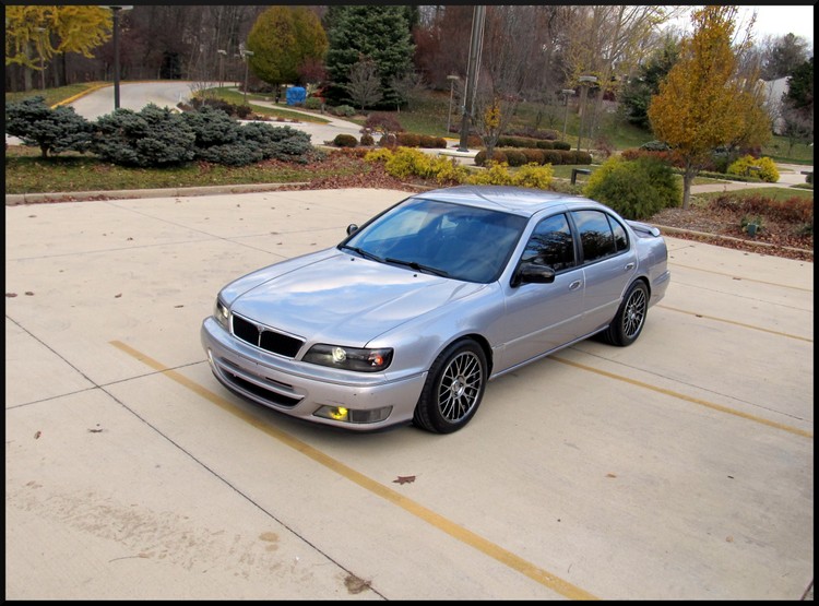

My name is Nick (95maxrider on the forums) and this is the story of my 1996 Infiniti I30. I bought the car in my senior year of high school in 2003 as a replacement for my automatic 1995 Maxima. The I30 was a base car with no sunroof or Touring package, but it had the manual transmission that I desired, and I liked the gray leather interior. Since then, it’s had a few suspension and stereo setups, but it wasn’t until I got a “real” job that I was able to do the things that I had always wanted, but didn’t have the money. A smarter man might have sold this old thing and gotten a proper car (E36 M3 or S2000 comes to mind), but I wanted to finish what I started. I wanted to make the best A32 I could, and more than a decade later I think I’m pretty much there.
I30_3

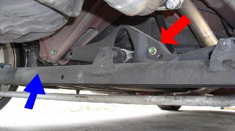

A new shop in Georgia called 2J Racing came up with a nice mod for the B15 Sentras that just happened to work on the A32. They decided it would be cool to convert the rear suspension from a Scott-Russell Linkage to a panhard rod, thus lowering the rear roll center to be much closer to that of the front. I was the second A32 to get this done (out of 3 that I’m aware of), and I was still on Konis/Eibachs back then, so the panhard made a huge difference. The car already had a Progress RSB, but this helped keep the rear of the car from rolling even more, and really helped keep the car flat, with no penalty in ride comfort. Unfortunately, it uses metal rod ends and they make a fair amount of clunking noise, so it’s best to keep them greased up.
Here’s a before and after pic, so you can see the different rear suspension setups.
SR_linkage
panhard_rod

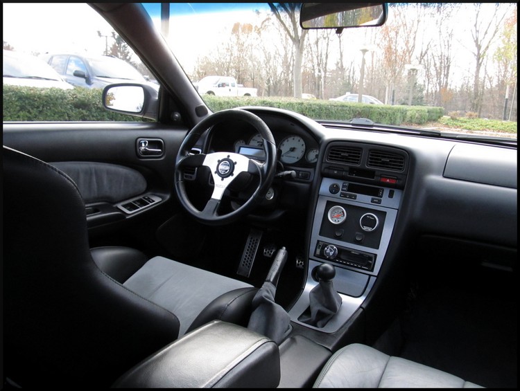

One of the first things I did to my car when I bought it was to have Stage 1 and 2 Warpspeed subframe connectors welded onto the frame. They really improved the ride quality and made the car feel a lot more solid going over imperfections in the road. It was with this in mind that I had a set of fender braces made. After those were welded on, the front of the car felt even better going over rough spots, and I was very happy I had them.
interior

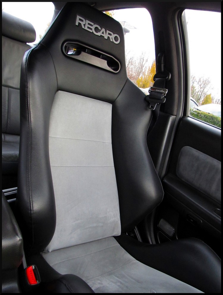

I have always been into music, and having a nice stereo has always been important to me. The car has been through a few setups now, and I’m finally completely satisfied with my stereo. One thing that really allowed me to choose the proper speakers (for the front doors) was the custom made speaker adapters my good friend Patrick made for me. They are 3/4” PVC material cut to fit my speakers, and they space the speaker far enough out from the door to ensure the windows can roll all the way down. I tried the cheap plastic ones you can buy on Ebay, but the cutouts weren’t big enough for my speakers, and they were just really cheap and flimsy. After seeing how helpful his adapters can be, I decided to join him in making them. Patrick makes them for any Subaru (check out www.SubaruAudio.net), and I am now making them for pretty much any Nissan with 6.5” speakers. I can make them in either 1/2” or 3/4” PVC, with any speaker cutout size you choose. Send me a PM or email me at [email protected] if you would like to know more!
seats

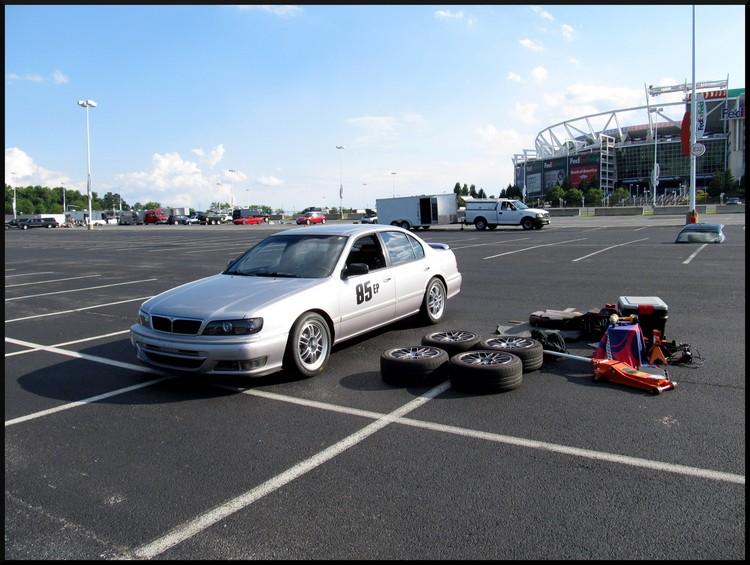

As I got more into auto-x, I wanted to try racing with the big boys at SCCA. Unfortunately, due to their somewhat nonsensical rules, my subframe connectors put me in the Prepared class with full-on race cars, instead of Street Prepared where I might have had a chance of being competitive. So, I decided to go full crazy and got a set of Hoosier A6s. Good god are these things fun! They allow the car to do things I never thought it could, and when combined with the big parking lot the SCCA uses, I was suddenly going much faster than in previous years on street tires and in smaller parking lots, hitting almost 70 mph in fast sections.
track_3
track_2
