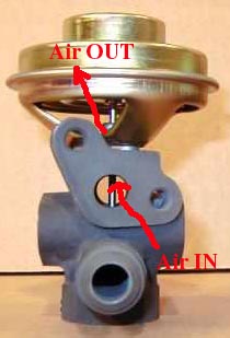

Now just listen for leaks. In places where it’s hard to reach with your ear, use your finger – works even better with a wet finger! I heard a leak around the EGR somewhere. You probably know how tight it is down there. When I’ve put my wet finger under the EGR membrane, I could feel where the air was escaping from.
It was the EGR valve which was NEW! I think that the EGR valve design is to blame so don’t get alarmed by this. I’ve heard of several people with
this problem. The air is escaping around the rod that goes down from the membrane. The seal around the rod is not enough to keep the air
from escaping. The hole is small though so it’s nothing compared to what the engine is consuming at boost.
At higher boost levels you will hear a hissing sound from there though… I blocked the EGR system off, but I’m not recommending this to anyone.
