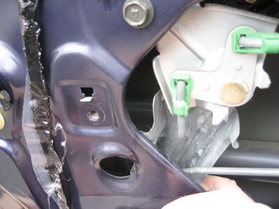

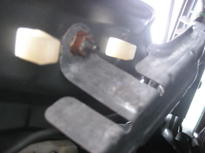

I started by removing the bolt on the side of the door by the seal which releases some long metal piece that I think is for tracking the window down correctly. With the bolt out, the long metal piece could be pulled out. Next, I took out two bolts that hold a metal guard which sits around some of the connecting rods. Next, I unhooked the two connecting rods from the this part that moves back and forth when the door locks and unlocks. They’re held in place by green plastic hooks that snap on and off.

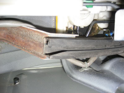

Following that, I took out one bolt that holds the bottom, right part of the latch to the door frame.

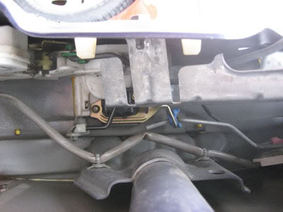

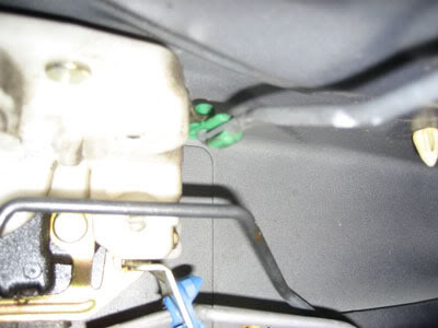

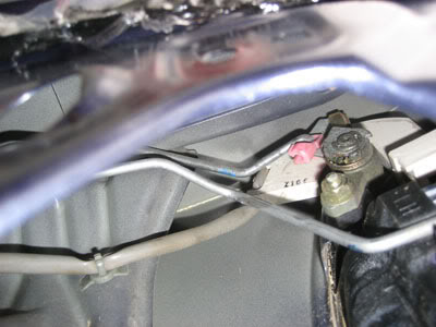

Next, you have to disconnect the rod that goes from the outside lock to the latch (near the top, red connector), and another rod that connects the interior door handle to the latch (green connector). Both are kinda hard to reach, but all you have to do is get the plastic hook off the rod and the rod comes free.
With all the rods free, the latch is free to come out. Unscrew the three screws on the side of the door, and pull the latch out.

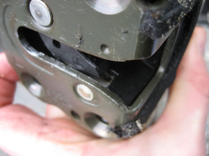

With the latch out, I saw why the outside handle couldn’t open the door, but the inside handle still could. There’s a little white piece in the latch that moves up when a handle is pulled. The indoor handle moves that piece more than the outdoor handle does, and it was just enough apparently for it to open my door. I sprayed some more PB Blaster on all the moving parts and just worked the latch (pushing down on the part that simulates opening the door) over and over. I pushed the lock in and out a few times, too. At some point, the white piece started moving up a lot more than it was and I knew that was going to be enough to open the door. So I didn’t really fix my door latch – it was fine, just needed some lube. But taking it out was necessary to get it working right.
Once it was working, slide the latch back in making sure the rod that connects to the outside door handle goes into the blue holder on the latch. Put in the screws on the side of the door, and rehook up the outside door lock connecting rod and the indoor handle connecting rod (green and red). Put the rotating, boomerang shaped piece back in and hook up those two connecting rods. At this point, check to make sure both indoor and outdoor locks and handles are working the latch correctly. (You can hook up the panel with all the switches to the power cable without having the door panel on.) Once the locks and handles are working, put the metal guard and the long metal window guide back in and tighten everything up. Panel back on and you’re finished.
