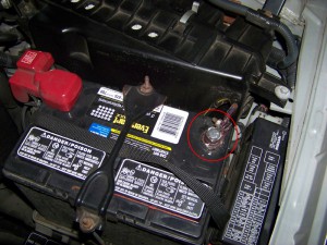

First of all, you want to disconnect your negative battery cable(just for safety reasons):
Disconnect Battery Nissan Maxima/Infinti I30

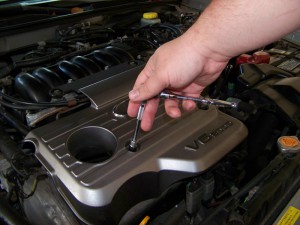

Next you will locate the four nuts on the plastic engine cover and remove them, which are highlighted in red:
Engine Cover Removal Nissan Maxima/Infiniti I30
Engine Cover Bolt Removal Nissan Maxima/Infiniti I30

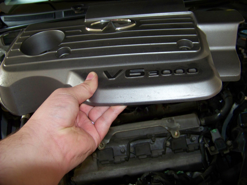

Now you will remove the engine cover and set it aside:
Lifting Engine Cover Nissan Maxima/Infiniti I30

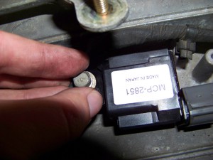

First you will remove the bolt from the coil pack:
Ignition Coil Removal Nissan Maxima/Infiniti I30

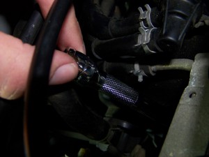

Then remove the connector if necessary by pressing down the green clip until the connector releases. You may have to press it down with a small screwdriver, since it was a bit difficult to do with my fingers. Ignore the screwdriver position in the photo, it was not needed:
Disconnecting Ignition Coil Plug Nissan Maxima/Infiniti I30

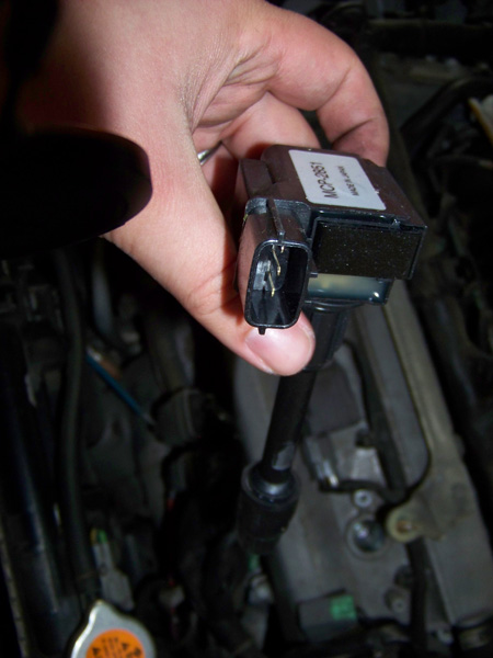

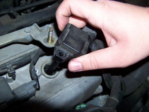

Next you will gently lift up on the coil pack until it comes off of the spark plug and pull it out of the cylinder head.
Removing Ignition Coil from engine Nissan Maxima/Infiniti I30
Ignition Coil Removed Nissan Maxima/Infiniti I30

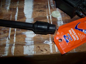

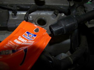

Now you will need to re-install the coil pack. First re-connect the connector, pressing it until you hear it click. Also before re-installing the coil pack, make sure to put spark plug boot grease on the end of the boot. Then put the coil pack back into the cylinder head and press it down until you feel it slip over the spark plug:
New Ignition Coil Nissan Maxima/Infiniti I30
Connecting new Ignition Coil Nissan Maxima/Infiniti I30
Applying Di-electric Grease to Ignition Coil Nissan Maxima/Infiniti I30

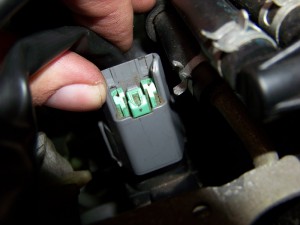

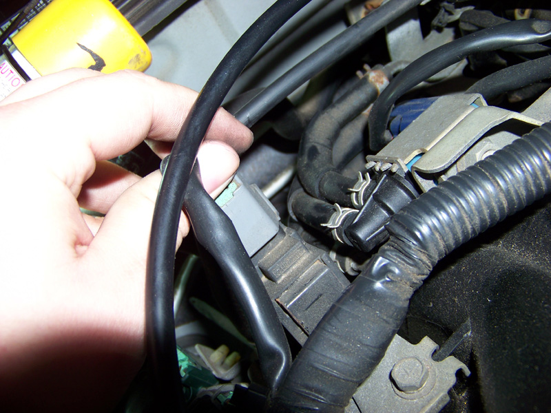

Next you will remove each bolt securing the coil pack, then remove the connector by pressing in the green clip until the connector pops off:
Removing Ignition Coil from rear of engine Nissan Maxima/Infiniti I30
Disconnecting Rear Ignition Coil Plug Nissan Maxima/Infiniti I30

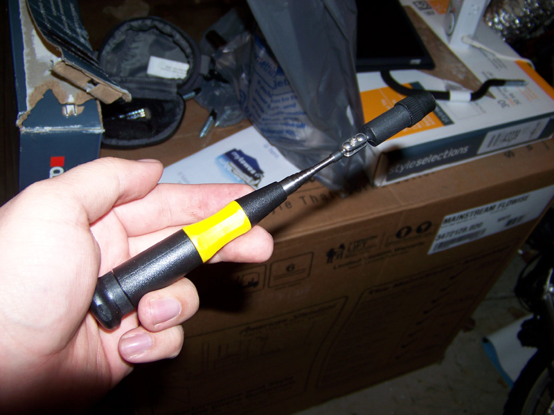

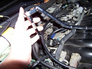

*NOTE: If you manage to drop any of the coil pack bolts in this process, you may want to make sure to have one of these around. It’s an extendable, flex magnet which you can pick up at any Auto Parts store, like Advance Auto Parts or Home Improvement store, like Lowes:
Extendable Magnet Nissan Maxima/Infiniti I30

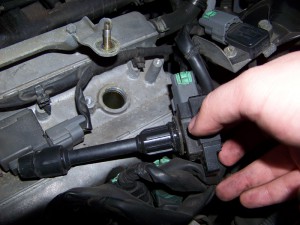

Now you will gently lift the coil pack straight up, working it out of the cylinder head:
Removing Spark Plug from rear cylinder head Nissan Maxima/Infiniti I30

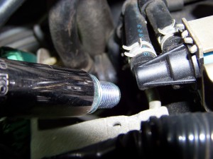

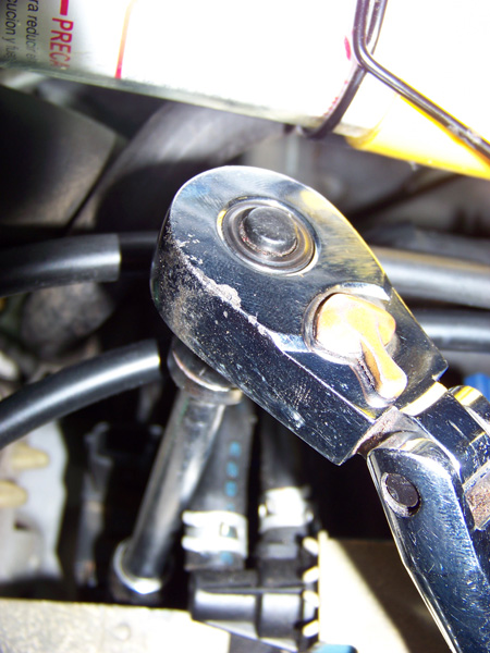

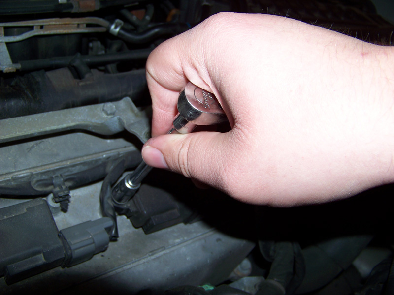

Next you will remove the spark plug, using your 10″ extension and 5/8″ spark plug socket(You may have to add a short extension on the other plugs to make removal easier):
Using long extension to remove rear spark plug Nissan Maxima/Infiniti I30

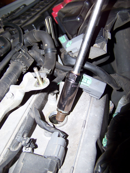

Once you get the spark plug loosened, remove the ratchet from the extension and spin the extension with your fingers to remove the plug:
Loosening rear Spark Plug Nissan Maxima/Infiniti I30

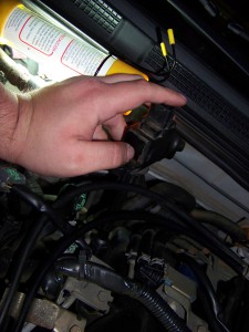

Next, you will replace your coil pack. Remember to put grease on the end of the coil pack before replacing:
Using Di-electric grease on rear Ignition Coil Nissan Maxima/Infiniti I30
Replacing rear Ignition Coil Nissan Maxima/Infiniti I30

Now you will repeat this process for the other two. Keep in mind you need to be careful when lifting out the coil packs and plugs, in case you have to move any hoses or cables out of the way that may be blocking things.

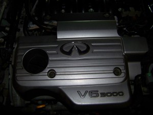

Once you’re done replacing all of the plugs, you will need to check and make sure everything is secure, then you’ll replace your engine cover:
Replacing Engine Cover Nissan Maxima/Infiniti I30
