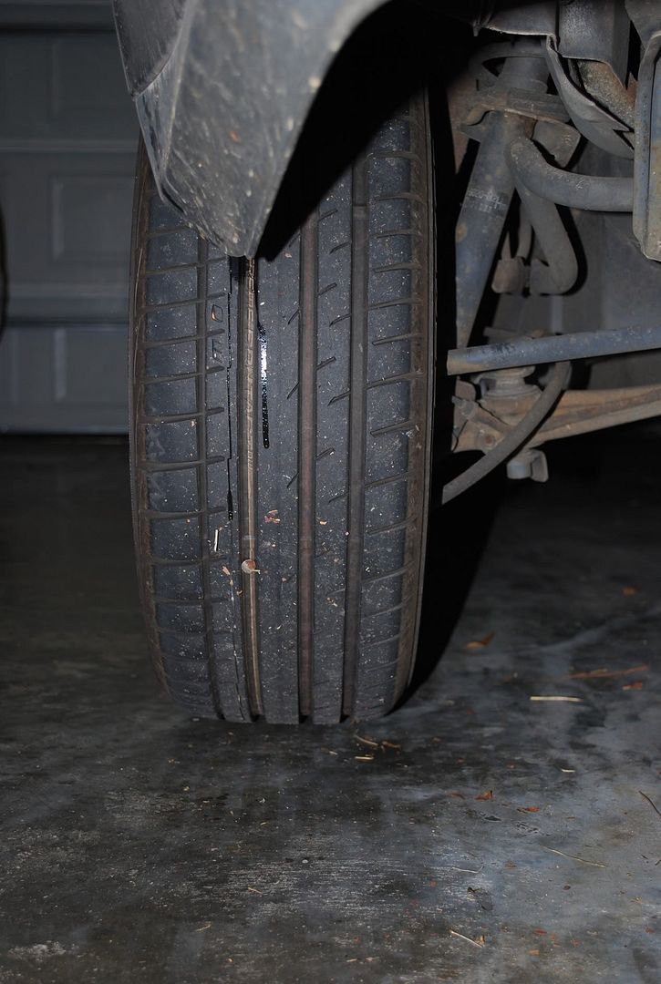

Inspect the visible area of the bad tire. If you’re lucky (which you probably aren’t, because after all… you just got a fuggin flat tire) the foreign object will be visible and you won’t even have to jack the car up. In the above picture I sprayed some soapy water on a suspect object to check for a slow leak, but it turned out it wasn’t the culprit… so up goes the wheel/tire.

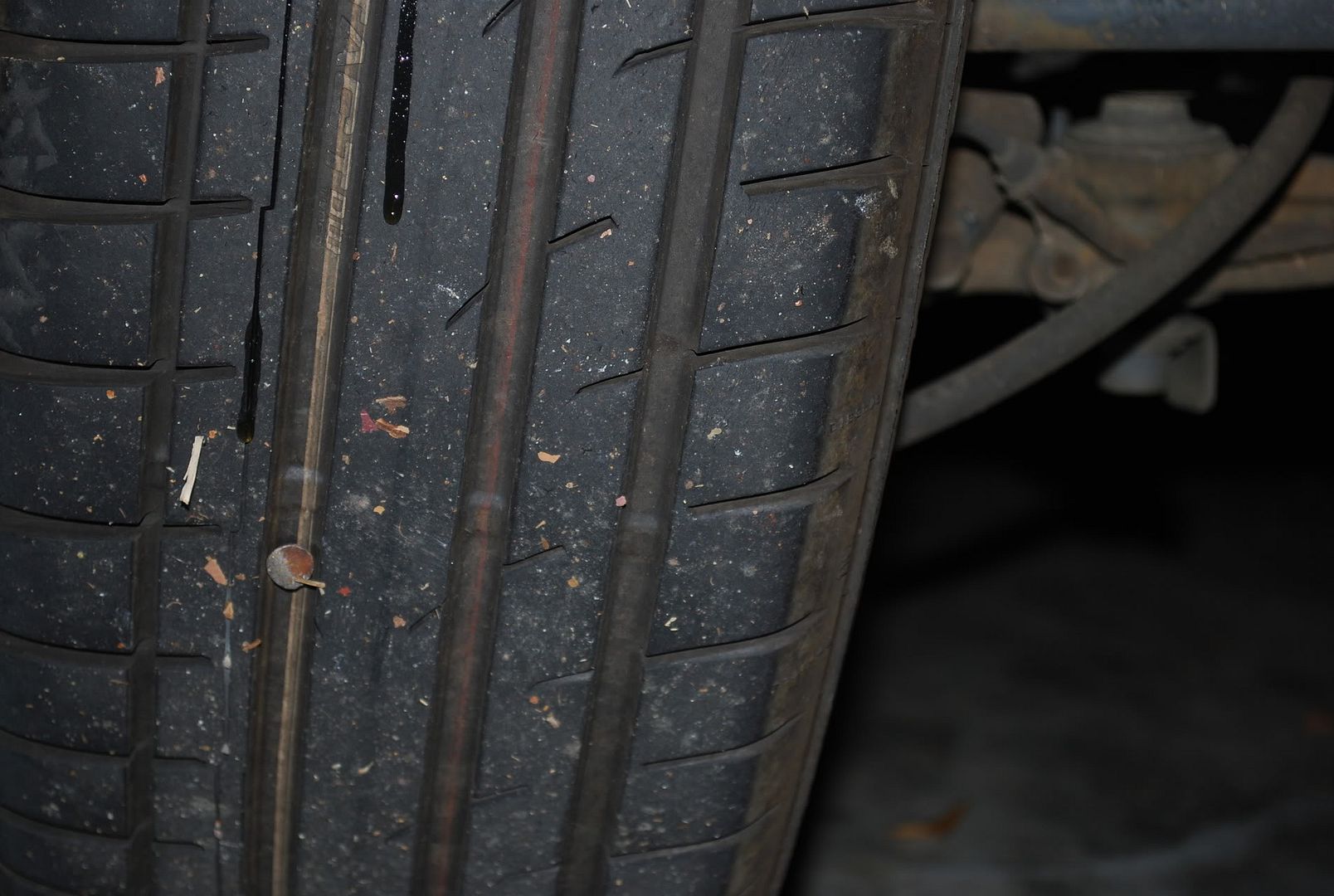

Zoom in (real dimensions: 1266 x 1886)Image
‘yarrrr…. thar she blows. Get it in a good location and put the E-brake back on or put the vehicle in park/gear so it doesn’t rotate around on you while you man-handle it.

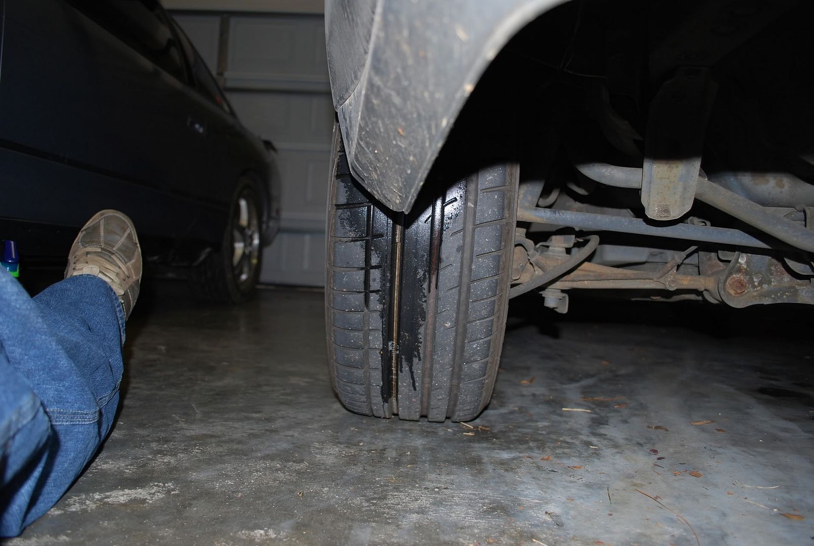

Zoom in (real dimensions: 1906 x 1280)Image
Get a trusty set of pliers out and pull the culprit out of your tire. Discard it, burn it, piss on the ashes, but make sure you don’t just drop it on the floor and run it back over after you’ve finished the repair.
