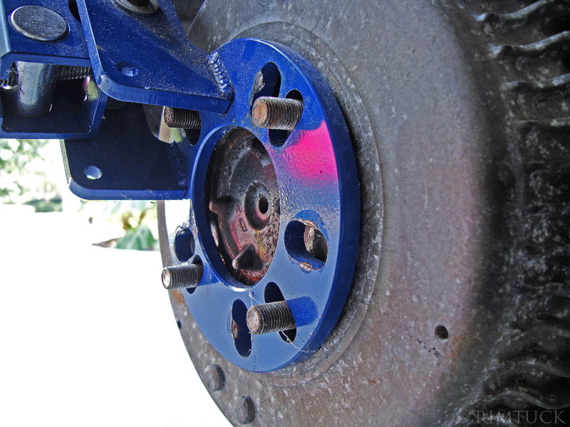

Mounting the fender roller tool:
fender roll

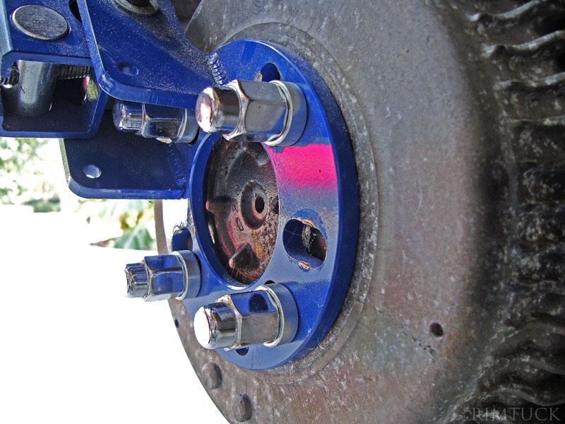

Adding the lug nut washers:
rolling fenders
Lug nuts on, and slightly tightened:
rolling fenders

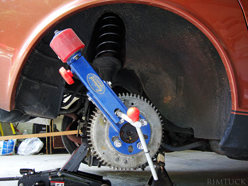

What the tool looks like fully mounted:
rolling fenders
Since I’m working on the rear, the e-brakes will need to be released.

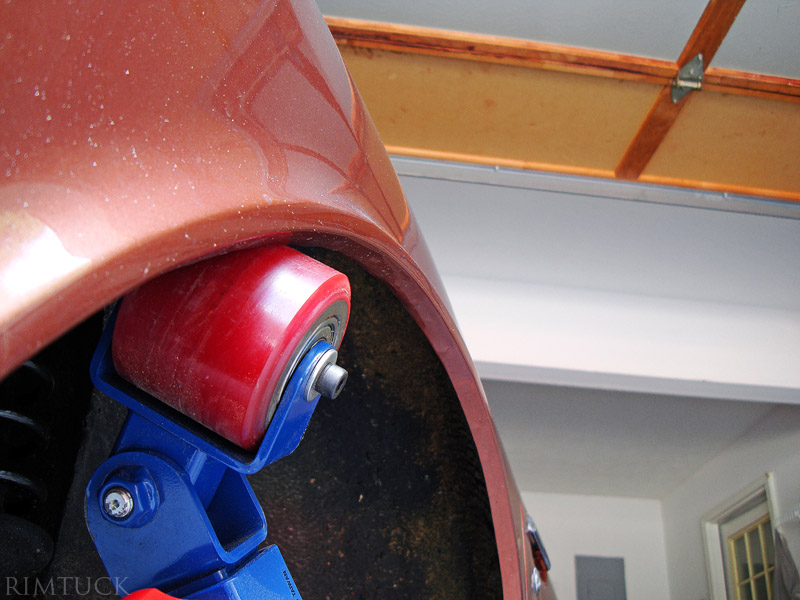

Tool is positioned with slight pressure on the panel lips.
Red knob tightened to lock the tool length in place.
Head roller angle is also tightened and locked into place:
fender roller
With slight pressure already on the panel lip, rotate the tool left and right several times. Lip starts to slightly curl:
fender roller
Use the lever to add more pressure on to the panel lip, and rotate the tool left and right several times again. Repeat this step until the panel lip is folded enough to clear the tire:

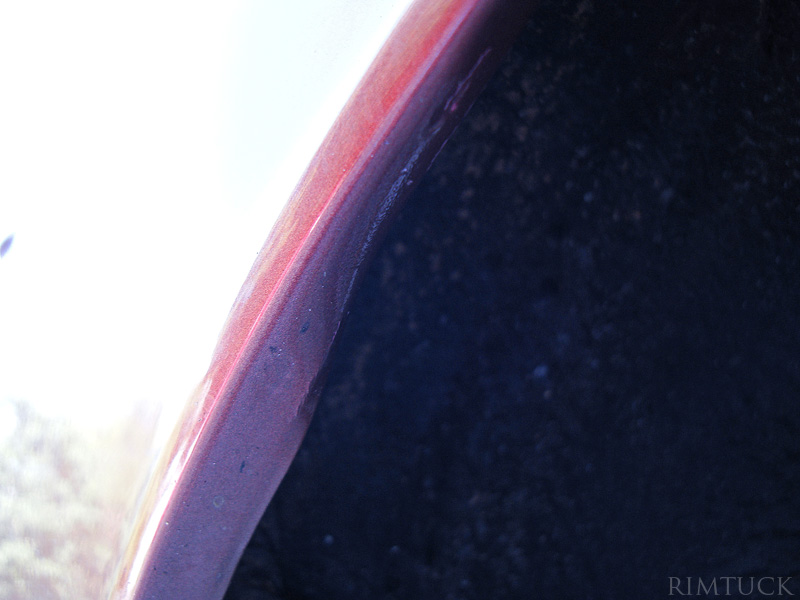

Some paint cracking on the inside depending how much the lip is folded.
Paint cracking maybe reduced, but not entirely avoided, if a heat gun was used prior to rolling.
The cracking paint was on the inside of the panel, which wasn’t important to me and will just need some paint touchup:

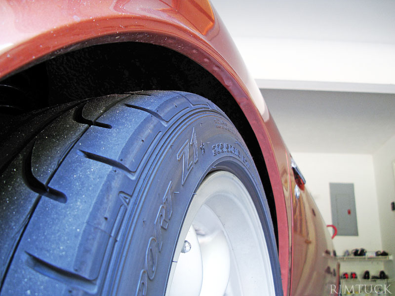

Fender rolling completed:
(The dimple shown is a factory spot weld, but is not visible on the outside)
how to roll fenders
Finished:
how to roll fenders
