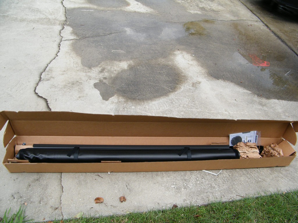

Open Box:
truxedo_truxsport_tonneau_cover_02

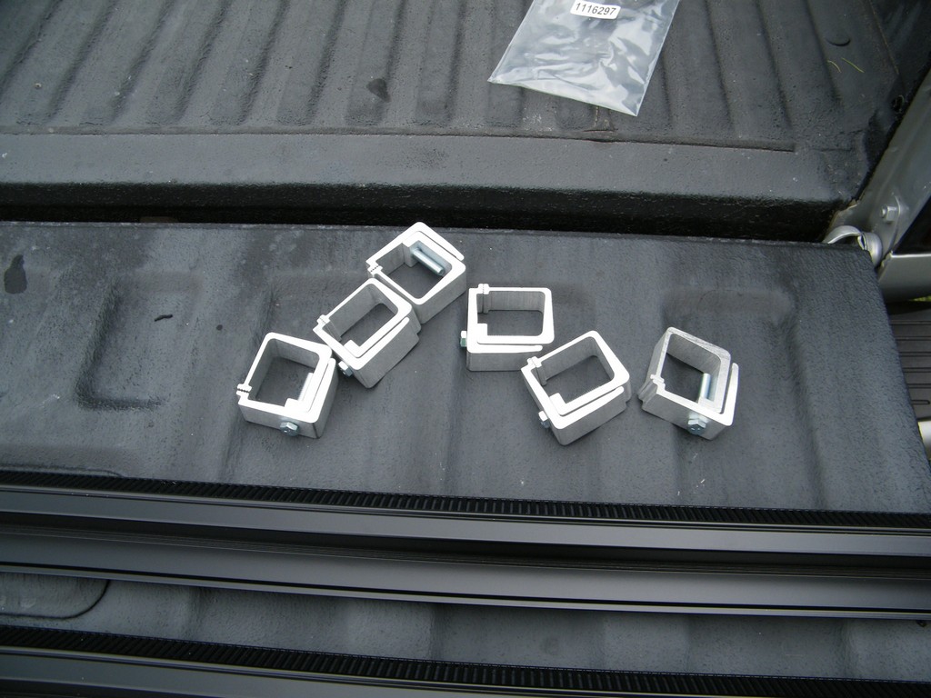

Clamps that hold the rails down:

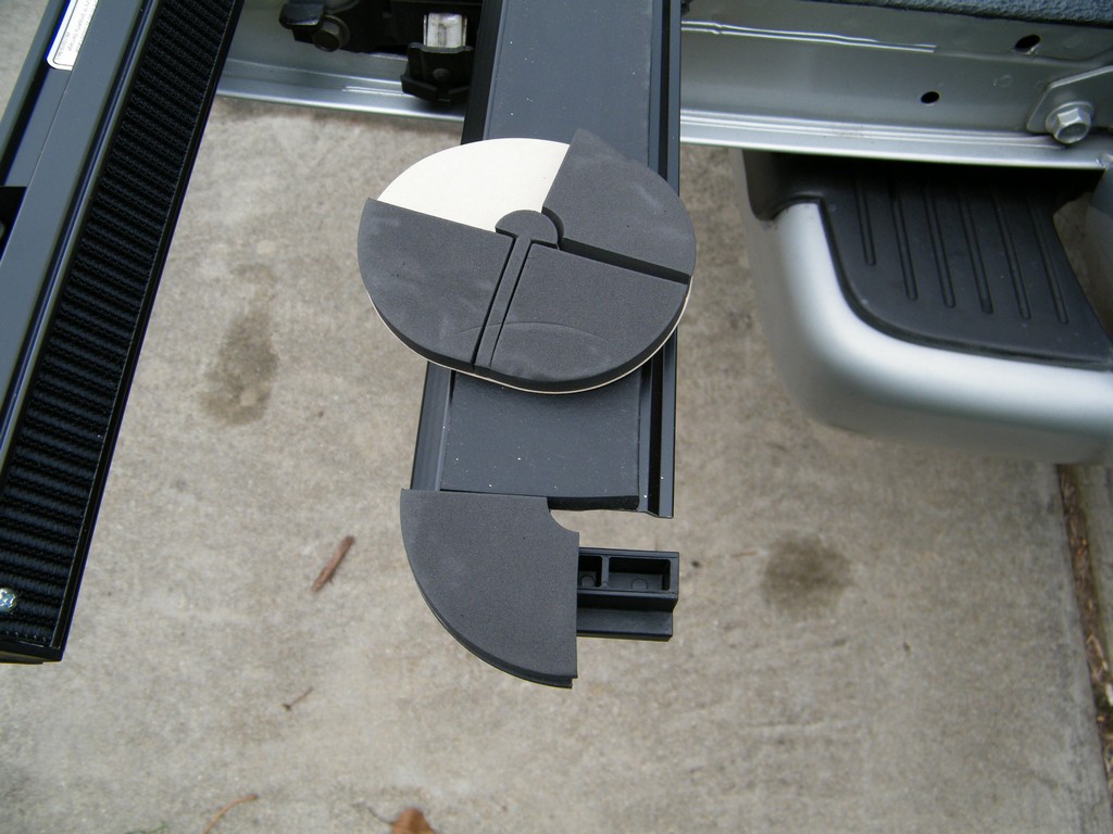

The corners of the side rails come without the foam backing pre-installed. So you have to stick the foam corners on to the rails.

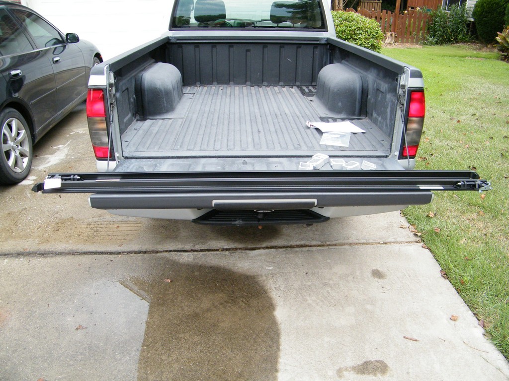

Here’s the cover sitting in place on the back of the bed.

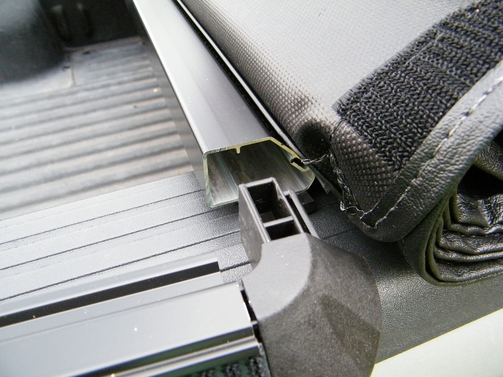

Now insert the side rails in to the front cross member:
truxedo_truxsport_tonneau_cover_08

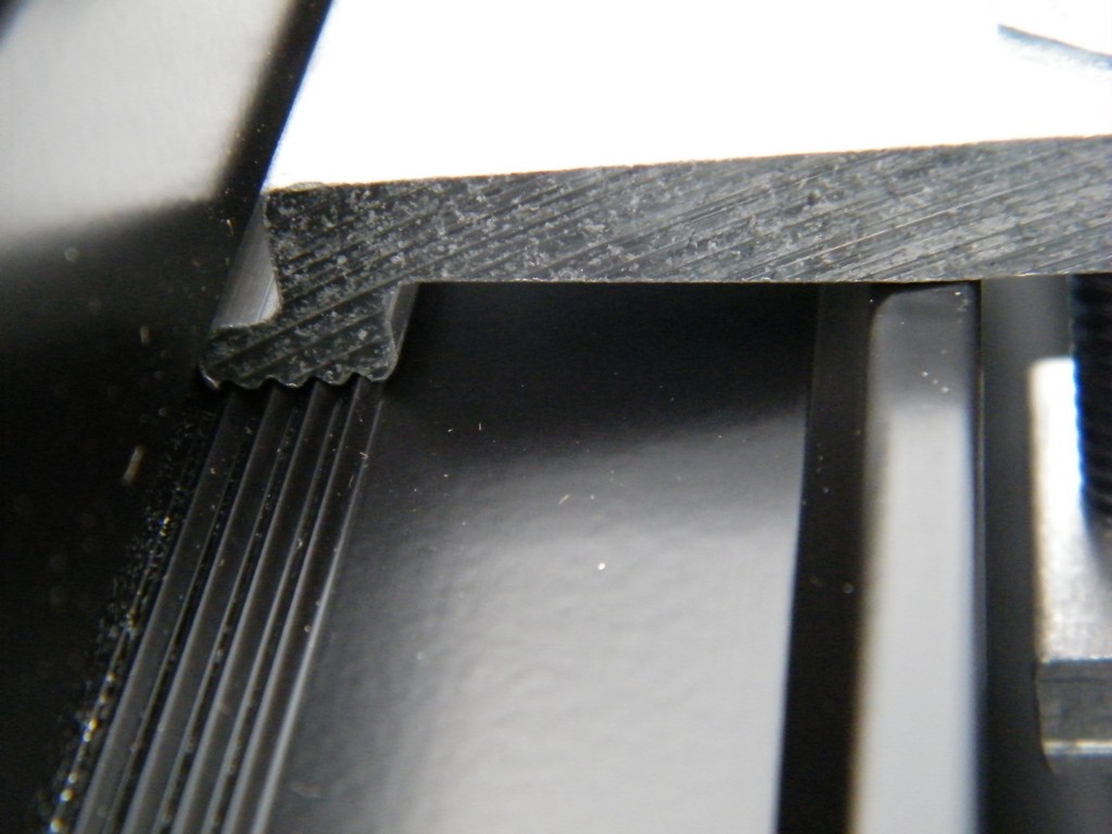

The clamps and rails have teeth that help them grip well:
truxedo_truxsport_tonneau_cover_09
Space the clamps evenly along each side and tighten them down in order from back to front. According to the instructions you should tighten both rears first, then the middle ones, and finally the fronts.

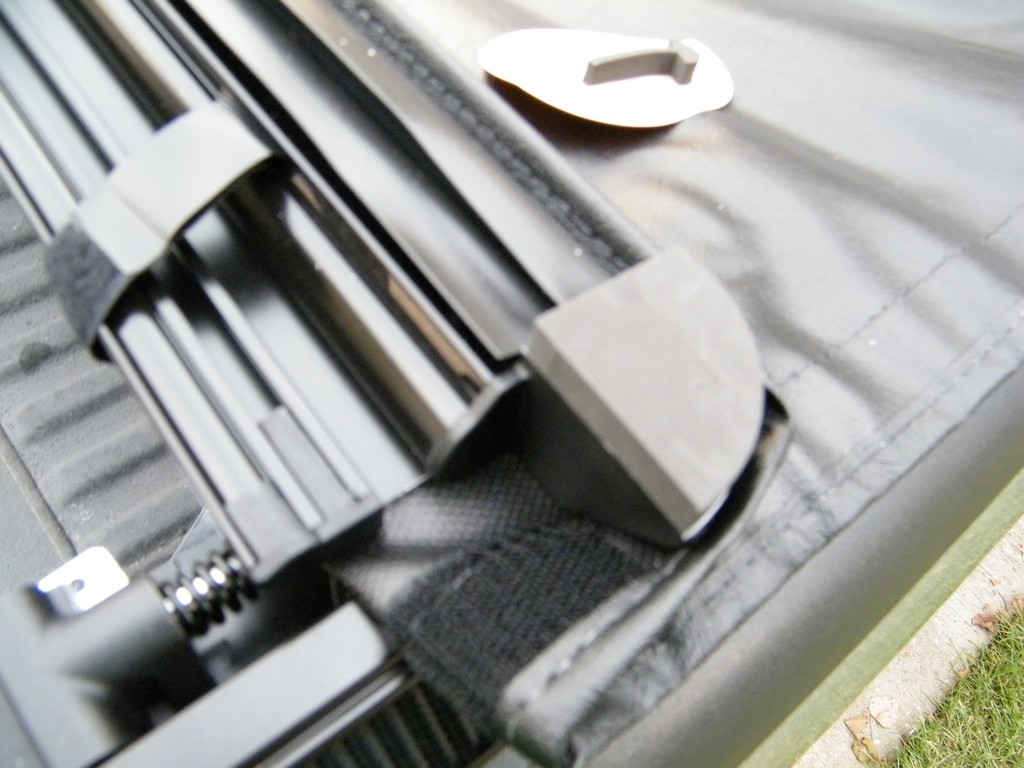

Now it’s time to put foam backers on back the corners of the cover:
truxedo_truxsport_tonneau_cover_10

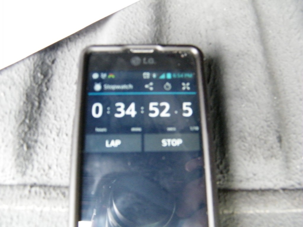

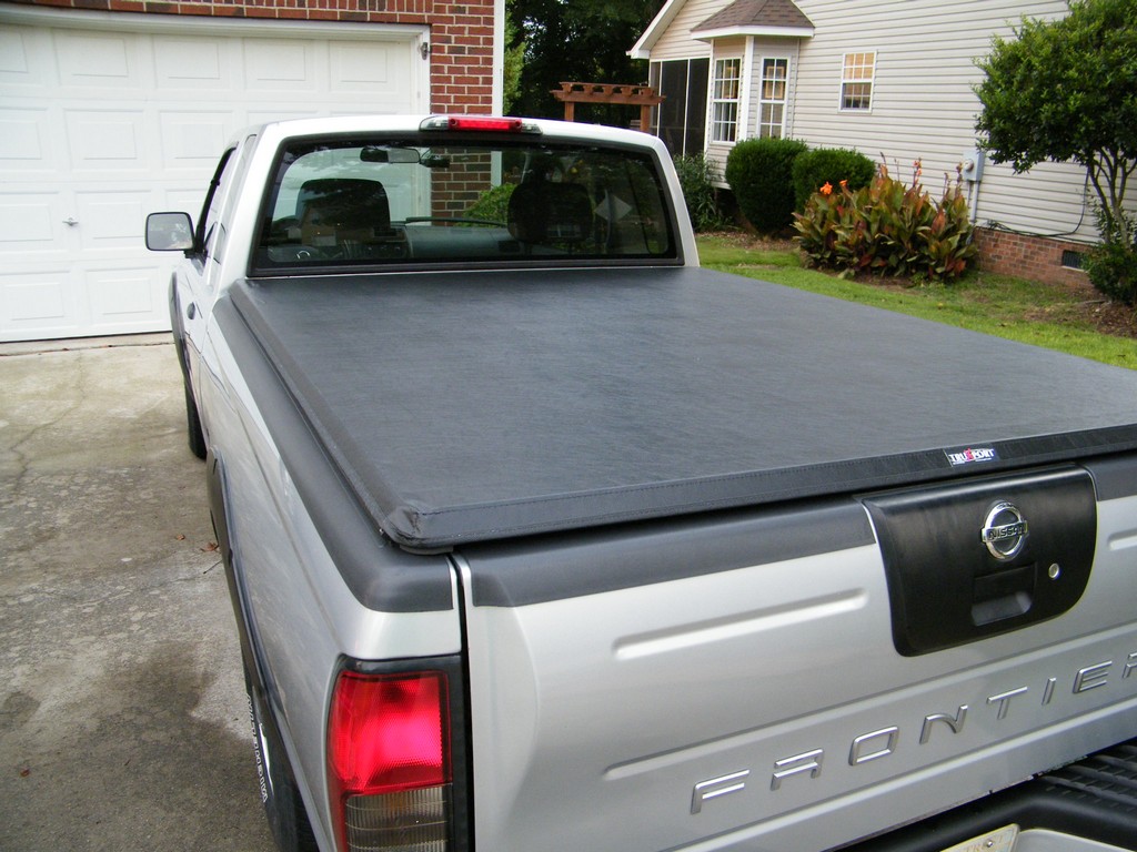

Total installation time box open to done was about 35 minutes. This includes one round of loosening the clamps and sliding the whole cover forward a couple of inches. I put it too close to the cab the first time.
truxedo_truxsport_tonneau_cover_11

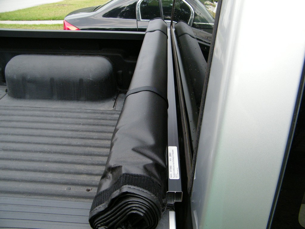

My only other concern was that the cover would be a pain to open and close. No worries there either. It takes me about 45 seconds to open the cover, roll it up, and strap it in place with the velcro straps that keep it secure… and the same to go from open to closed.
With the Frontier’s locking tailgate, this is a pretty secure truck bed now!
truxedo_truxsport_tonneau_cover_12
For you naysayers out there – yes someone could cut the cover to get in – but does that take any longer than your typical “smash and grab” taking out a window and flipping the trunk release to get to stuff that’s “secure” in a car’s trunk? I try not to keep anything of much value in a car anyhow… if you think anything is secure in your car, you’re fooling yourself. Your best bet is to keep stuff out of sight so it doesn’t attract attention.
A couple of notes: The front rail of the cover doesn’t come completely down to the bulkhead of the bed. However, I think that’s because the side rails are made taller by the Frontier’s plastic rail caps, and the way the bed is constructed. TruXedo makes an optional seal for this if you’re wanting to make your bed area water-tight. Without that seal, you’ll get a little bit of water in the front of the bed, and a little around the tailgate. To get the absolute best seal possible, order up the TruXedo Tailgate Seal, and the bulkhead seal kit.
