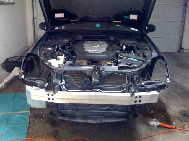

Once your headlights are removed, your car should look disastrously like this.
2006 infiniti m45

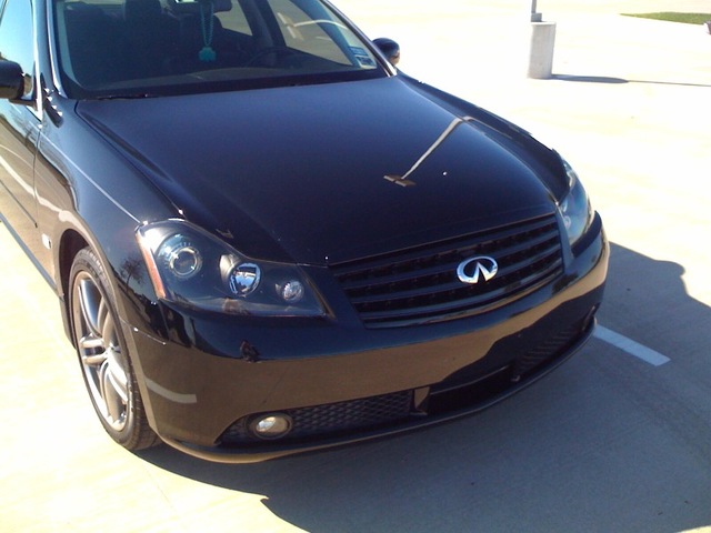

Get sandpaper to grind down all the chrome and rinse clean. I also used a leaf blower to make sure there aren’t any particles remaining. For painting, I used gray automotive primer giving it 3 coats and allowing 20 minutes between coats. Then I used Rustoleum flat black and also giving it 3 coats with about an hour between coats. I used up 1 can of primer and 2 of paint, both can be had at Home Depot. Of course, you can get it any color of your choosing but since my car is black, that’s what I went with. Once it is cured, reverse everything and put the lamp and lens back in the oven to heat the glue. Then put the lens back on and apply pressure for a minute or two and reverse procedure. Here are my results.
Dang bird droppings……
2006 infiniti m45
2006 infiniti m45
