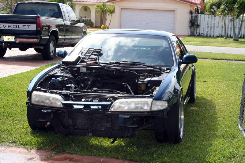

Swapping a V8 into a Nissan 240sx may not have seemed feasible in the late 90’s the last 240sx rolled into the U.S. However, times have indeed changed. These days any manner of V8, V6, and inline 6 or 4 cylinder worthy of building up has found its way into the engine bay of the venerable 240sx.

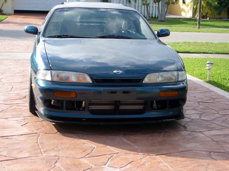

One thing still remains a rarity though, swapping a Nissan-badged V8 into a 240sx! Well, not for Jerry M. of Miami Florida (gs14racer). Jerry is the proud owner of a 1995 S14 240sx and he’s no stranger to the platform! This is his third S14 in the past 4 years; his last one had a Nissan SR20DET motor with approx 360whp, and was used at multiple track events! Jerry’s current car is the real deal though, boasting 4.5 liters of Nissan V8 goodness, with a power plant found in a US-Spec 90-95 Infiniti Q45 or non-US Market 89-01 Nissan President. Jerry’s no slouch when it comes to re-working nearly everything on the car, for a unique and definitely remarkable ride!

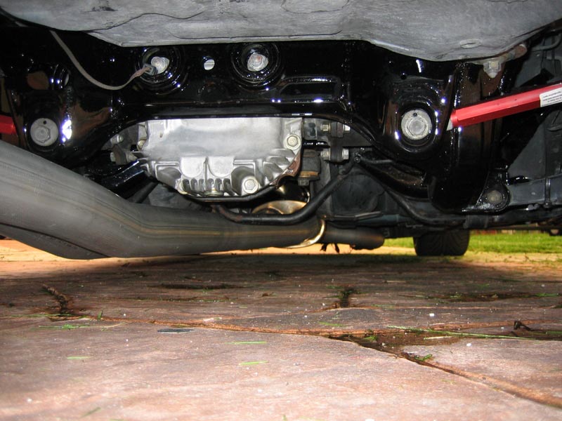

SPL Solid Sub-frame Bushings
J30 VLSD Rear Differential
Welded and reinforced sub-frame by Jerry’s own hand

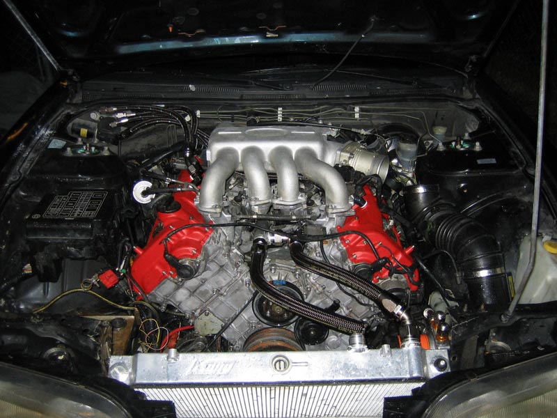

Engine work and VH45 modifications

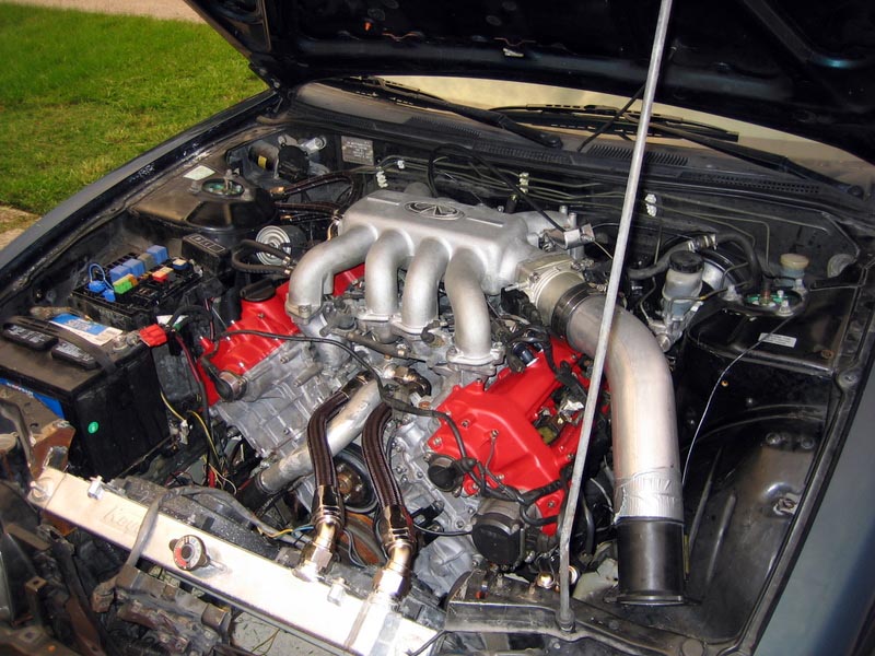

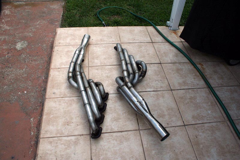

The real fun and highlight of this car is not just the engine swap, it’s the vast amount of work done with and on the swapped motor including the hand-made custom exhaust headers! For a nearly stock engine the VH45 sure lays down the numbers that yearn for some more go fast goodies and shows promise to make good use of them!
The VH45DE itself is no slouch, in fact with over 200k miles on it Jerry’s VH is running terrific with a good tune up and a few modifications. Another point to consider is the VH is cheaper, parts are easier to get, puts out the same amount of power stock and still weighs less then an RB engine and transmission! The VH being a V8 also has a fantastic torque curve instead of spiking like many boosted engines, such as RB’s and some SR’s – Starting out with power from the get-go is a great thing!  Once boosted, be it a turbo, turbos or supercharged the VH powerband jumps and when tuned properly will still follow a great flat curve and depending on the type of forced induction, that curve may start at 2500 RPM’s!
Starting out with some simple ECU tuning and nothing else the VH45 will see 270ft/lbs of torque as tuned by our own moderator Wes Stinson. If that interests you, look up Wes here on NICO (his screen name is elwesso).

92 Infiniti Q45 V8

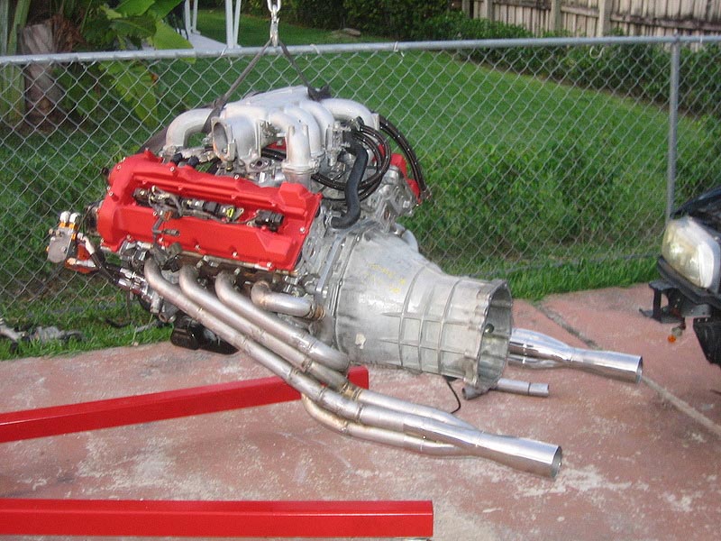

Transmission 95 300zx twin turbo 5 speed
Mazworxz 5 speed transmission adapter plate
Wiring performed by the owner as well as all other custom fabrication work except a portion of the aluminum welding which was done by a friend, screen name (Miami240) on the forums.

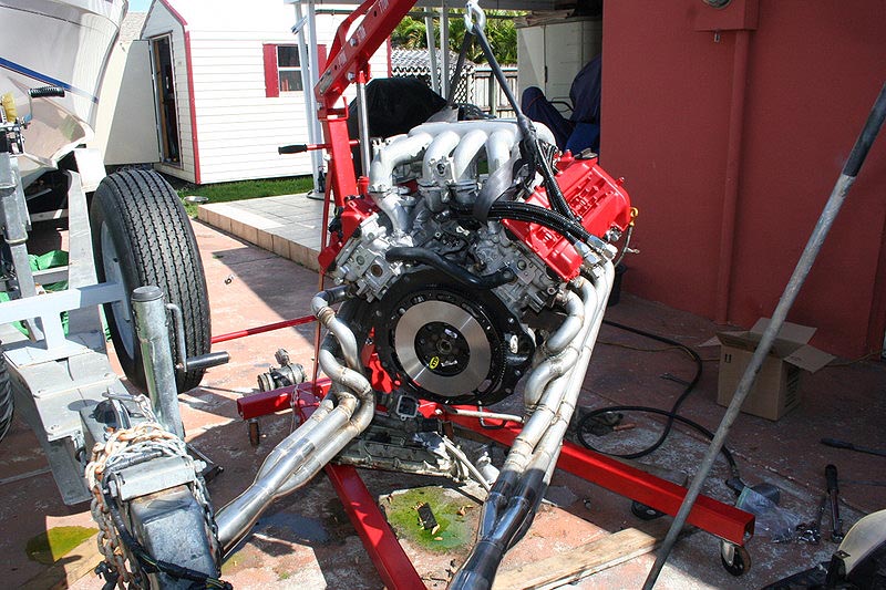

The headers are made out of 1 3/4 primary mild steel, using a long tube equal length design with stainless steel merge collectors and a 3-inch outlet

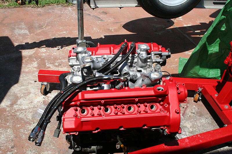

Crank case ventilation system redone with nylon braided hoses and polished fittings
Stainless steel Allen bolts on most of the engine.
Trust GT-R oil filter kit re-mounted in a more convenient location
Custom radiator, alternator and power-steering brackets
Custom drive shaft
Custom engine mounts
Custom dual 3” exhausts, expansion tank and y-pipe
