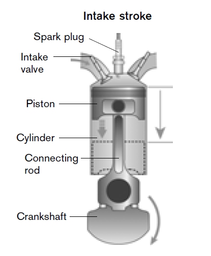

4-stroke engine
The 4-stroke engine takes its name from the fact that it takes four strokes of the piston to complete one cycle.
On the first stroke the intake valve (or valves) opens, and as the piston goes down in the cylinder, the air/fuel mixture is drawn into the cylinder. During this stroke the airflow meter in the fuel injection system sends a signal to indicate how much air is coming in. Then a computer-controlled fuel injector sprays a precise amount of fuel into the cylinder at just the right moment.

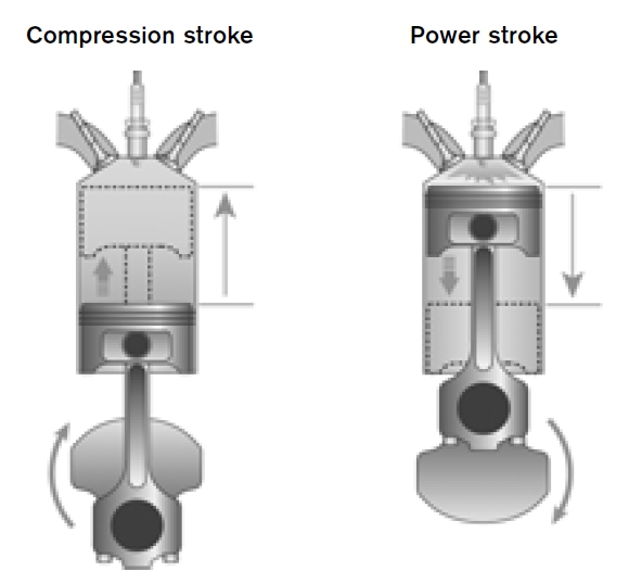

Next is the compression stroke. The intake valves close as the piston travels up the cylinder, and the piston compresses the air/fuel mixture. The higher the compression, the more power is generated in the next stroke.
As the piston approaches the top of the compression stroke, the spark plug fires, igniting the compressed air/fuel mixture. The rapidly expanding gases push the piston back down the cylinder. This is the stroke that generates the engine’s power. The strokes in each cylinder are timed so they occur at intervals that create a smooth-running engine and quiet performance.

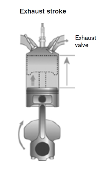

During the fourth, or exhaust stroke, the turning crankshaft forces the piston back up the cylinder, the exhaust valve (or valves) opens, and the piston pushes out the burnt air/fuel mixture past the exhaust valve. From there, the exhaust gases travel through the exhaust manifold, catalytic converter, muffler, and out the tailpipe.
This 4-stroke process generates the power that is used to turn the wheels. The piston is attached to a connecting rod, which converts the piston’s linear motions to the circular motion at the crankshaft. The action is very similar to the way the up-and-down motion of a bicycle rider’s legs is converted to a circular motion at the sprocket.

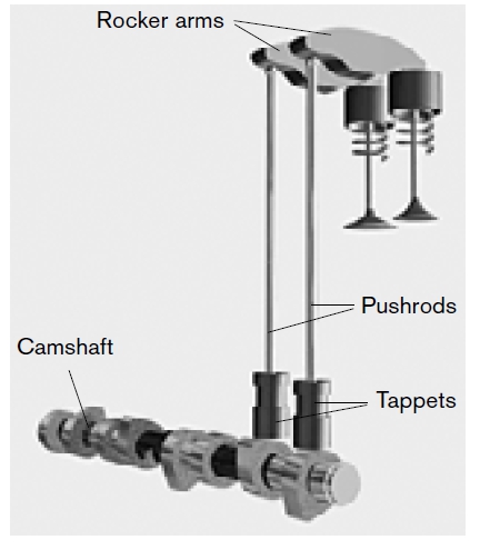

Overhead valve (OHV) engine
The overhead valve (OHV) engine is still found in many domestic vehicles. With the overhead valve design, a system of rocker arms, pushrods, and tappets opens and closes the valves. A single camshaft located in the cylinder block actuates the pushrods. Generally, the OHV design works well in large-capacity, low-revving engines like those used in large trucks.

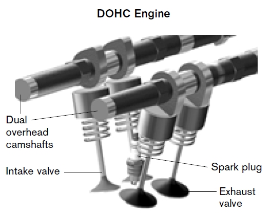

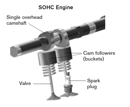

Overhead cam (OHC) engine
With the overhead cam engine, one or more camshafts located in the cylinder head open and close the valves for each cylinder. The OHC design is superior for the smaller, higher-revving engines found in passenger vehicles. OHC allows a more efficient and compact design and more positive actuation of the valves. OHC engines have fewer moving parts, so there is less inertia, or moving weight. Therefore the engines can be run at higher speeds and often produce more power than larger-capacity OHV engines.
On single overhead cam (SOHC) engines, one camshaft operates both the intake and exhaust valves. On double overhead cam (DOHC) engines, one camshaft actuates the intake valves and a separate camshaft actuates the exhaust valves, providing even more precise control for enhanced performance. That means on V6 or V8 engines, there are four camshafts in total (two for each cylinder head).

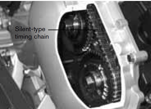

  • The silent-type camshaft timing chain is designed specifically so it meshes with its drive sprockets with a minimum amount of impact noise.

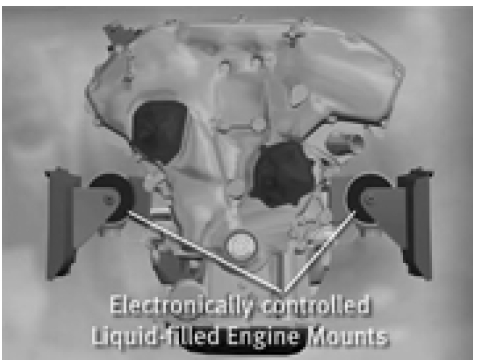

  • Liquid-filled engine mounts absorb engine noise and vibration more effectively than conventional solid rubber mounts.

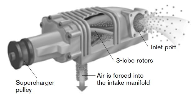

The supercharger improves horsepower and torque by pumping extra air into the engine. The concentrated charge of air provides a more powerful combustion stroke, resulting in improved performance. Unlike a turbocharger, which must spin up to speed to produce power, a supercharger is connected directly to the crankshaft by a belt, resulting in instant response.

The VG33 also uses liquid-filled front engine mounts that help absorb engine noise and vibration more effectively than conventional solid rubber mounts.

  • Liquid-filled engine mounts absorb engine noise and vibration more effectively than conventional solid rubber mounts. (Selected models)

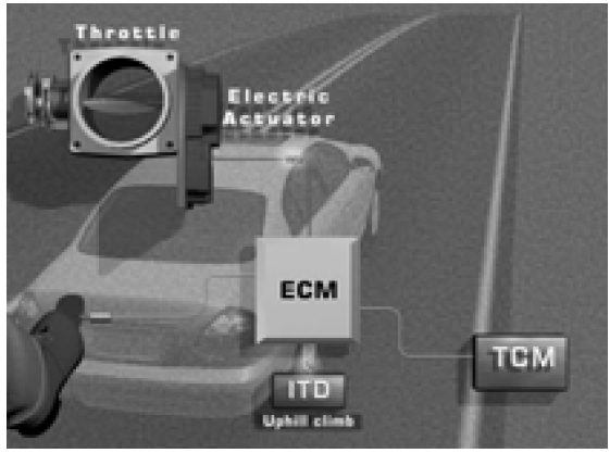

  • Infiniti Torque Demand (ITD) maintains vehicle speed without having to press the accelerator pedal more when climbing a hill.

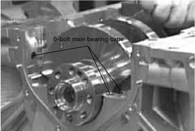

  • The forged steel crankshaft adds durability, and the 6-bolt main bearing caps provide greater strength and rigidity than conventional 2- or 4-bolt versions.

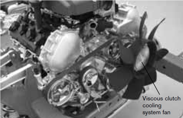

  • A viscous clutch (see illustration) allows the cooling fan to operate at low speeds and disconnect at higher speeds when there is sufficient airflow through the radiator. This allows the engine to operate more efficiently and helps reduce noise.

The silent-type camshaft timing chain is designed specifically so it meshes with its drive sprockets with a minimum amount of impact noise. Its single-stage design reduces weight, friction, and noise for improved throttle response.

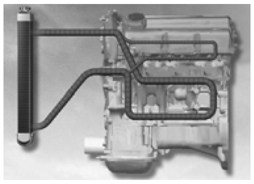

2-stage cooling system (QR25, VQ35, VQ40, VK45, VK56 engines)
In a conventional engine cooling system, water flows from the radiator to the water pump to the cylinder block and then to the cylinder heads.  In the 2-stage cooling system, however, water is supplied to the block and heads separately, because these areas require different quantities of coolant to control their temperatures (high temperatures at the cylinder heads with relatively lower temperatures at the cylinder block). In effect, this provides the top and bottom halves of the engine with separate cooling systems.
The main benefits of the 2-stage cooling system are faster warm-up (both the engine and heater), lower hydrocarbon emissions, and increased fuel efficiency.
Added benefits of the 2-stage cooling system include its smaller size, which contributes to overall engine compactness; its smaller total coolant capacity; and its reliability (the VQ’s water pump is driven by the engine’s timing chain, and is mounted inside the timing case).

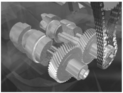

Compact engine balancer system (QR25 engine)
Engine vibration becomes noise in the passenger compartment. It is inherent in in-line 4-cylinder engines that are larger than two liters.
To compensate for this vibration, the QR25 4-cylinder engine uses a separate chain-driven compact engine balancer that is ideally located to generate force in the opposite direction of the vibration, reducing noise in the passenger compartment.
The engine balancer is very compact, mounted low, and located inside the engine’s oil pan so it does not increase engine size or add much weight. In contrast, some belt-driven competitive engine balancer systems are bulkier and heavier to compensate for their less-than-ideal location inside the engine.

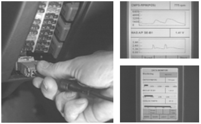

CONSULT-II
CONSULT stands for Nissan’s Computerized On-board System Universal Tester. This system is a handheld computer, called the Nissan CONSULT Diagnostic Tool. CONSULT has been used by Nissan and Infiniti service technicians since 1989 to detect, diagnose, and correct problems. The original CONSULT is compatible with 1989–1999 vehicles.
CONSULT-II is a more powerful version of CONSULT that is designed to troubleshoot more systems on the vehicle and to be more efficient to use. The new tester employs a 32-bit Motorola Power PC computer — similar to the central processing unit found in the most recent Macintosh computers. CONSULT-II carries both a Nissan proprietary communications protocol (found in the original CONSULT) as well as the new EPA-dictated protocol for standardized OBD II systems.
Beginning with 2000 model year vehicles, the new protocol allows reprogramming the engine ECCS software in the service department. For example, if a customer experiences a malfunction light relating to emission control, the problem may be in the software instead of the control unit. Reprogramming the software with CONSULT-II means the problem can be solved without the need to physically remove and replace the control unit. New diagnostic software also expands the list of CONSULT-compatible systems, including:
  • Body Control Module (BCM)
  • Vehicle Security System (VSS)
  • Controller Area Network (CAN)
  • Vehicle Dynamic Control (VDC)
  • Intelligent Cruise Control (ICC)
  • Electronic Brake force Distribution (EBD)
  • Vehicle Immobilizer System
  • Xtronic CVT (Continuously Variable Transmission)
When plugged into the data link connector located in a Nissan or Infiniti vehicle, the CONSULT-II system can read the signals being sent to and from individual components, such as:
  • Engine (ECCS)
  • On-Board Diagnostic System (OBD II)
  • Automatic transmission

It can detect most problems with these systems. The computer can even simulate actual driving and atmospheric conditions, thus reducing diagnostic time. And because of its small size and light weight, CONSULT-II can be used on a road test.
CONSULT-II is a sophisticated tool that assists service technicians in a variety of ways. For example:
  • The work support mode enables technicians to adjust some components faster and more accurately than by hand.
  • The self-diagnosis mode searches for large failures in ECCS circuits (such as open or short circuits).
  • The function test mode guides technicians through diagnostic procedures to test individual components and circuits.
  • The data monitor mode collects data while the technician duplicates conditions that cause a malfunction, and then prints out data in graph form for comparative analysis.
  • The freeze frame mode stores data for later analysis about the driving conditions at the moment a malfunction is detected. This mode is particularly useful for discovering the cause of intermittent problems, because the CONSULT-II unit can be left in the vehicle and programmed to “wake up” when the intermittent problem occurs.
Due to vehicle wiring changes, the original CONSULT is not compatible with model year 2000 and later vehicles, but continues to be a useful tool for 1989–1999 vehicles. CONSULT-II, on the other hand, will support all Nissan and Infiniti vehicles and systems back to 1989.
Infiniti Torque Demand (ITD) automatically maintains vehicle speed when driving uphill. The driver does not have to continuously press and release the accelerator pedal to maintain a set speed. Infiniti Torque Demand adjusts engine power and the transmission’s shift schedule to meet driving conditions.
EXPLAINING ITD
Just as your thermostat at home senses the demand for heating or cooling in your house, Infiniti Torque Demand senses the demand for greater acceleration in the vehicle. When your house gets cold, the thermostat senses the need for heat and automatically turns on the furnace. In a similar manner, when driving uphill, ITD senses the need for additional power and automatically compensates for different driving conditions.
The way the engine is mounted to the frame or body structure of the vehicle affects the amount of noise, vibration, and harshness that is transmitted to the passenger compartment. Almost all Nissan and Infiniti vehicles use one or more mounts that are filled with a viscous liquid. These liquid-filled mounts absorb engine noise, vibration, and harshness more effectively than traditional solid rubber mounts.
Some Nissan and Infiniti front-wheel-drive vehicles also have electronically controlled front and rear liquid-filled engine mounts. The electronically controlled engine mounts take the advantage of fluid technology a step further than normal liquid-filled engine mounts. A 2-chamber mount works in conjunction with the engine’s Engine Control Module (ECM) to vary the volume of fluid in the mount, based on engine rpm. It does this by opening or closing a valve between two chambers inside the engine mount. At low rpm, the volume of fluid is increased to provide maximum damping. At higher rpm the volume is decreased, providing the firmness needed for optimum feedback to the driver. The electronically controlled engine mounts are CONSULT-compatible.
Floating membrane engine mounts
Selected vehicles have liquid-filled engine mounts that include a floating membrane that provides benefits similar to electronically controlled liquid-filled engine mounts. The membrane varies damping to improve NVH absorption.

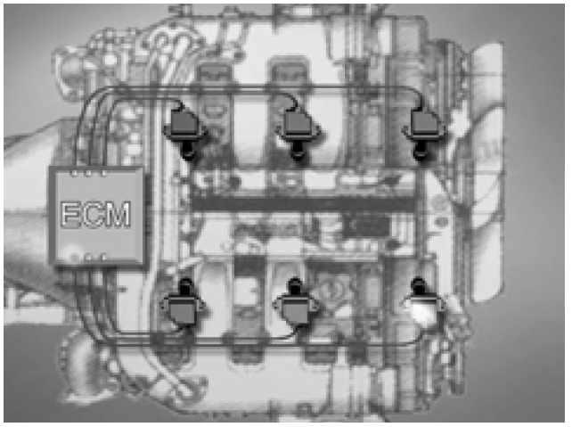

Nissan Direct Ignition System (NDIS)
The ignition system provides the high voltage spark that ignites the air and fuel mixture in the engine’s combustion chamber. A traditional ignition system includes a single high-voltage coil and a mechanical distributor that distributes power from the coil to the spark plugs through high-tension/voltage wires.
The Nissan Direct Ignition System (NDIS) eliminates the need for the traditional distributor and high-tension wires. Instead, NDIS provides a separate ignition coil for each cylinder, with one coil placed directly over each spark plug. Each coil is precisely controlled by a separate power transistor actuated by the ECCS (Electronic Concentrated Control System).
As a result, NDIS enhances performance by providing consistent and reliable high voltage to the spark plugs. At the same time, maintenance expenses are reduced because there is no need for spark plug wire inspection and replacement during the vehicle’s service life.

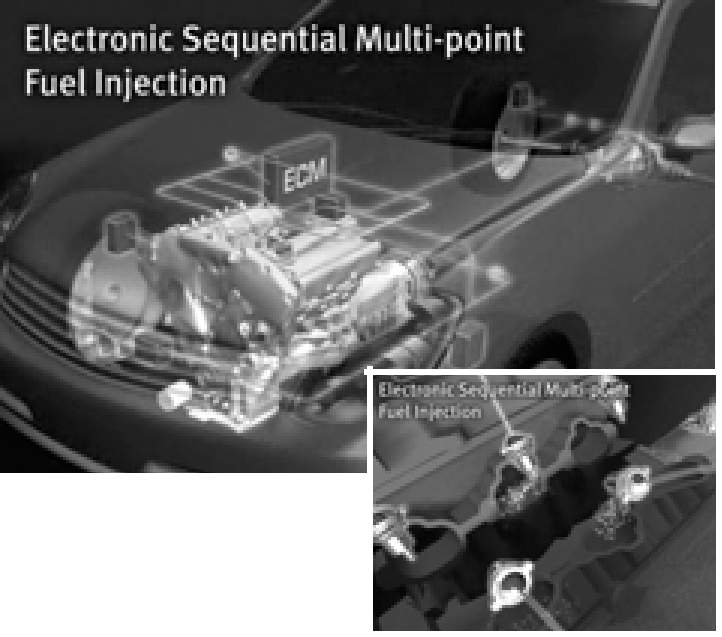

Sequential multi-point fuel injection
All Nissan and Infiniti engines feature sequential multi-point fuel injection. “Sequential” means the air/fuel mixture is injected into the cylinder in the precise quantity and at the exact time in relation to valve timing and piston position. This enhances overall driveability and, especially, hot and cold starting capability. “Multi-point” means each cylinder has its own injector for an efficient and precise delivery of the air/fuel mixture. The sequential multi-point fuel injection system provides optimum power under all driving conditions, and this super-precise control of the air-fuel ratio produces cleaner exhaust.
The fuel injection systems on some competitors still use a single injector for the entire engine, or use multi-point injectors that do not time the injection of fuel into the cylinders.
Superchargers
The basic concept of a supercharger is to force extra air into the intake manifold, mixing it with an appropriate amount of fuel, to create a more powerful combustion stroke than in a normally aspirated engine. The more power created during combustion, the more power generated by the engine. The supercharger provides additional boost at all engine speeds.
Key benefits of the supercharger include immediate throttle response, increased horsepower and torque across the complete engine operating range, and a relatively small effect on fuel economy (less than 10%).
Supercharger vs. turbocharger
Superchargers and turbochargers both pump extra air into the engine. A supercharger, however, is connected directly to the engine’s crankshaft by a belt (with a 105,000-mile service replacement interval). The positive connection yields instant response. In contrast, exhaust gases drive a turbocharger. The turbo must overcome its own inertia and spin up to speed as the flow of exhaust gas increases. This can result in a momentary delay in throttle response or “turbo lag.” The Nissan supercharger also has a self-contained, sealed-for-life lubrication system, while a turbocharger requires engine oil constantly circulating through it.
Factory-installed vs. aftermarket
Nissan’s factory-installed supercharger is covered by Nissan’s 5-year/60,000-mile powertrain coverage. Aftermarket supercharger kits do not provide factory warranty coverage, and in some cases may invalidate factory warranty coverage.
Note: Premium fuel is recommended for Nissan supercharged engines. Although lower-grade fuel can be used, the engine’s knock sensor detects regular or mid-grade fuel. It then retards ignition timing and opens a bypass valve so the engine does not receive any boost from the supercharger. Because a supercharged V6 engine has a lower compression ratio than the normally aspirated V6, the result will be a decrease in performance compared to non-supercharged V6 models.
