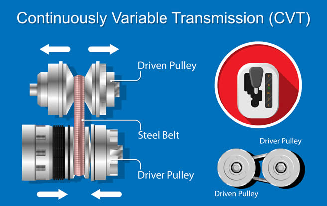

    A CVT operates very differently than an automatic or manual transmission, which have actual mechanical gears, bathed in fluid, managing your engine’s output and transferring power to the driveshaft or drive axles at a predetermined ratio – a different numerical ratio for each gear. A CVT on the other hand, is basically comprised of a belt between two spindle-shaped spools. In order to keep the engine operating at maximum efficiency in its “sweet spot” of RPMs for a given load and throttle input, an infinite range of gear ratios is achieved by movement of that belt to wider or narrower locations on the spools during the driving process.
