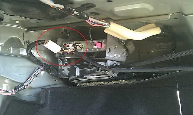

I first removed all the push rivets in the trunk but to get the pass-thru fasteners to come out I had to get on the back seat and gently push them free one by one. They go into these slots where the red circles are: (green arrow is where the xm unit is located and the red arrow is where I snaked the cable through)
Here’s a better pic of the hole:
Here’s the XM Y-harness. I unplugged it by myself. It would be easier with a friend to pull the plug out while you hold the unlock down on the plug with a little screw driver.
