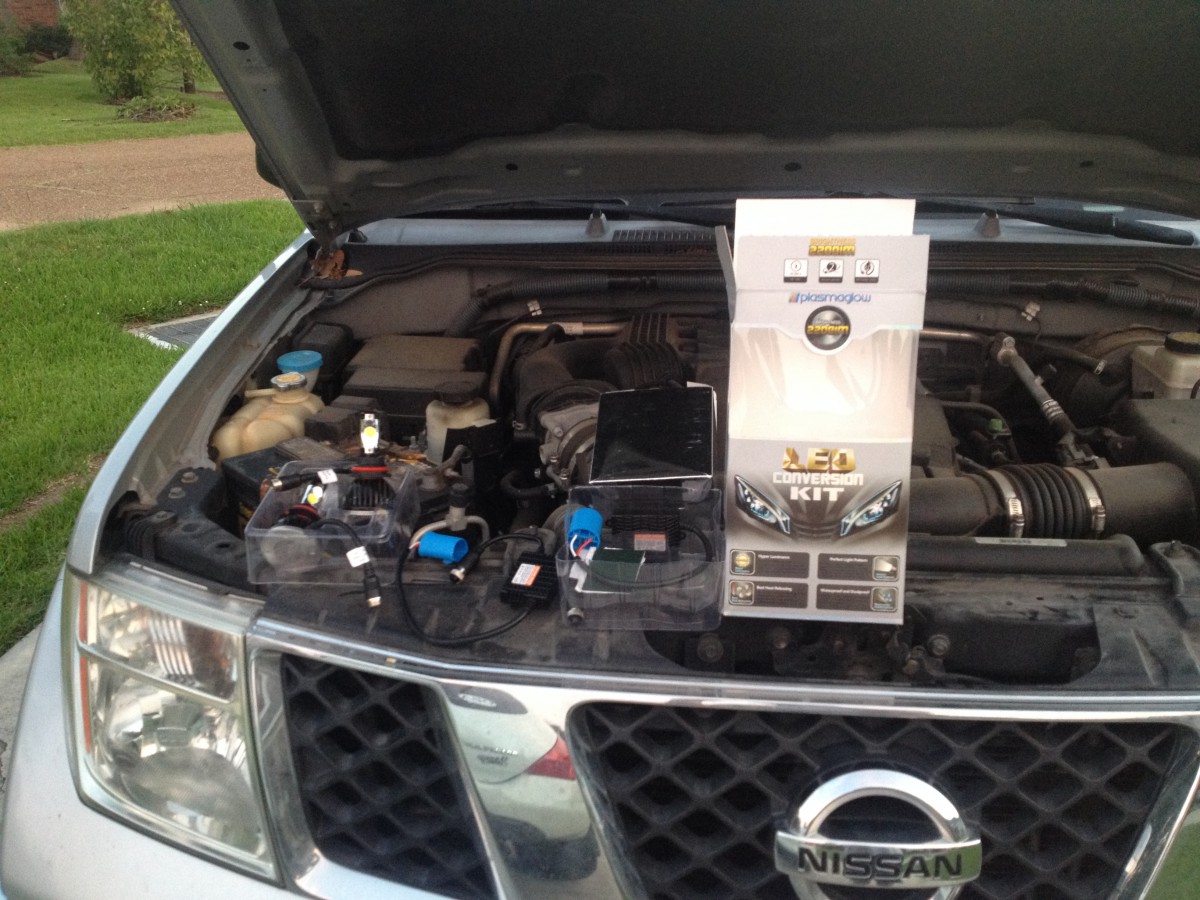

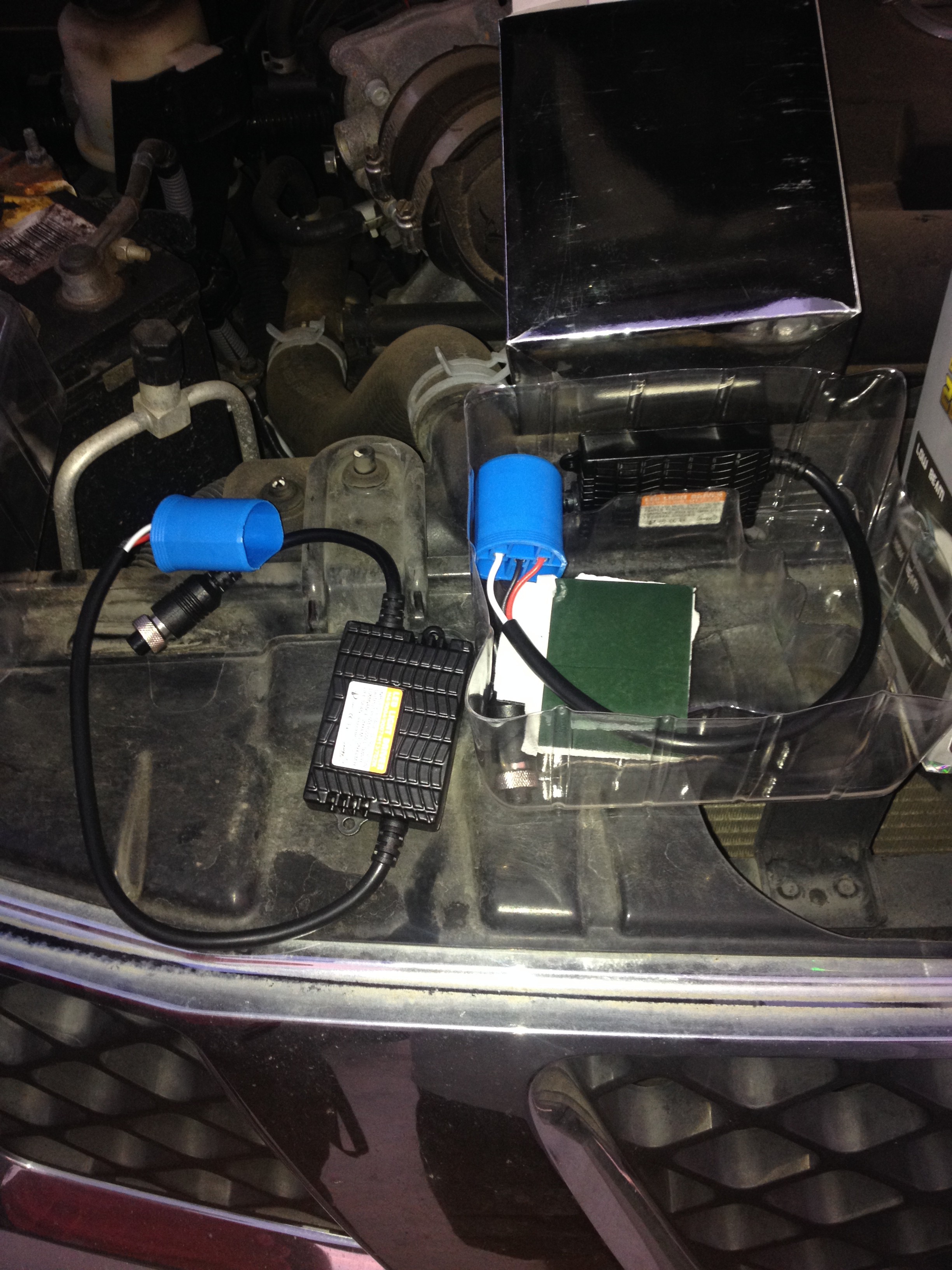

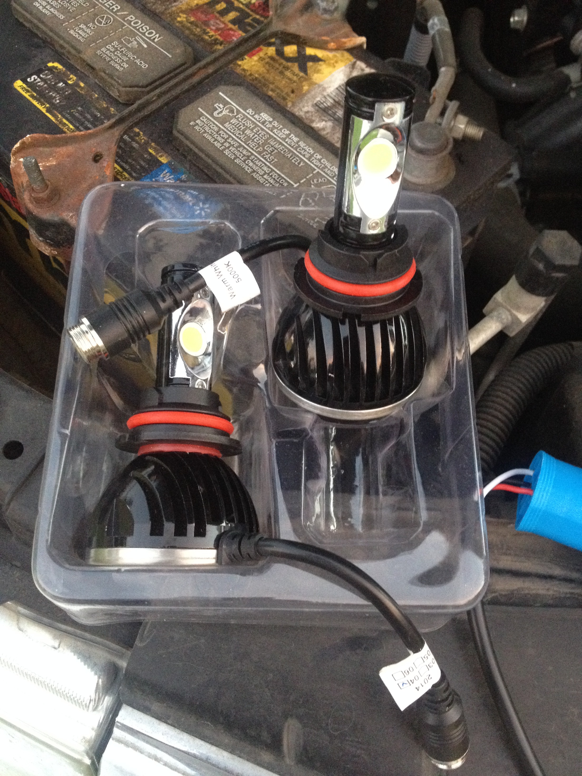

Here is everything laid out before the installation (click for larger images):
PIC 1 PIC 2 PIC 4 PIC 5

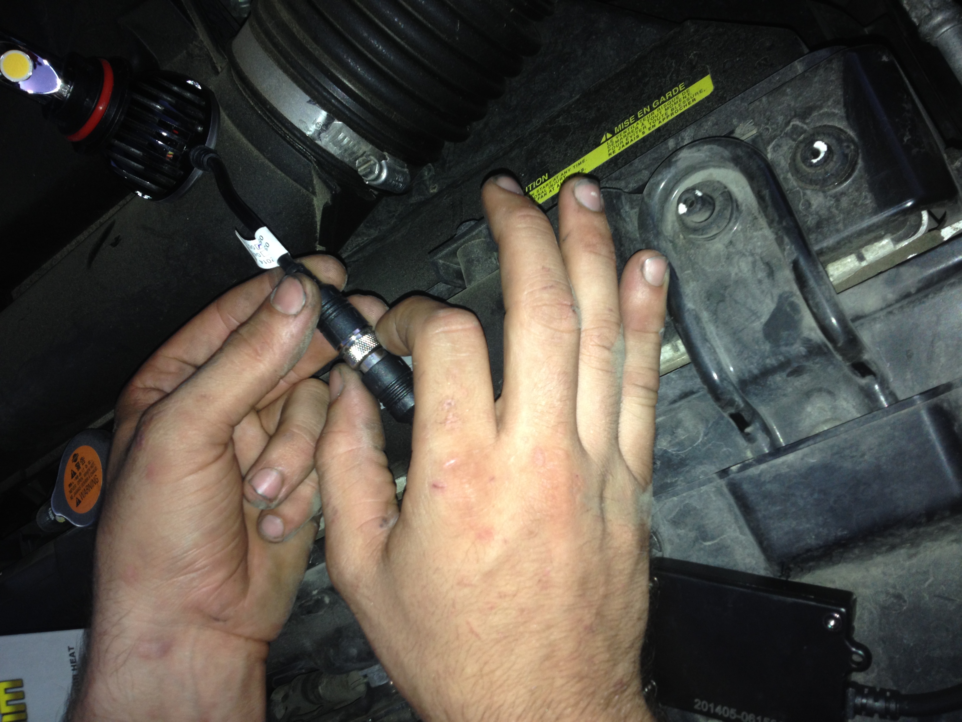

Remove factory bulb assembly just as you would if you were changing it.
PIC 3

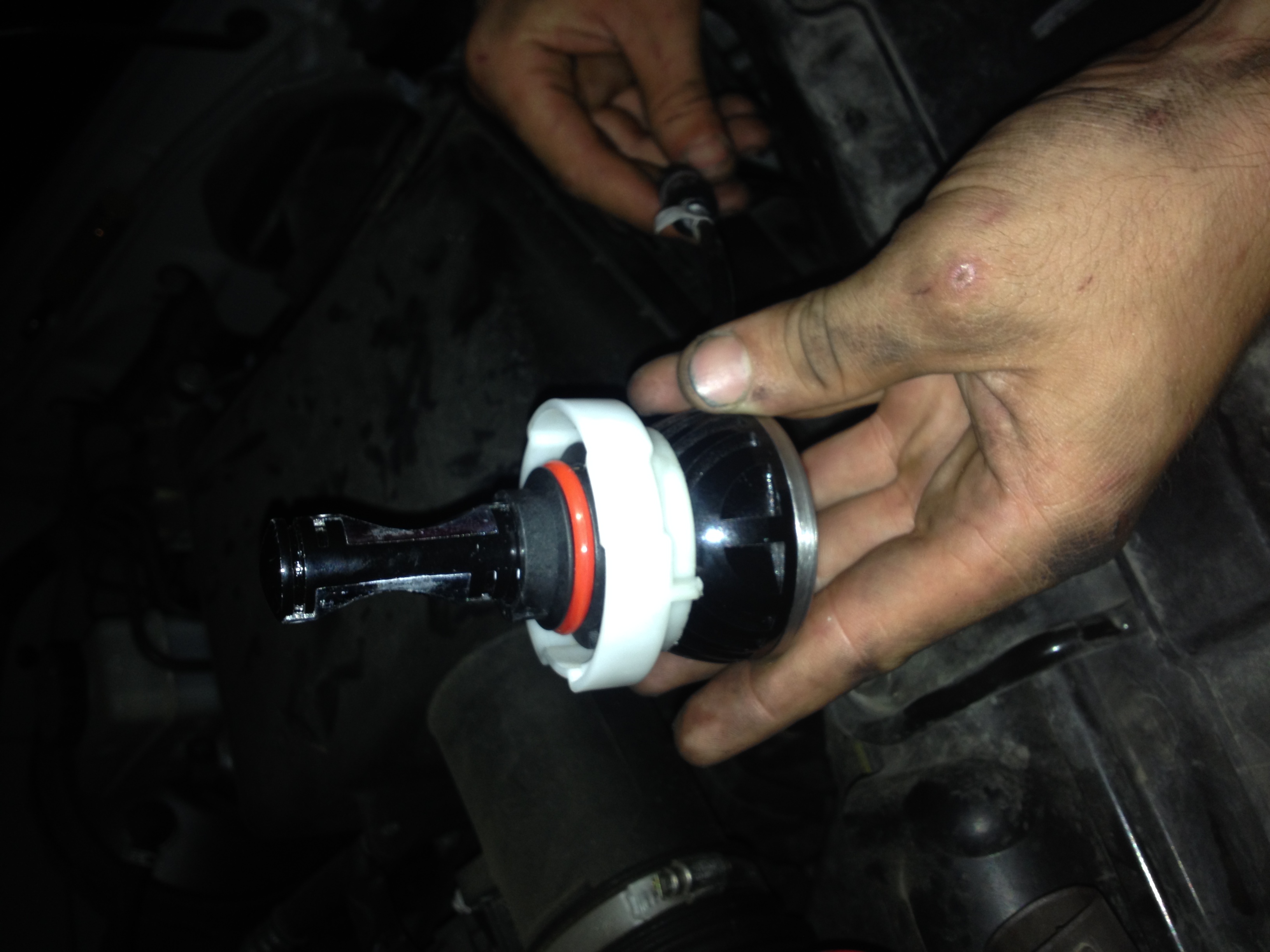

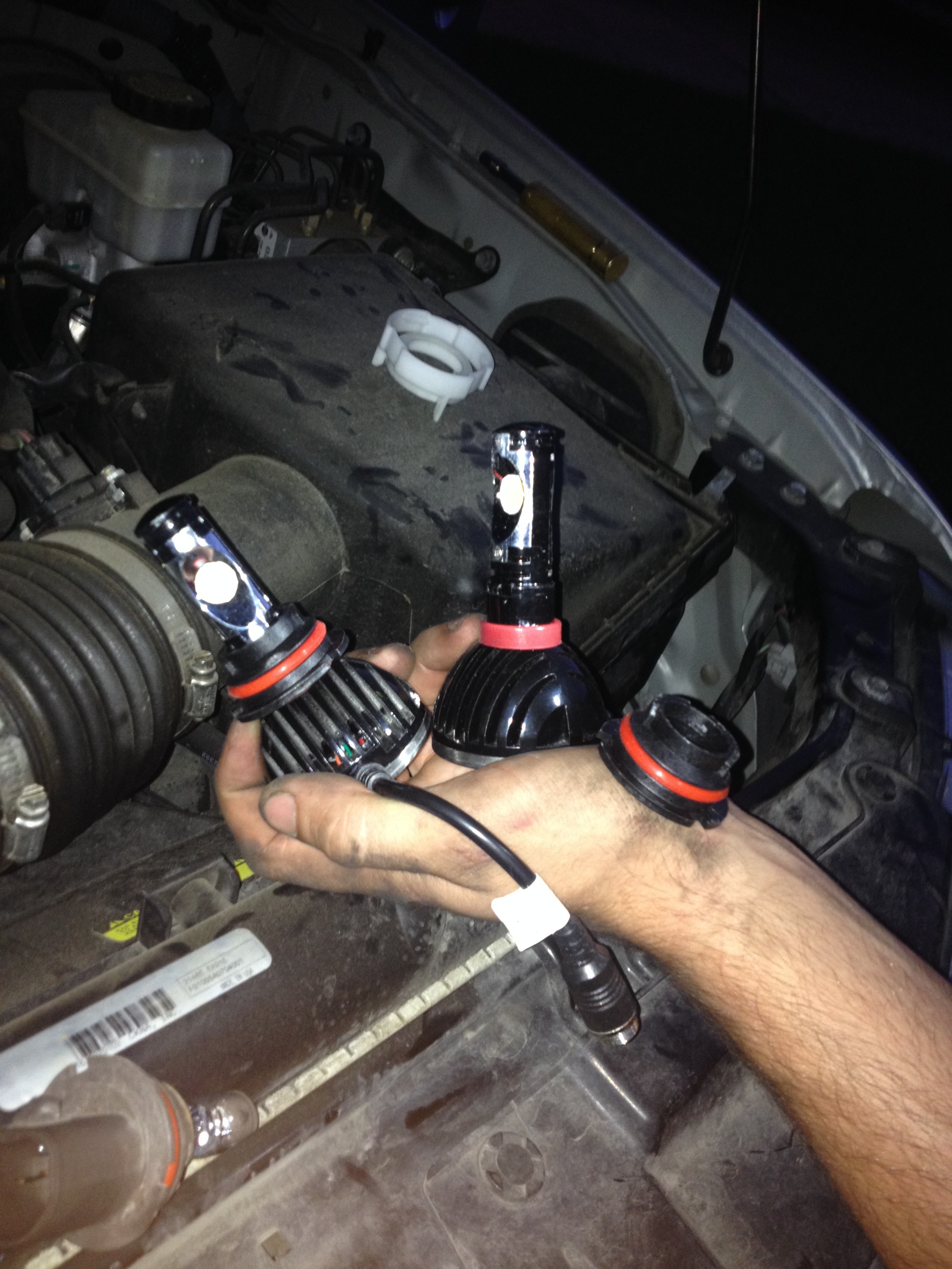

Remove the lower collar of the LED light assembly. It will it easily snap off. (The piece you are removing is on my wrist).
Pic 8

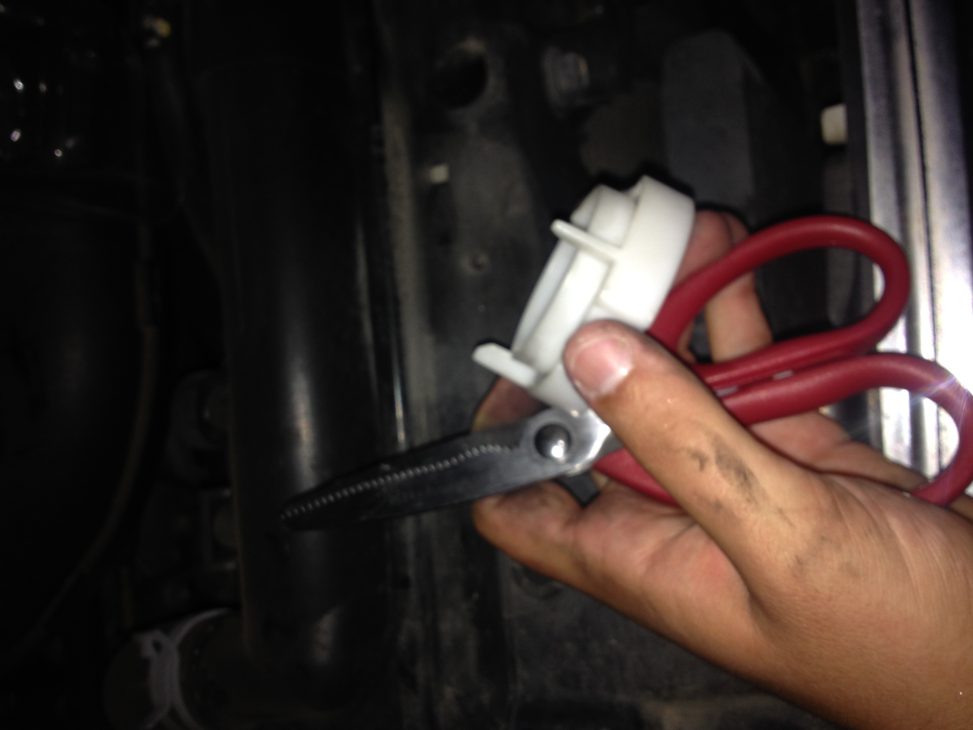

Take off the white, plastic headlight retainer and trim/shave the 3 tabs on it.
pic 9 Pic 11

Slide the white, plastic headlight retainer over the LED assembly and reinstall the lower collar.
Pic 10 Pic 12

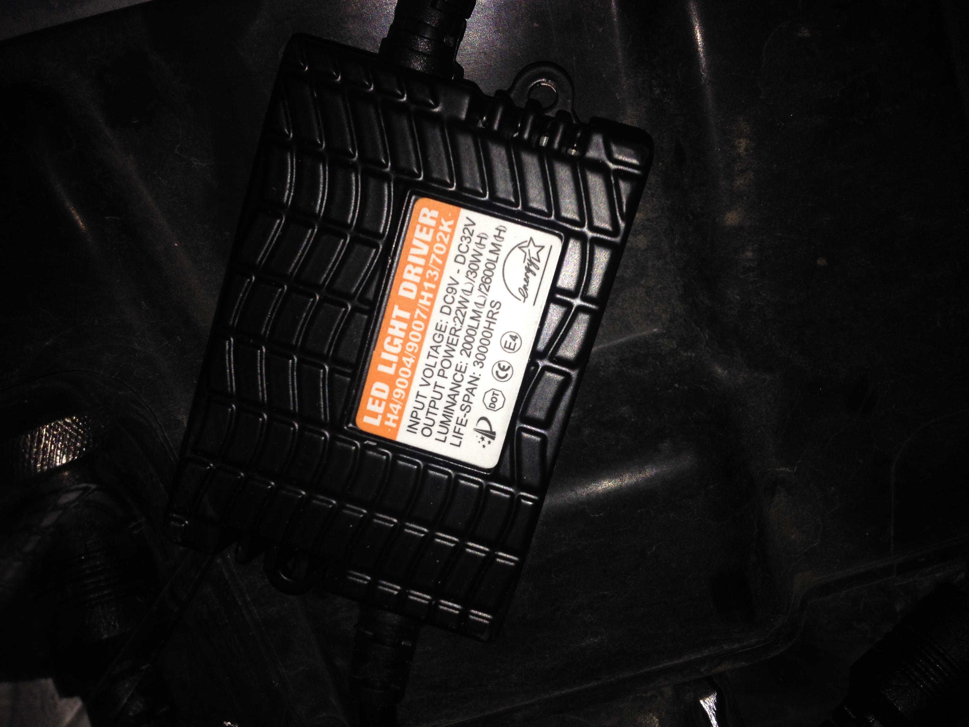

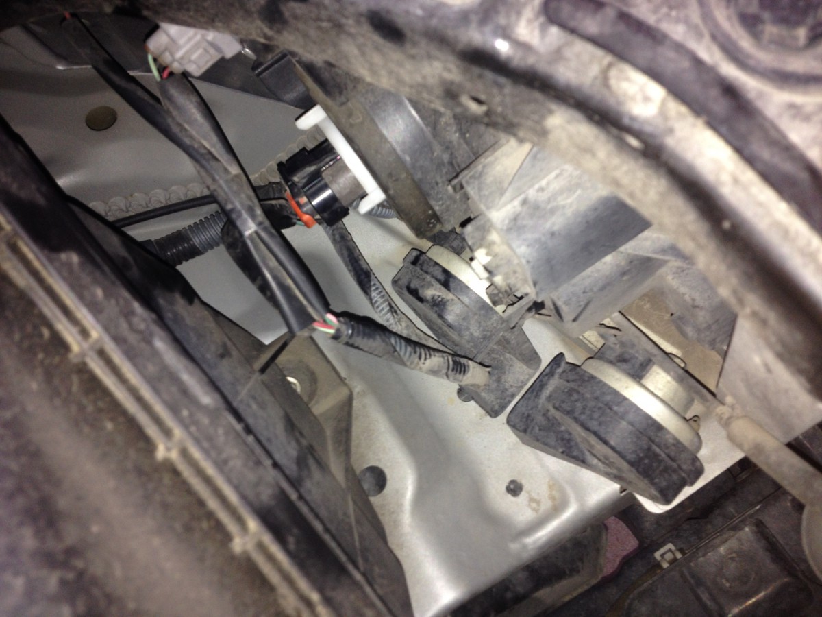

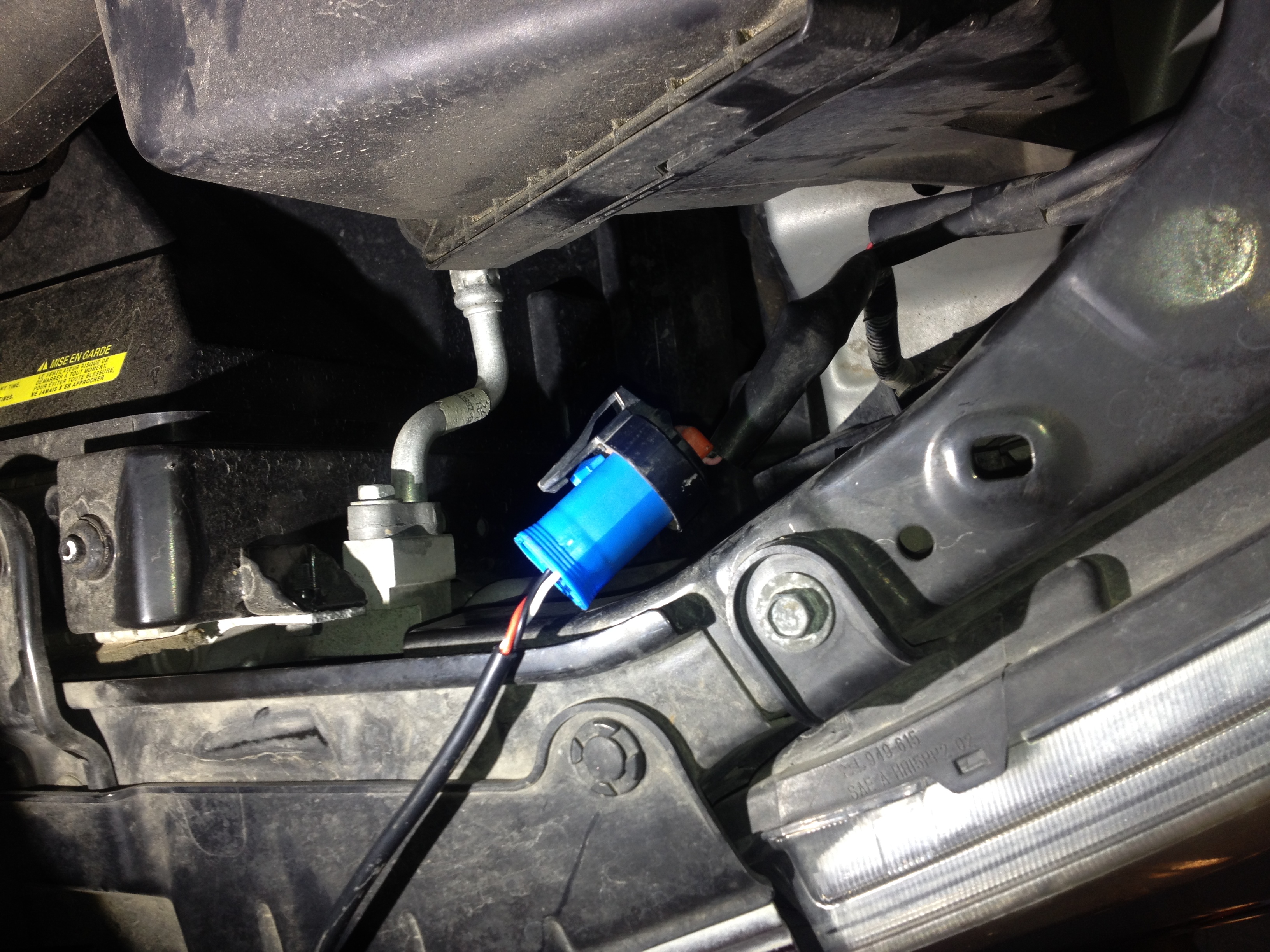

Plug in the assembly to your factory headlight wiring harness, and plug the harness in from the LED driver to the LED light.
PIC 6 Pic 7

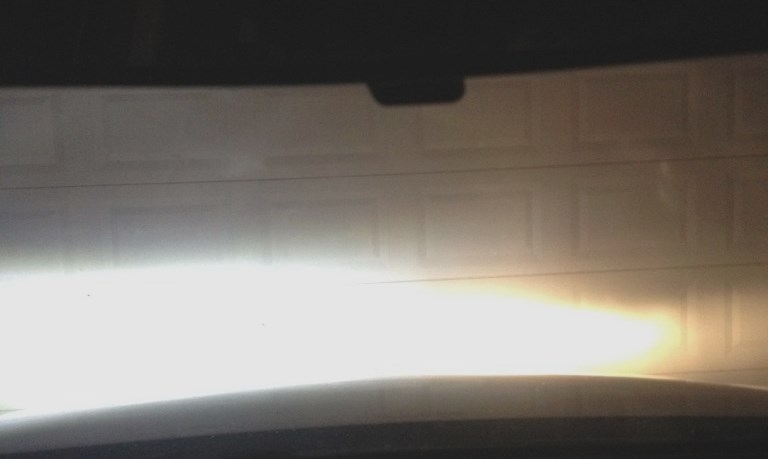

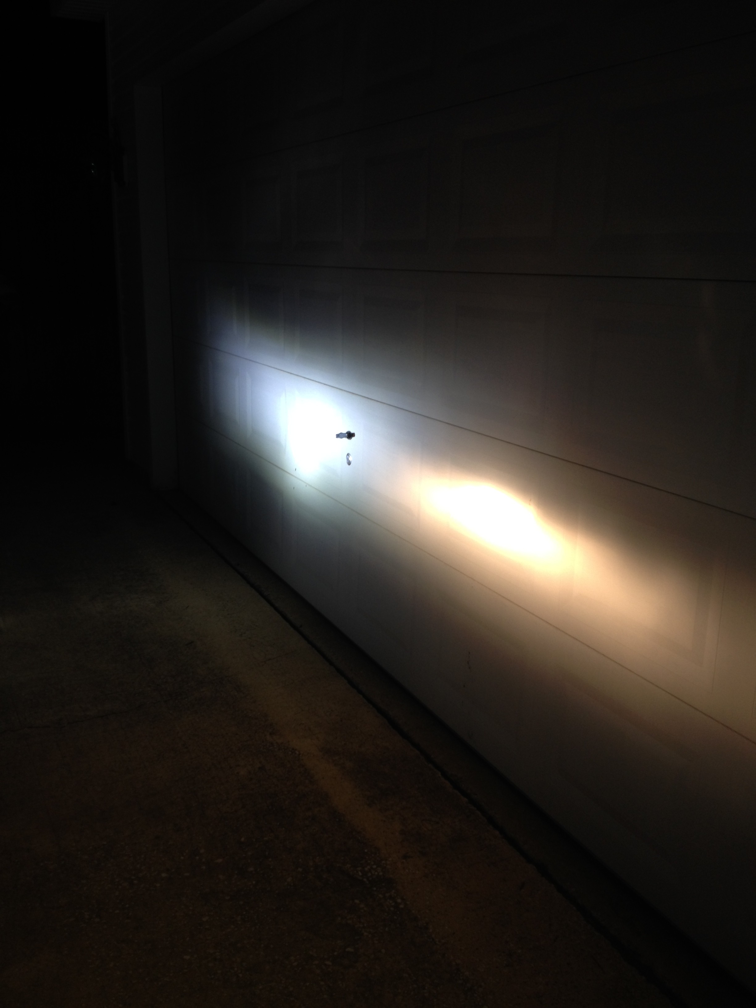

Here are the pictures I took of the beam itself – Note this is with the new PlasmaGlow Igniter on the left, the stock headlight on the right:
Pic 18 Pic 13 Pic 21
