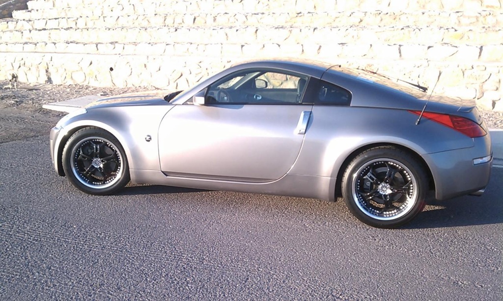

First, here’s my current ride height.
About three inches lower than stock in the rear, and one and a quarter inch lower than stock in the front, this
is plenty low enough for my personal taste. The fronts will go quite a bit lower, but the rears are as low as I could get them without setting too much preload on the spring or removing a perch.

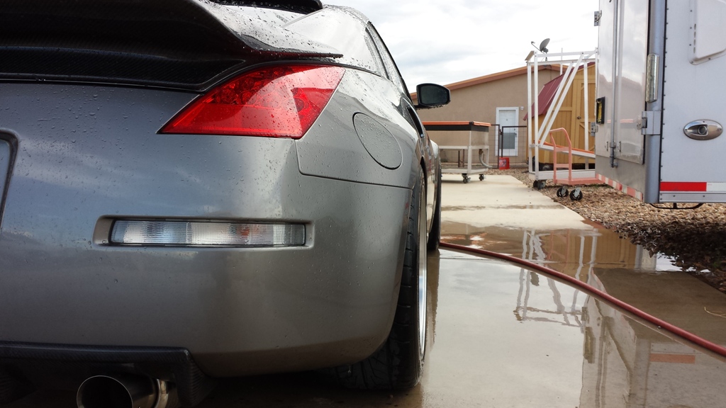

Here’s a shot of the negative camber I had after the drop, with my adjustable camber arms at stock length.
At negative 4.5 degrees of camber, it looked about right for the “stance” style, but much too much negative camber for my personal taste.
This is after the alignment, getting back into range with 1.5 degrees of negative camber in the rear.
