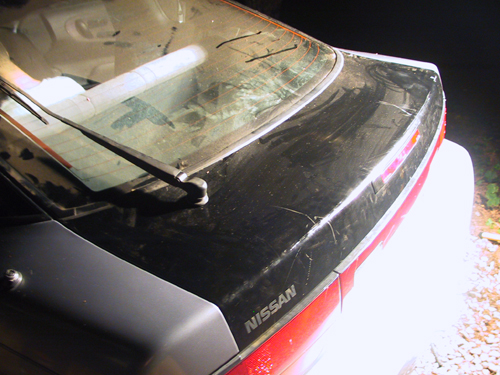

So after an exhausting search for a nice spoiler-less (and more importantly rust-less) hatch to replace my messed up one, I finally found one this morning. A trip to a not-so-local junkyard and $100 later, I had one in my driveway, ready to install.

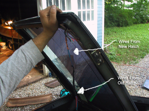

Step Seven: Pull The Wires Through Your New Hatch
Okay, it’s a little hard to understand just looking at the picture, but what we did was attach the old wires (where we cut them) to what we could see of the new wires.The “new” wires were cut by the junkyard, and about 2 inches were hanging out of the end of the hatch.
Just take the two ends (the TOP part of the new wires and the BOTTOM part of the new ones) and tape them together really well.Make sure you intertwine the wires and tape them together really well.
When that’s done, take off the carpet from the inside of the new hatch just like you did with your old one, find the right-side wires, and PULL them through towards you.They will come all the way out, and, pulling with them, the old wires that are still attached to the inside of your car.
When you have it pulled all the way through, undo the tape that you put together before, and VIOLA, you’ve got the right side of your hatch halfway done, without having to work in that cramped space up in the top or having to mess with those rubber gromets up there!Wooo!
Cut the wires on your new hatch off of the wiper motor and brake light, making sure to leave some space to splice them into the old wires you just threaded through.
To finish up the right side (sorry I dont have a picture of this), just pull the insulation off of the ends of each wire and connect them to the wiper motor and brake light wires (the ends you left extra) with some 14-16 guage butt connectors. This sounds hard, but it’s actually really easy– if you’ve ever worked on stereo equipment it’s the same deal. Just make sure you dont have any bare bits of wire showing and do a good job clamping down the butt connectors so they dont come undone.

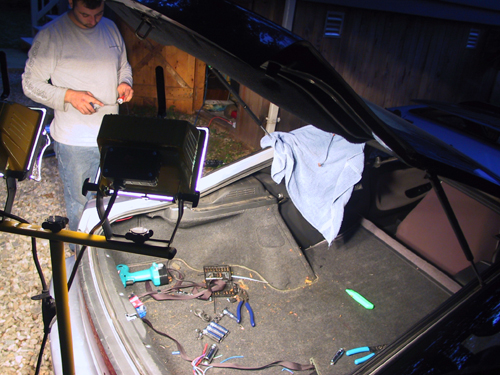

Step Eight:Ahhh, The Defrost Wires….
These wires are a pain.I mentioned before that they’re really short and the working space is tight… and since we cut them we kinda had to do it this way.You could try to pull them through the new hatch like we did on the right side, that would probably be better: but here’s how we did it.
Basically we stripped both ends of both wires and soldered/taped them together.One of the wires is much thicker than the other, and this one isnt too much of a problem… Just make sure you do a good job twisting it together and solder it well, it should be fine.

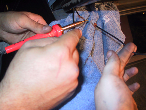

Basically its a tiny little wire that has the hot wire inside wrapped around a seperatly insulated ground wire.The ground wire
inside is EXTREMELY small, so be very careful stripping that second insulation and solder it neatly.Tape this inside part up, making SURE NOT TO CROSS IT WITH THE POSITIVE WIRE!Take your time and do this neatly, you dont wanna have to do this again, trust me.
You can see in the picture us soldering the super small ground wire with the positive wire pushed way back and out of the way… this worked the best for us.
This step took lots of arguing and lots of time… Hopefully with this DIY it’ll be a little quicker for you.Jeez, it’s night time already!!
NOTES:Yeah yeah I know you shouldnt have that hot soldering iron on that towel…. whatever, better it catch on fire and burn us than I drip solder into my beautiful s13!
Heh also watch out with that soldering iron… apparantly it’s really hot!See that mark on my friend’s hand in that picture up there?Yeah, I got him with the iron when he tried to slap at a mosquito.Whoah now.
