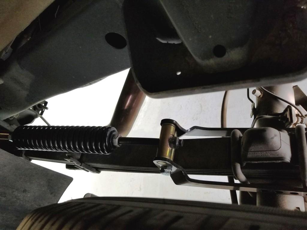

Installation, as promised, was easy – I probably spent more time looking for sufficiently-tall jackstands than I did installing the kit. The idea here is to induce MAXIMUM arch in the leaf springs to take full advantage of the Roadmaster benefits. So, there’s no need to even remove the rear wheels – allowing the entire rear suspension to hang freely (wheels included) helps maximize the effectiveness of the active suspension.
The installation went so smoothly and quickly, I took ONE picture of the process!
Thankfully, you won’t need my help here – the instructions supplied by Roadmaster are clear, thorough, and easy to follow. The system is shipped fully assembled – In fact, there’s only ONE fastener to remove and reinstall on each side, and it’s easy to access.
Adjustment is a one-time thing, and Roadmaster even provides a pair of feeler gauge shims to set the spring tension (depending on your load-carrying intentions). I selected the lower setting, in order to better evaluate the before-and-after differences. Once that’s done, it’s a simple matter of removing the jackstands and putting her on the ground. The Roadmaster kit doesn’t affect ride height like an extra leaf spring or a spacer, and it doesn’t simply limit travel like a bumpstop. Time to put it to the test.
