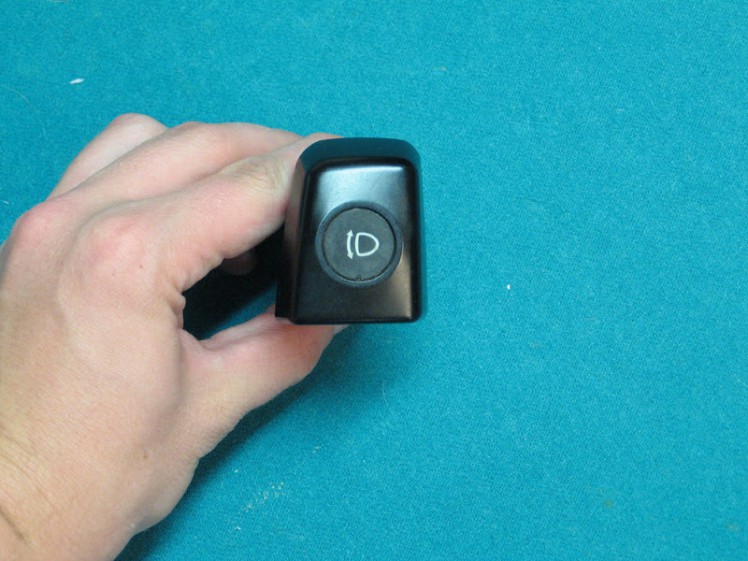

Headlight switch
30
31
32

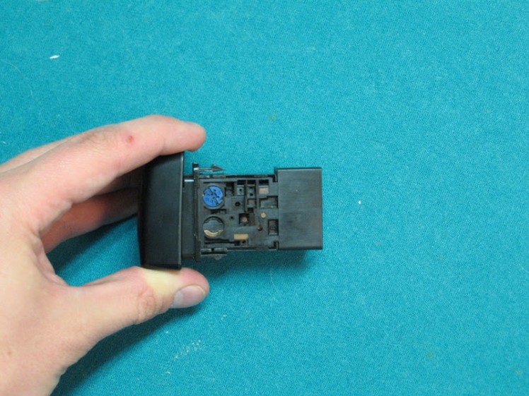

Remove the bulbs with a screwdriver and a set of pliers. The holders are a type that only needs to be turned ¼ turn to release.
32
Unwrap the wires from the bulb holder and remove the bulb. Be careful with the holder, as you’ll need to reuse it.
26
Carefully remove the bulb condom. You’ll need to reuse it, so make sure to get it off without ripping it. Match up the new bulb to the old one, and cut the wires to length.
