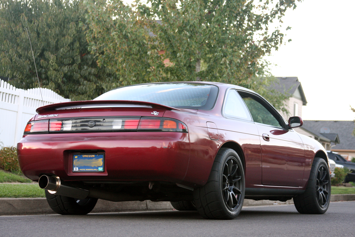

Other than the exhaust, the wheels and tires are literally the very first modification on my new project car, so you’ll have to excuse the monster truck status for now! It will be getting some suspension love soon…

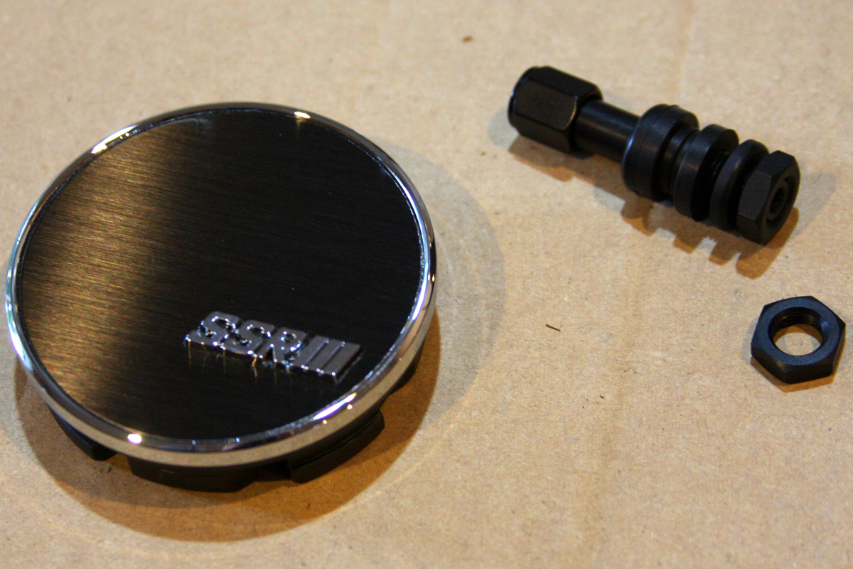

Unlike a lot of wheels, the SSRs come with center caps and nice anodized aluminum valve stems with matching SSR caps! Something to keep in mind when comparing the cost to other wheels, especially when center caps can cost over $20/each by themselves!

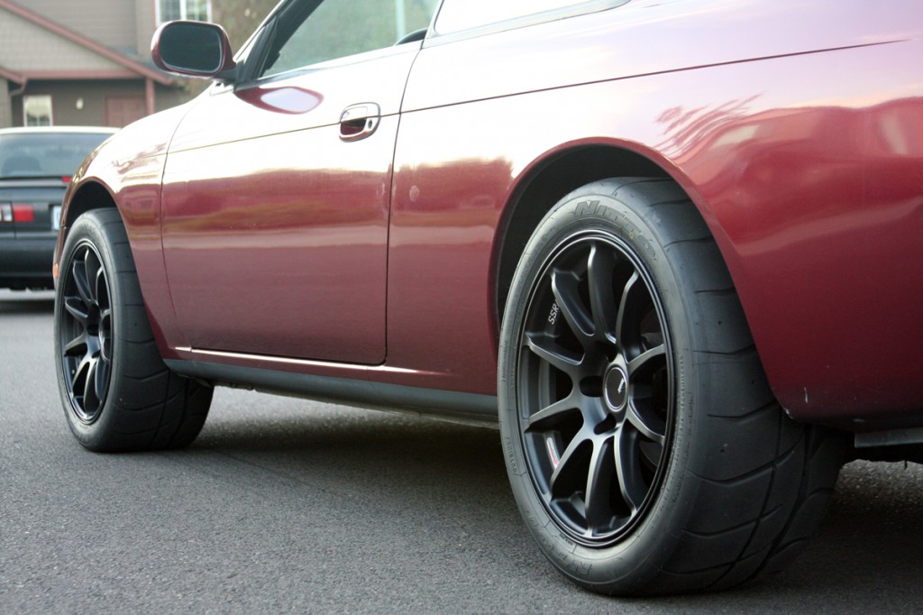

Knowing that this new project car is going to be receiving some solid suspension upgrades as well as the boosted powerplant out of my S13, I decided to fit some sticky, and more importantly, appropriately sized Nitto NT01 DOT legal performance tires in 255/40/17. And when mounted on the new SSRs, they look awesome!
SSR_GTV02_wheels (4)
While the car does need to be lower, the new tires look mean on the new SSRs!

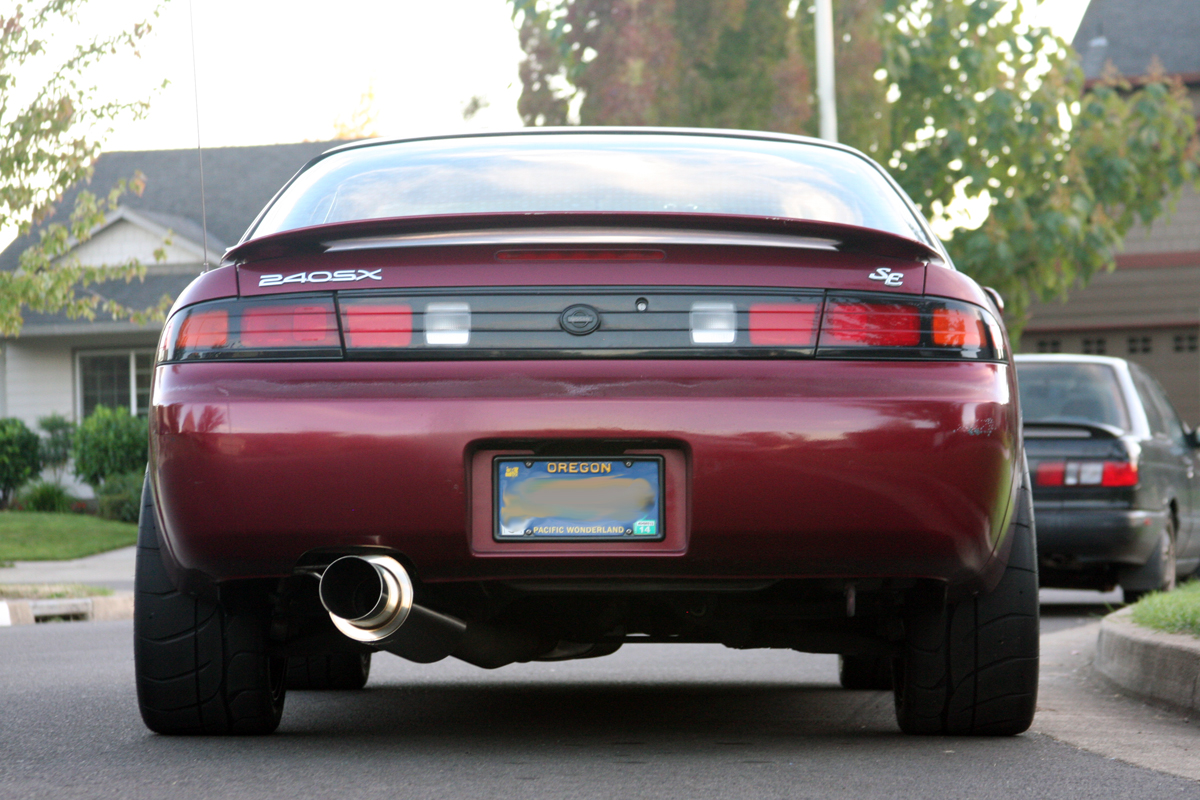

Unlike the popular staggered setups a lot of 240SX enthusiasts run, having a squared wheel and tire combo (same size on all four corners) will help keep understeer in check under hard cornering.

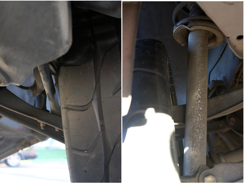

With an OEM style strut, the 17×9 +22 SSRs with 255/40/17 tires will clear the fronts. However, because they are pretty close, I will most likely have to run a small spacer to help clear when I upgrade to a proper coilover setup.
SSR_2
Left: Even at full factory lock, the tires and wheels will clear the suspension.
Right: There is tons of room in the rear of the S14. I shouldn’t have to run any spacers when I upgrade to coilovers.
SSR_GTV02_wheels (10)With factory camber settings, the tires stick out just a hair. However, when lowered and slightly more negative camber properly set for the track, I should have minimal fender rolling if any to clear the factory bodywork.

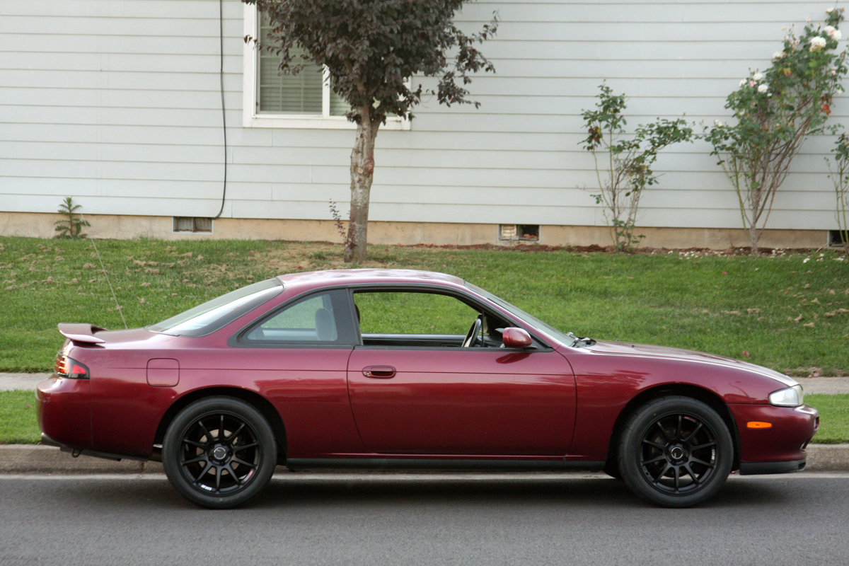

The classic profile shot. I love the color combination of the dark red with black wheels!
