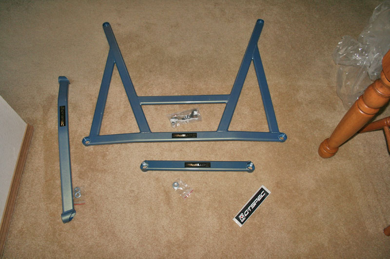

Fast forward one week. I get home from work today, and there is a well-packaged box with some nice looking braces inside. With this shipment, I received the rear lower tie brace, the rear lateral arm brace, and the four point mid chassis reinforcement brace. Now, these are a quad chamber design, they are really lightweight, and to my surprise, extremely strong. There is absolutely no flex or bend to these braces.

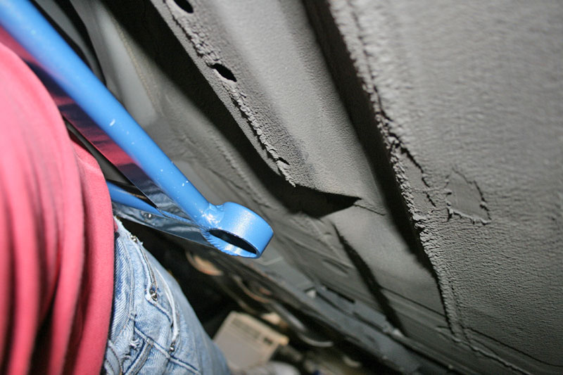

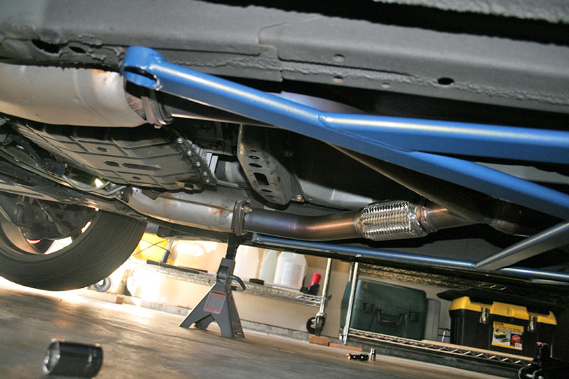

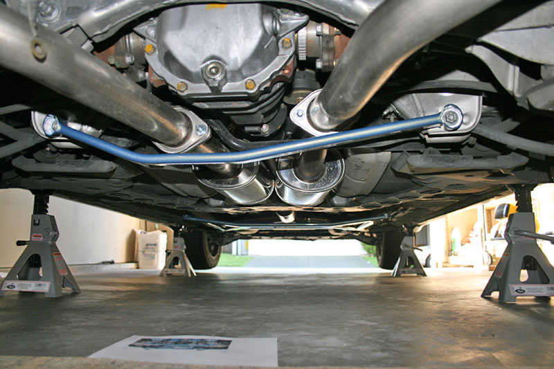

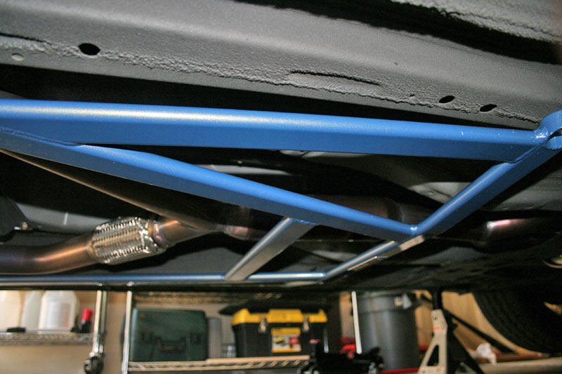

I go outside, and put the G35 up on jack stands. It is rather important that you make sure that the jack stands are the same height, since you don’t want any twist in your frame during installation. I decide to install the four point brace first. I slide the brace underneath the car, and look at the mounting location. Here’s where I was impressed. There is simply no room for error on these mounting points, and GTSPEC nailed them dead on.

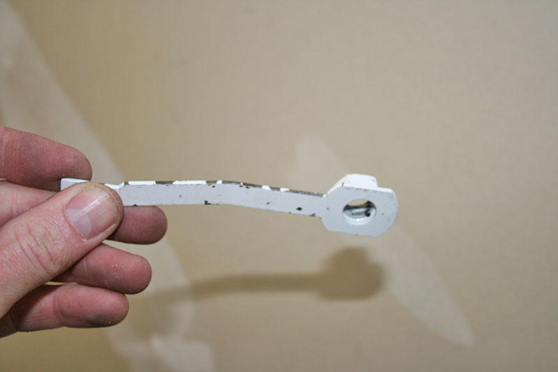

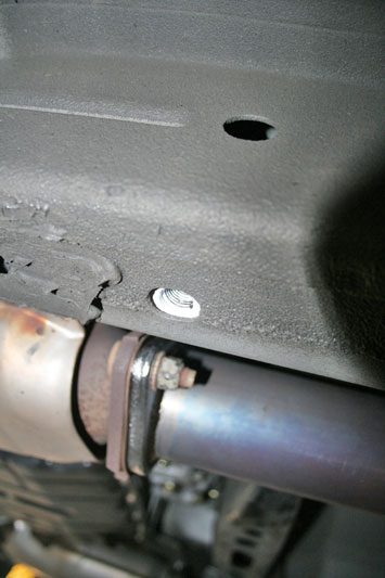

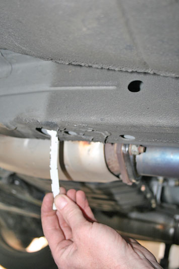

They include a nut that is attached to an odd looking piece of metal. Quickly I realize that it is a handle, so you can push the nut into position easily. Slide the nut and handle (nut first) into the large hole. You can now use your finger and the handle to place the nut directly over the hole.

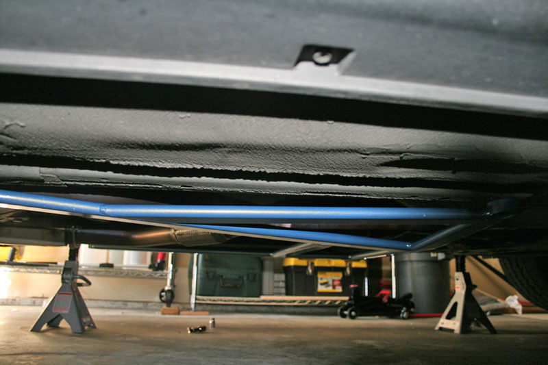

Push the brace up, and using a 19mm socket, attach at this point. Keep all bolts loose for now. Attach the second front bolt the same way. Slide toward the back, and take a 17mm socket, and you will see where these bolts should attach. The bolts are the perfect size, and were plenty hard enough to tap its threads into the sub-frame. One you have all the bolts secure, tighten in a crisscross pattern as if it were a wheel.

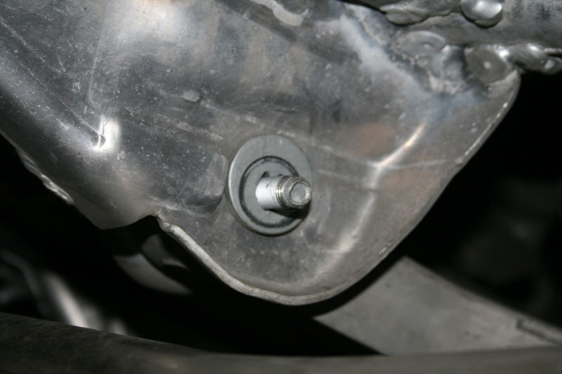

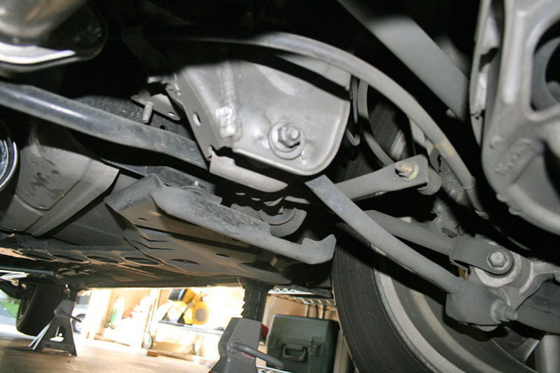

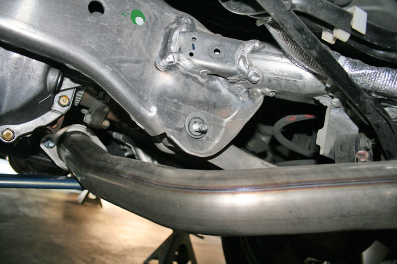

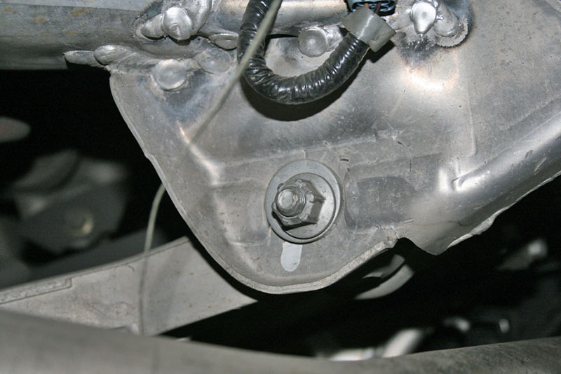

Next up was the lateral arm brace. Take out the 17mm socket and remove the nuts shown on the front lower link. Be careful not to remove the bolts. Once the nuts are off, put the lateral arm brace in place, and tighten the nuts down loosely. Tighten each side a little at a time, until it’s torqued to 72.5 ft/lbs.

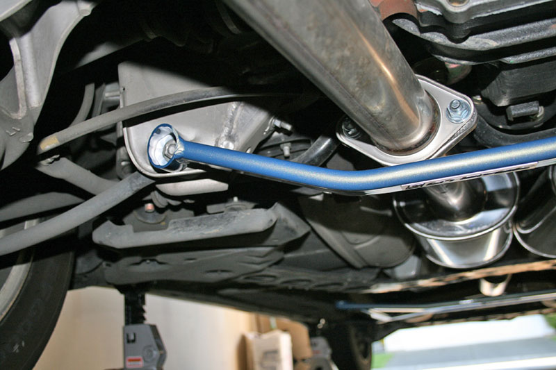

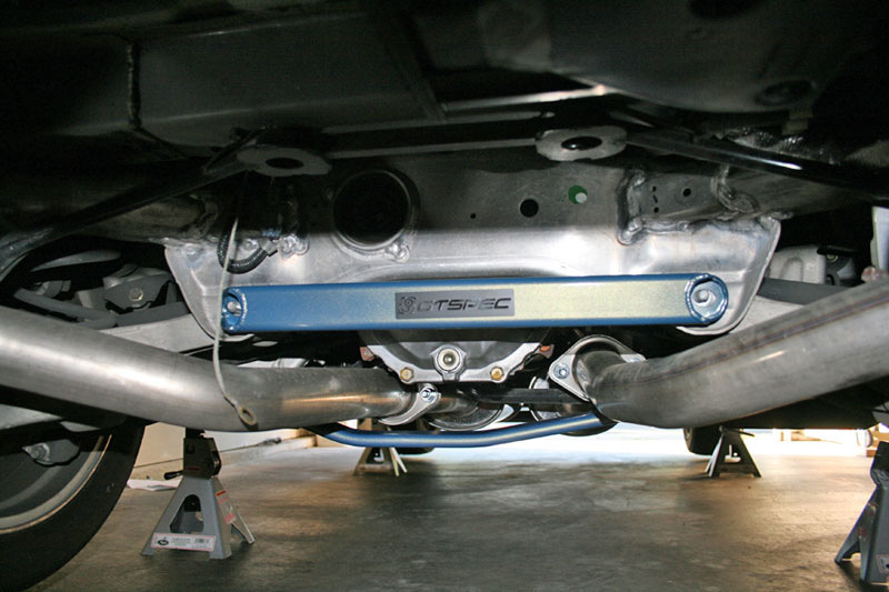

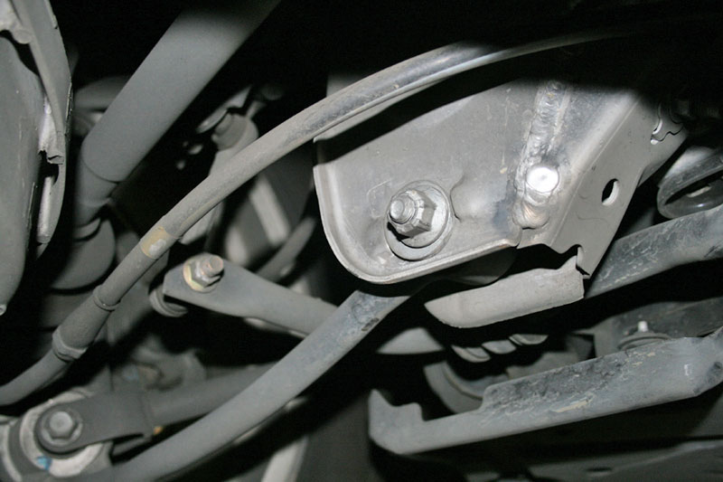

Last up was the rear tie brace. This is similar to putting in the lateral arm brace. Take out the 17mm socket and remove the nuts shown on the rear lower link. Again, be careful not to remove the bolts. Once the nuts are off, put the lateral arm brace in place, and tighten the nuts down loosely. Tighten each side a little at a time, until it’s torqued to 72.5 ft/lbs.
