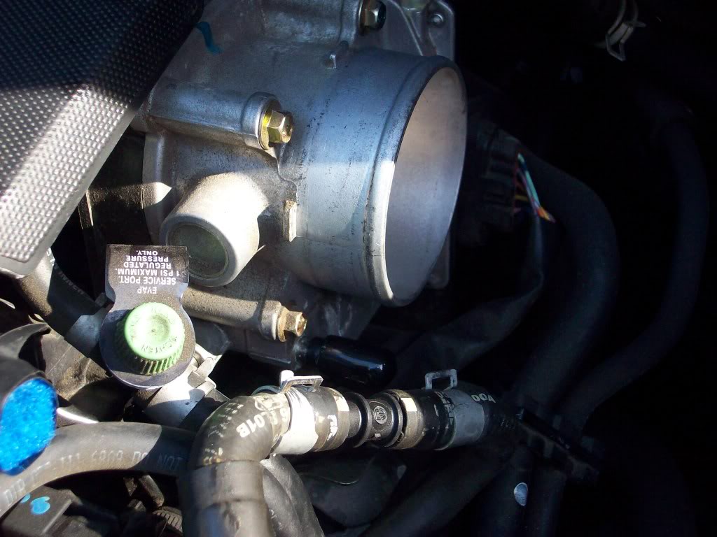

So this is what the line should look like when it’s all done. Use the stock clamps. They are plenty tight.

Step 3 now we are going to connect both lines using our vacuum line connector. The lines should slide on with a little push. Then move the stock clamps over the connector, thus tightening the hose. See first picture.
