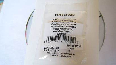

Hillman Push Fasteners “Nissan” #881204 or #881206

1. You can get these fasteners at Lowe’s. I haven’t checked HomeDepot. The ones I used were #881204, they were smaller and smoother but only comes individually. Buy them for a dollar each. The #881206 were bigger and they came in pairs. #881204 left and #881206 right.

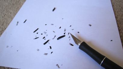

2. I modified these fasteners to fit directly in the dealer’s drilled holes, so no need to bore out these holes. I cut off one of the clips on the fastener with an X-Acto knife to make it flat on one side. I left the other clip alone. I then sliced two remaining sides to make it straight.
