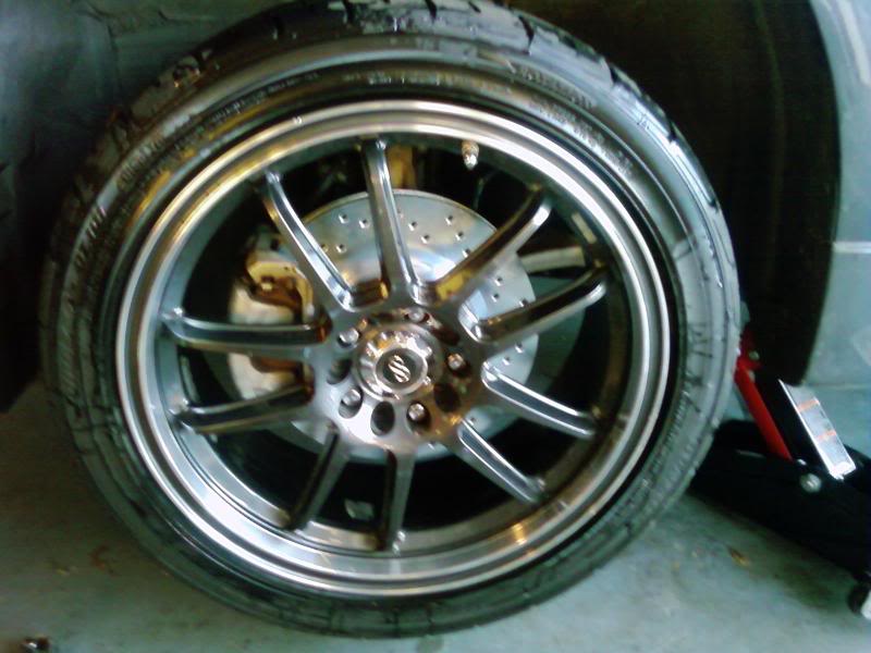

Shiny! Wonder how long it will last?
I also got new brake pads; they came with the rotors during a Stillen sale. I will stick those on once my current ones wear out, I guess.
