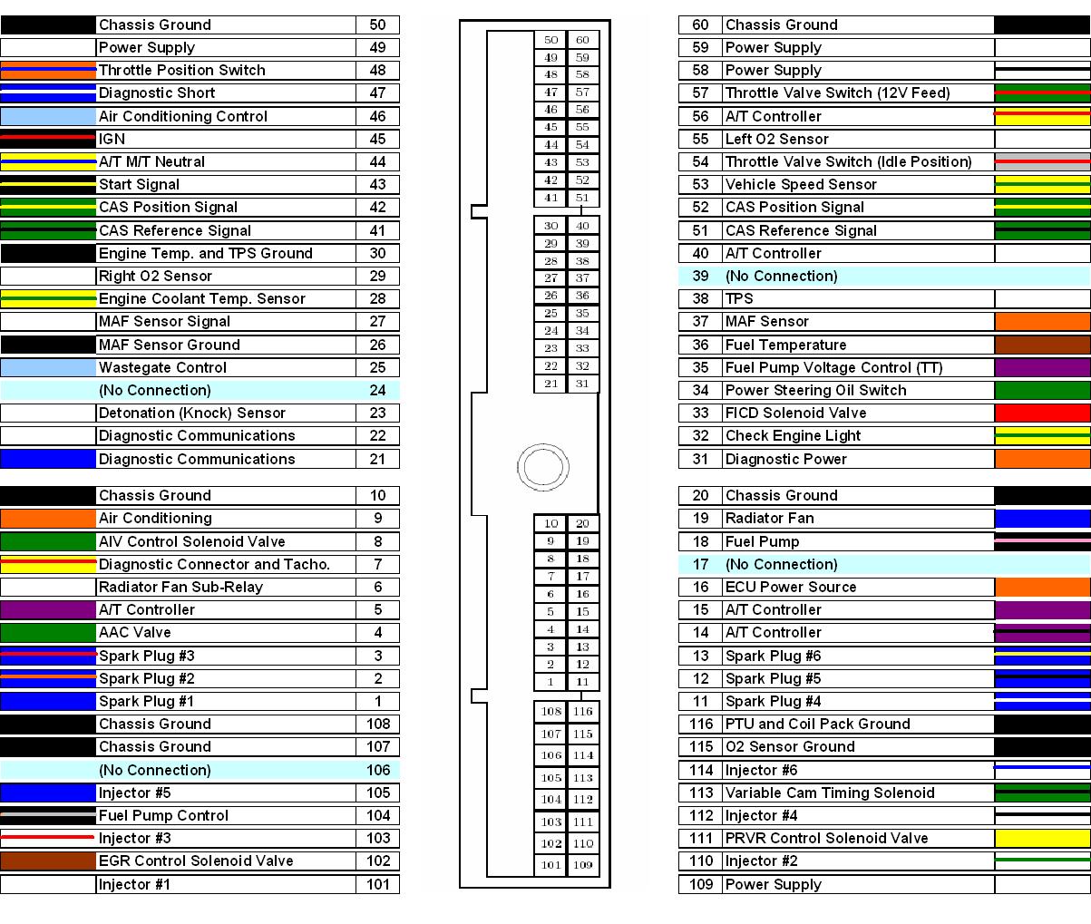

Below is a highly detailed color coded ecu pin out for the Z32’s produced between 1990-95.
Special thanks to Tony for taking the time to make that for everyone to use.
