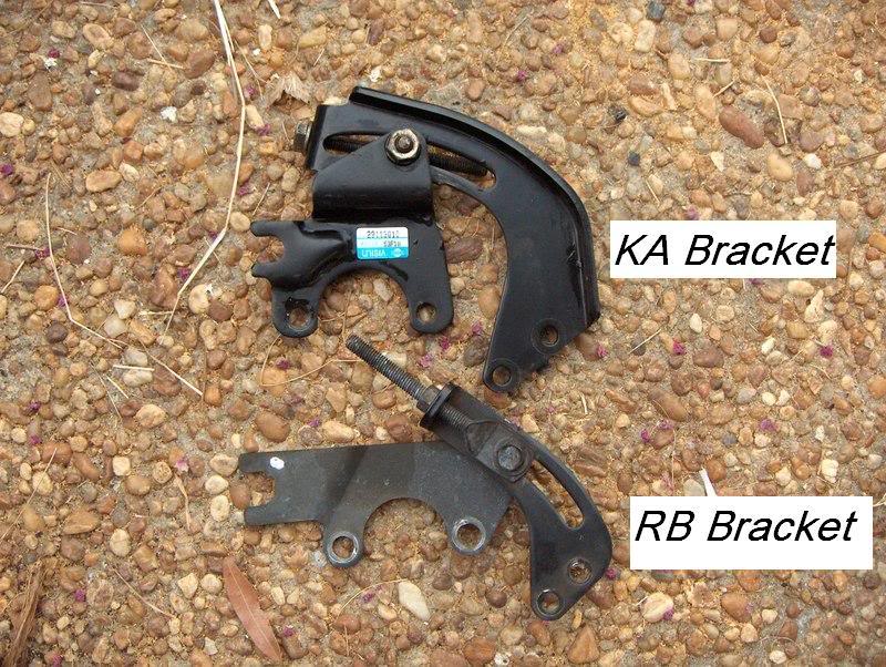

Once the pump is in the bracket you get to the only part that really needs to be modded, the adjustment bracket. And you have two options here, I’ll try to show both but only have pics of the one I chose.
Here is the bracket comparison:
RB25 power steering pump
Option 1: = modifying the RB adjuster bracket to work on the KA pump (must be done if you have A/C , as the KA bracket will hit the A/C Compressor pulley)
In this pic the bottom bracket is the RB and it is the one being modified. You need to cut/grind where the red lines are. The inner diameter of the “U” just barely doesn’t fit over the KA pump so it needs to be ground out. I used a “spur bit” ($3 at any hardware store), and an electric drill, took 5 mins. Bolt the two brackets together and grind until you see no lip. Then hack/cut off the tab above the red line (you are trying to make the bottom bracket resemble the top).

You will be using the KA adjuster bracket on the KA pump, but will still use the RB mounting bracket. Again if you have A/C on your RB you should go with option 1.
The KA adjustment bracket will obviously bolt up to the KA pump but the two bolt holes on the right side (in the pic) are where the adjustment bracket bolts to the mounting bracket. as you can see in the pic (marked in blue and yellow) the two bolt holes on the KA bracket are spaced a little farther apart. So if you were to go with this option you would have to drill/slot the top hole (in this pic) to line up with the hole on the mounting bracket.
And as far as I can tell the only thing else needed would be a longer adjuster bolt, as with this option the bracket needs to be adjusted longer then the stock KA bolt will allow.
