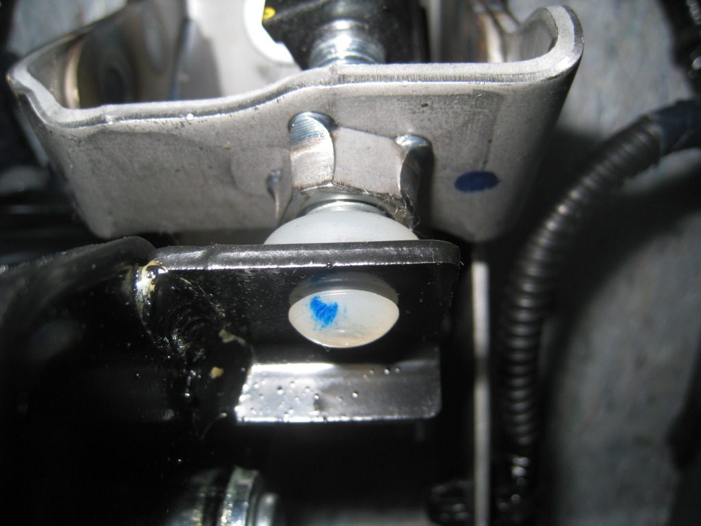

5.) You will not have to worry about the clutch pedal starter switch, but you will have to worry about the cruise control switch. When you move the rod you move the pedal away from the switch and closer to the floor. When you see the pic below of the cruise switch you will see the losing bolt is a PIA to get to. (Its a 12mm as well. the only way I was able to get to it was a small pair of locking pliers to loosen and tighten it. I was not able to get a wrench in there.) You can test if you need to adjust this by driving the car and seeing if you can set the cruise control. If not then you will need to adjust this. You will want to unplug the switch and then after the bold is loose screw the switch down until its in complete contact with the clutch pedal, and reassemble

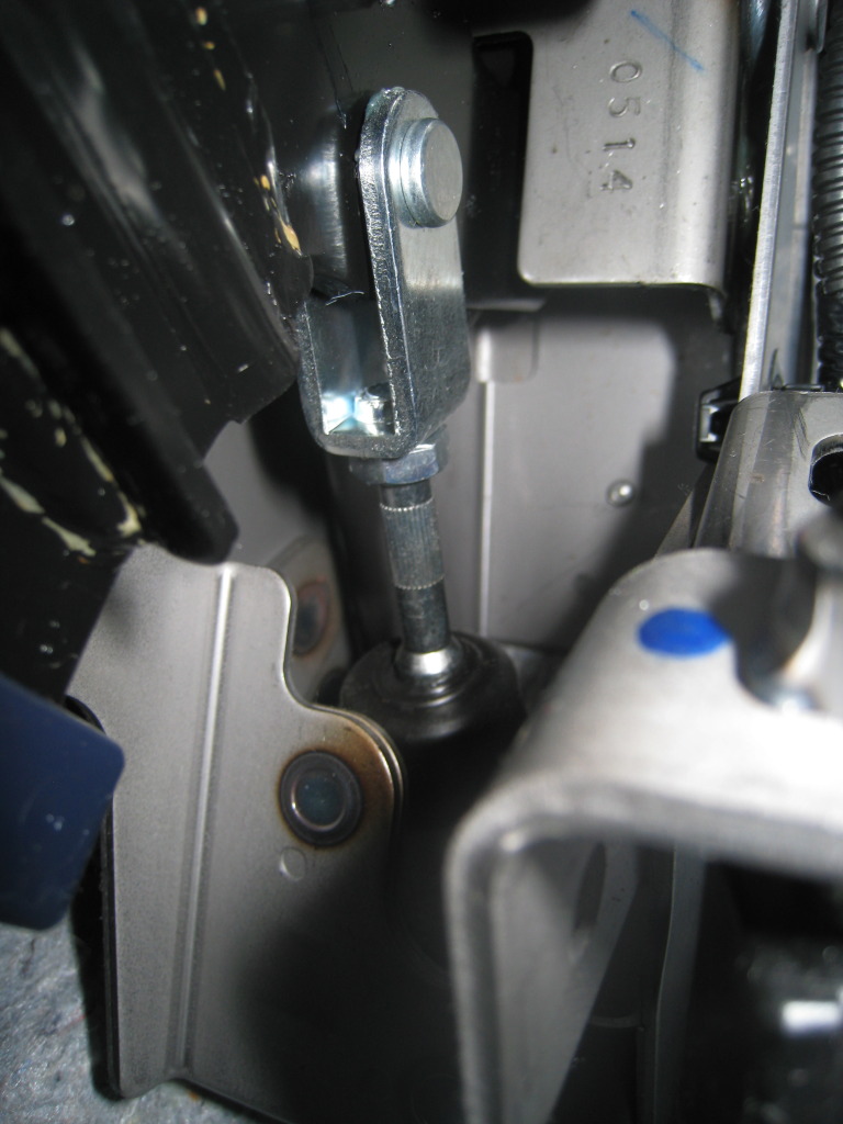

This pic shows the clutch pedal start switch right in the middle. To the left is the fork and rod in discussion. The order of the rod mechanism is from right to left… black boot, rod, bolt(one you need to loosen), fork, and clutch pedal.
Better pic of the rod mechanism

Next pic is a closeup between the clutch pedal and the cruise switch. This will open up when you screw in the rod. Enough to open the switch depending on how much adjustment you do.
