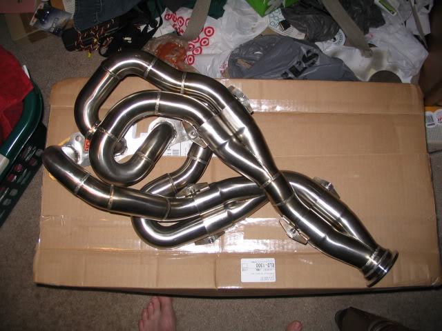

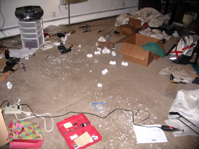

Impressed yet? No? I purposely left out the exhaust system. It’s here that Dave truly stepped away from the pack. Unhappy with the current header he was using, an off-the-shelf OBX unit, he went on the long and arduous quest of designing his own custom equal-length header. When I found out he designed his own equal length manifold, I was floored, considering that I had my hands full welding together a simple log manifold. True equal-length headers are no joke. Dave decided to pay Burns Stainless for their proprietary program and recommendations for an initial assist, as he had no experience with flow dynamics. Think that’s easy? It ain’t. Knowing that he wasn’t going to be able to do the fabrication himself, he contacted a company called Stainless Headers Manufacturing and they provided Dave with a kit that he could use to mock up his own header. So that’s exactly what he did. Using the software from Burns Stainless and the kit from Stainless Headers, he set about constructing his own header, in his apartment, with basic tools and a boatload of trial and error.

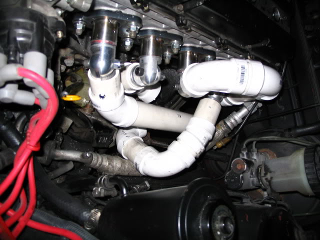

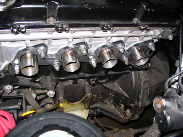

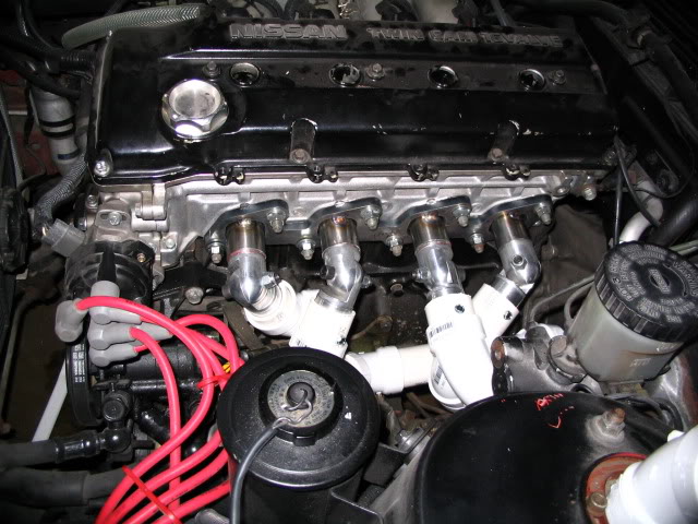

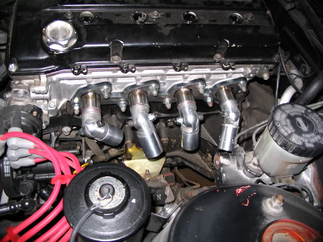

The process of creating your own equal length manifold is quite involved, especially if you’re not doing any of the welding. In this case it involves making a mock up manifold out of PVC and specialized elbow joints in order to connect everything together. With a 4 cylinder motor there are 2 basic types of header. The 4-1, which merges all 4 exhaust runners into one collector and the 4-2-1 which merges the runners 1-3 together and 2-4 together, before they merge into one single collector. Dave initially wanted to go with a 4-1, but he was space limited and settled for a 4-2-1. Here are a few images that show the parts and the process involved. You can see the Stainless Headers Mfg flange and adjustable fittings for runner mock up.
exhaust012 exhaust017
You combine the flange and adapters with pieces of PVC that you measure and cut yourself.
exhaust088 exhaust138 exhaust027 exhaust029

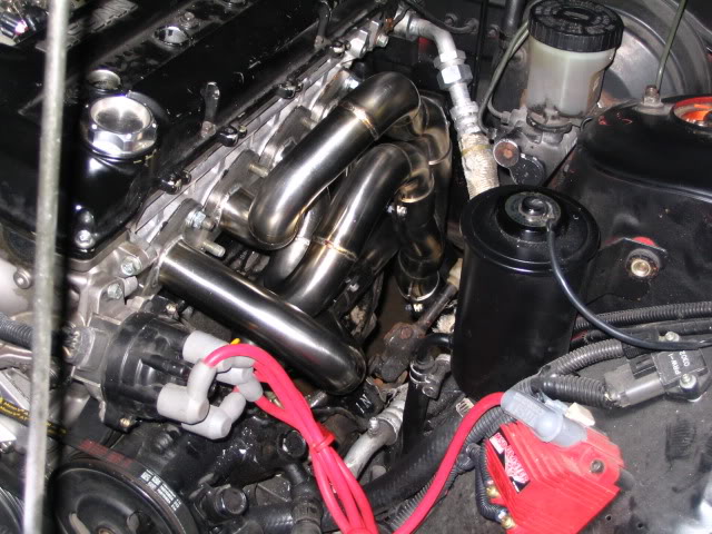

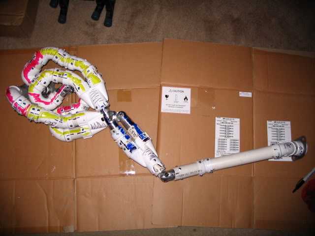

After completely rebuilding and redesigning the entire header 3 different times, he was able to come up with this. What a work of art!
exhaust002-1 exhaust151
Before the custom header, Dave’s KA maxed dyno’ed at 176 HP and 165 ft lbs of torque with all of the other mods – an impressive feat, which made for a VERY fun-to-drive S13. After the custom header install he was able to make 202 HP and 176 ft lbs of torque. That’s a 26 HP gain! That may not seem like a lot, but it’s a ton when all you did was replace a cheap Chinese header with a properly-engineered header.
