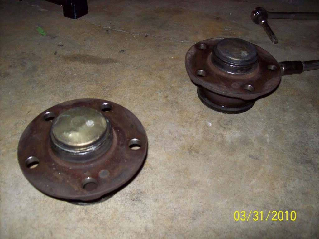

First you have your hub. You don’t have to but can clean it up a little with Brake Parts Cleaner. Once that is done, you will place it on the 2×4 and thread the lug nut onto the studs until the top of the nut is flush with the top of the studs(you can buy a standard lug nut for a dollar from Auto Zone). From here, you just swing the hammer and ensure that they are completely removed.
After that is done, they will look like this…

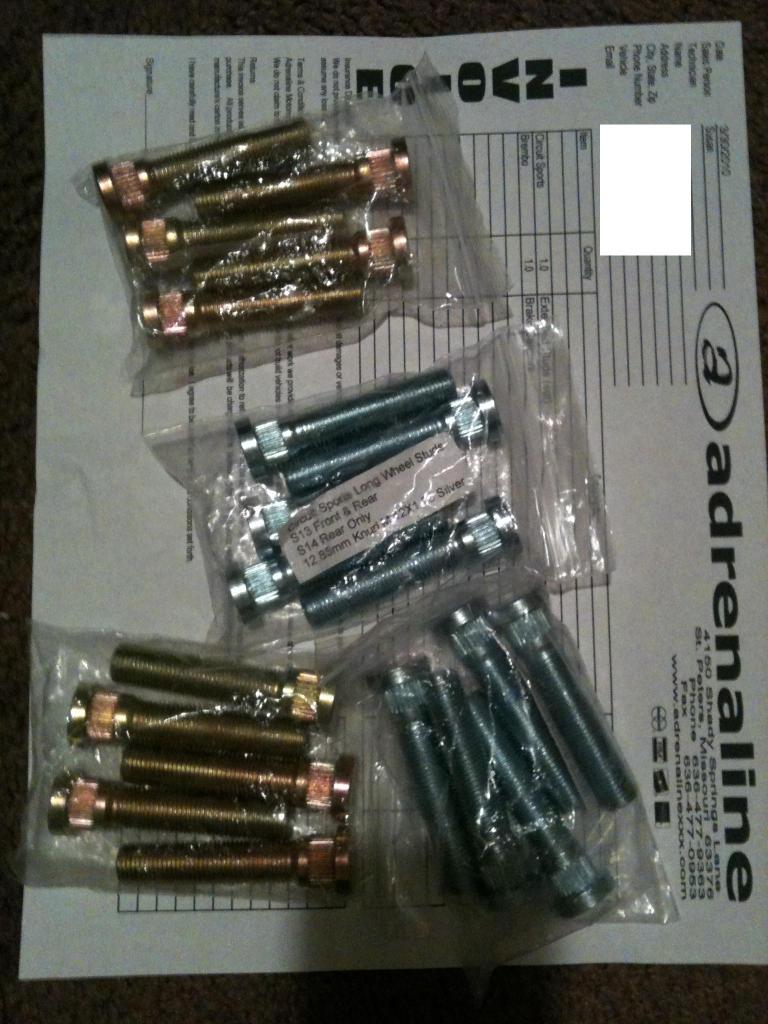

From this point, you will have the hubs ready to receive their new parts. I went with Circuit sports 60mm Extended studs.

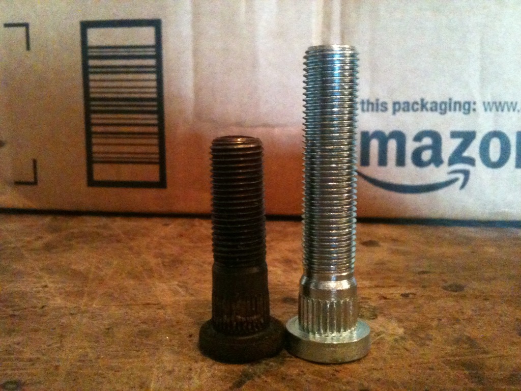

This is a comparison of the old and new studs.
