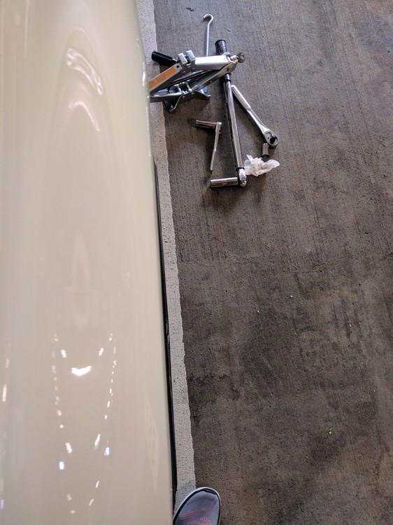

Safety check, parking brake on, flat surface blah blah blah…
If you can change a tire you can install spacers. Preferably use a lift if you have the option.
