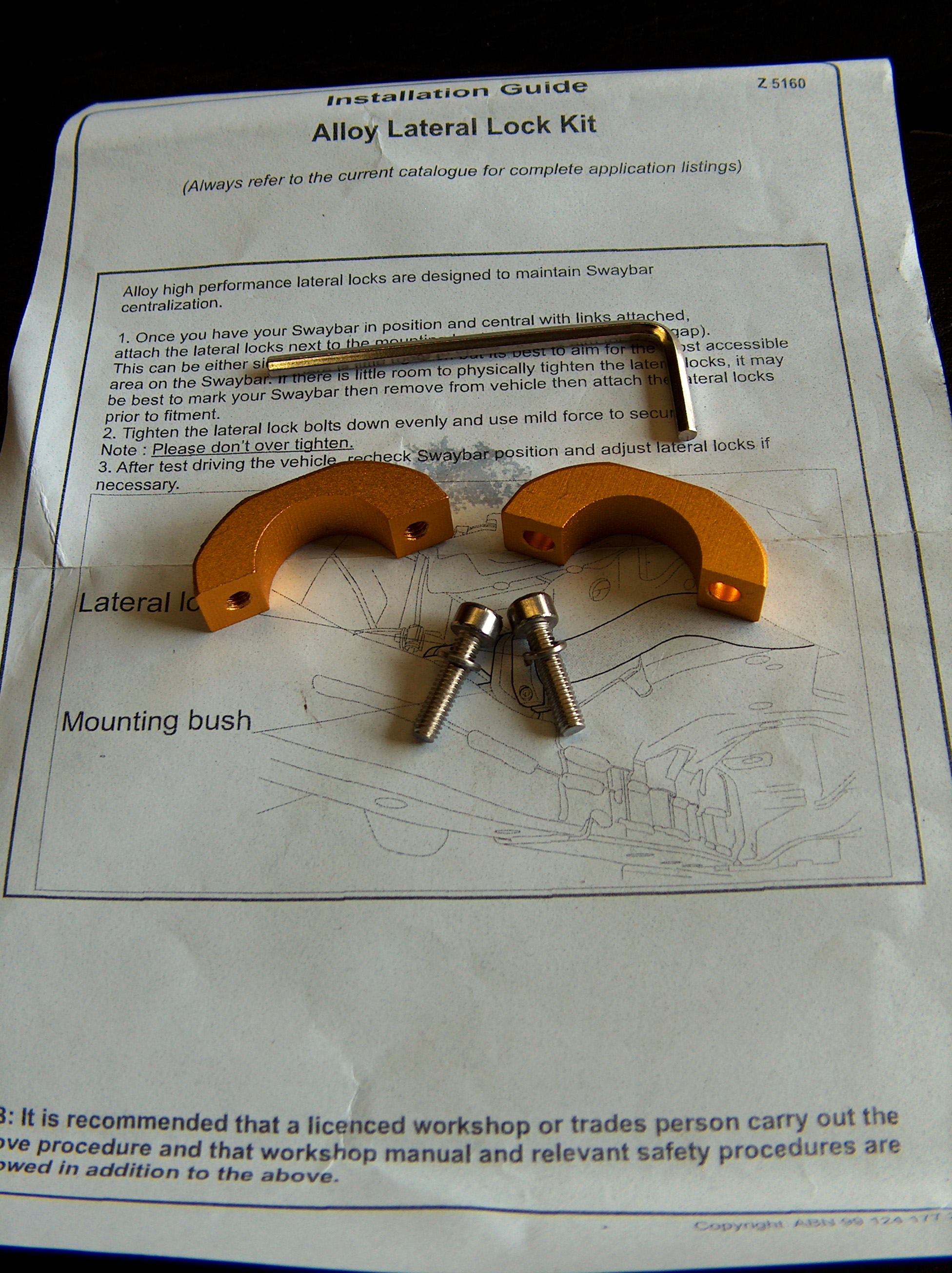

Packaging
Contents (Includes Stainless Hardware Too!!)

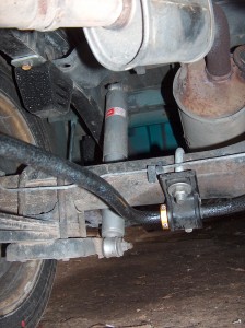

At first I thought I would install the locks on the inside of the bushing mount but since my rear sway bar is not perfectly symmetrical I found it wasn’t seated correctly on the passenger side.

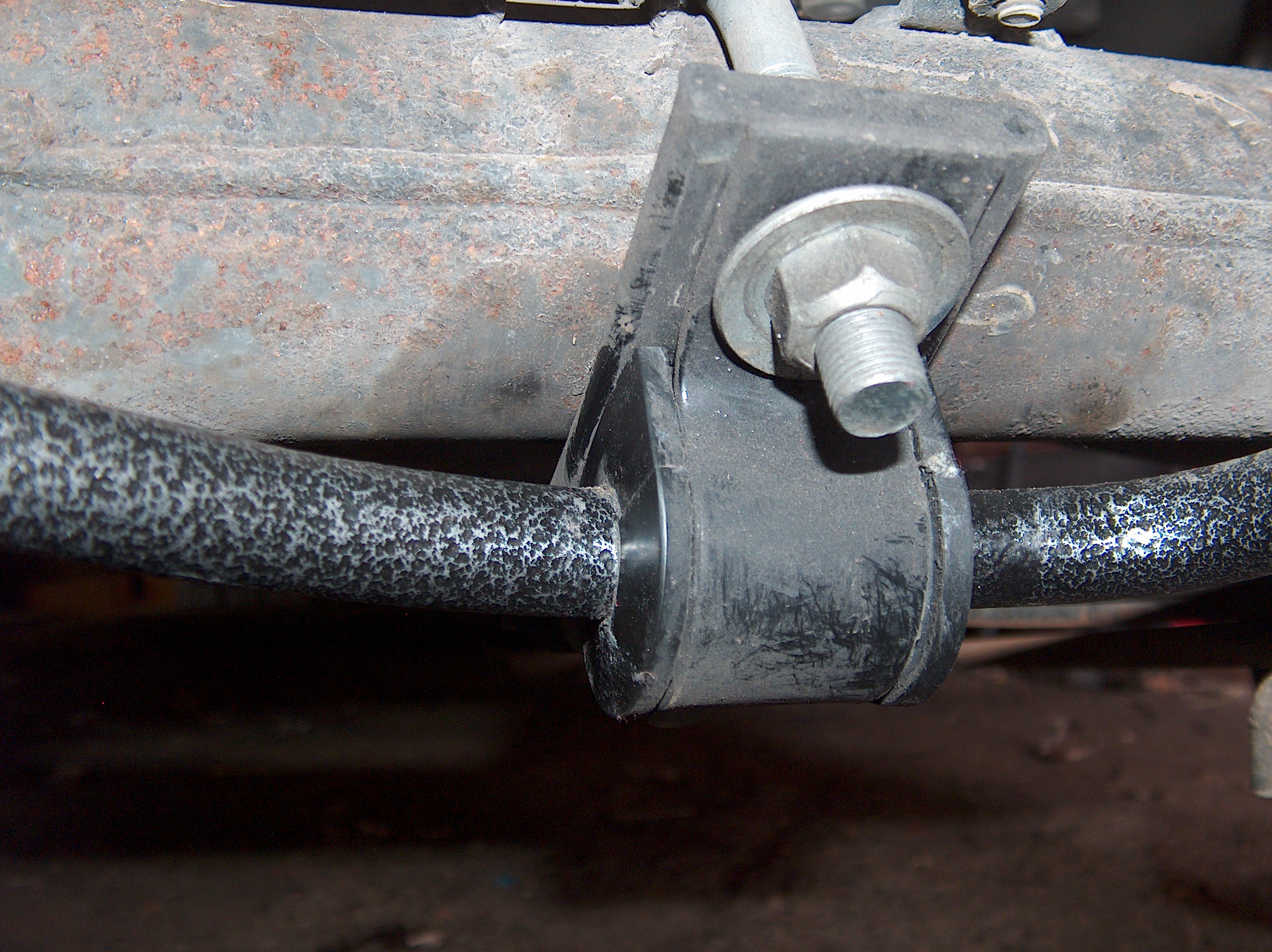

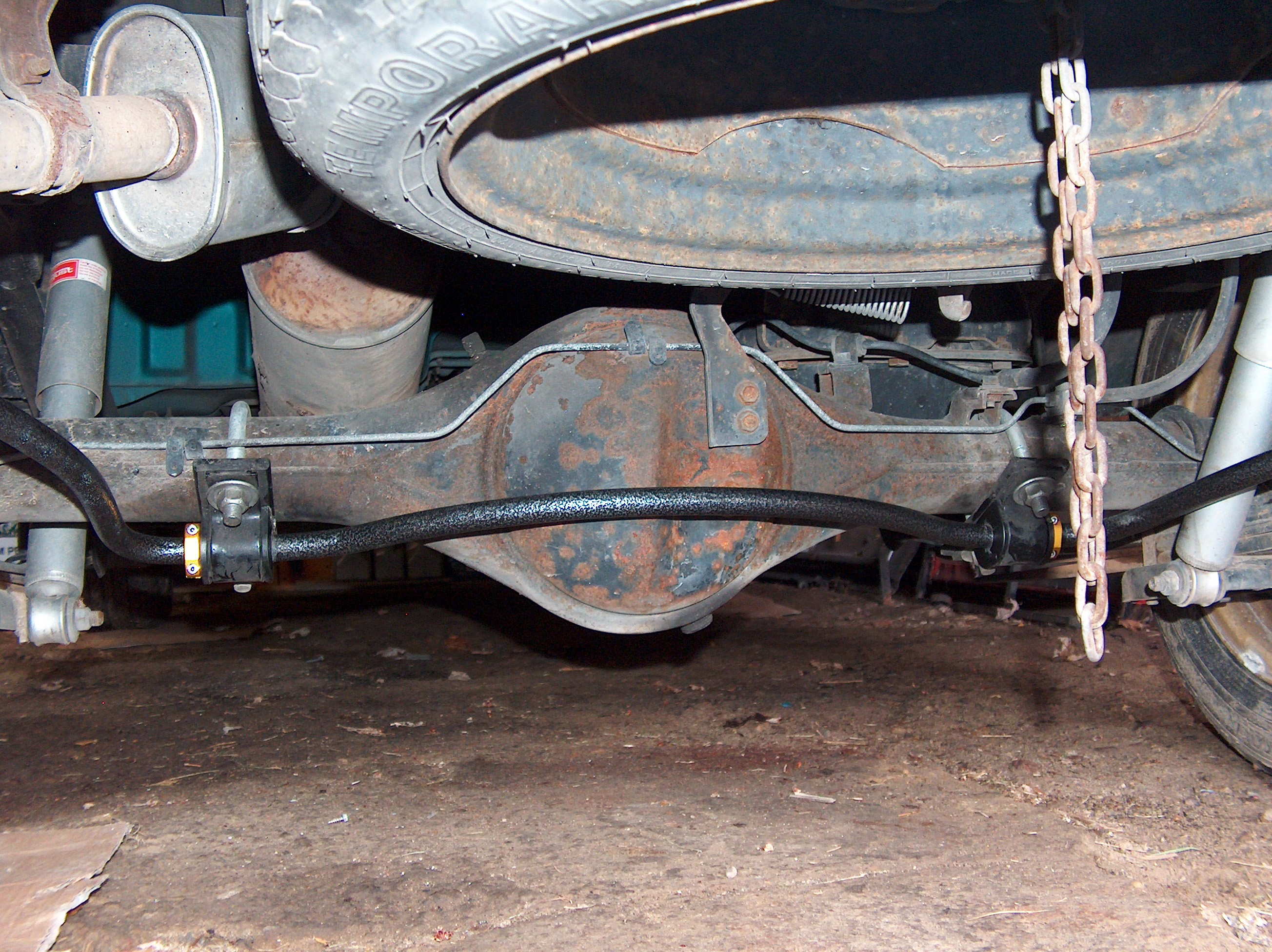

Bar Mount Before Install
Bar Mount After Install (As you can see in this pic it’s not lining up with the bushing face to my liking.)

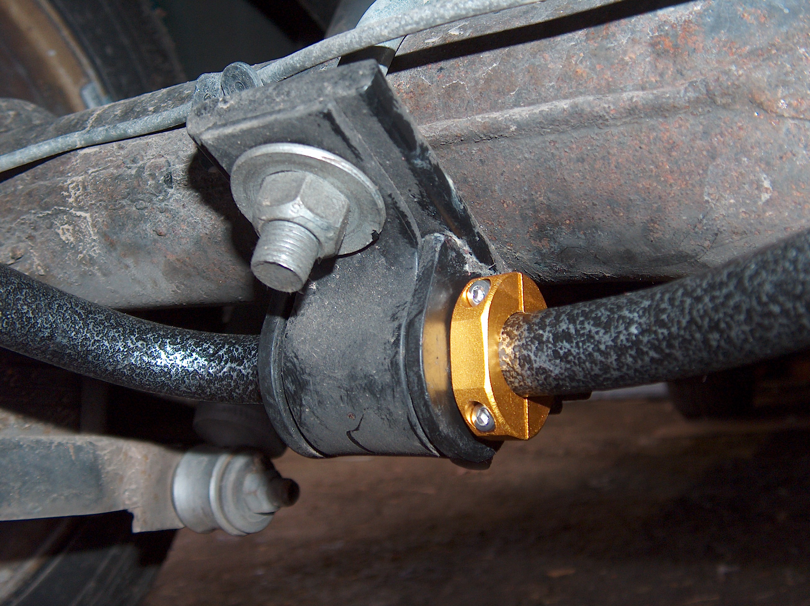

Redux
I decided to place the locks on the outside of the bar mounts which allowed them to seat better. The concept still applies with the locks on the outside of the mounts and fitment was flush.
Left Side
Right Side
Complete Installed Look
Do not over tighten these!!! The instructions say they may need to be slightly adjusted after a short test drive. I have not driven the truck since I installed these because a bad storm just passed through here but be sure to look for review updates in the Nissan Truck Forum soon. I don’t expect major handling changes, just some peace of mind that my rear sway bar is where it is supposed to be at all times.
