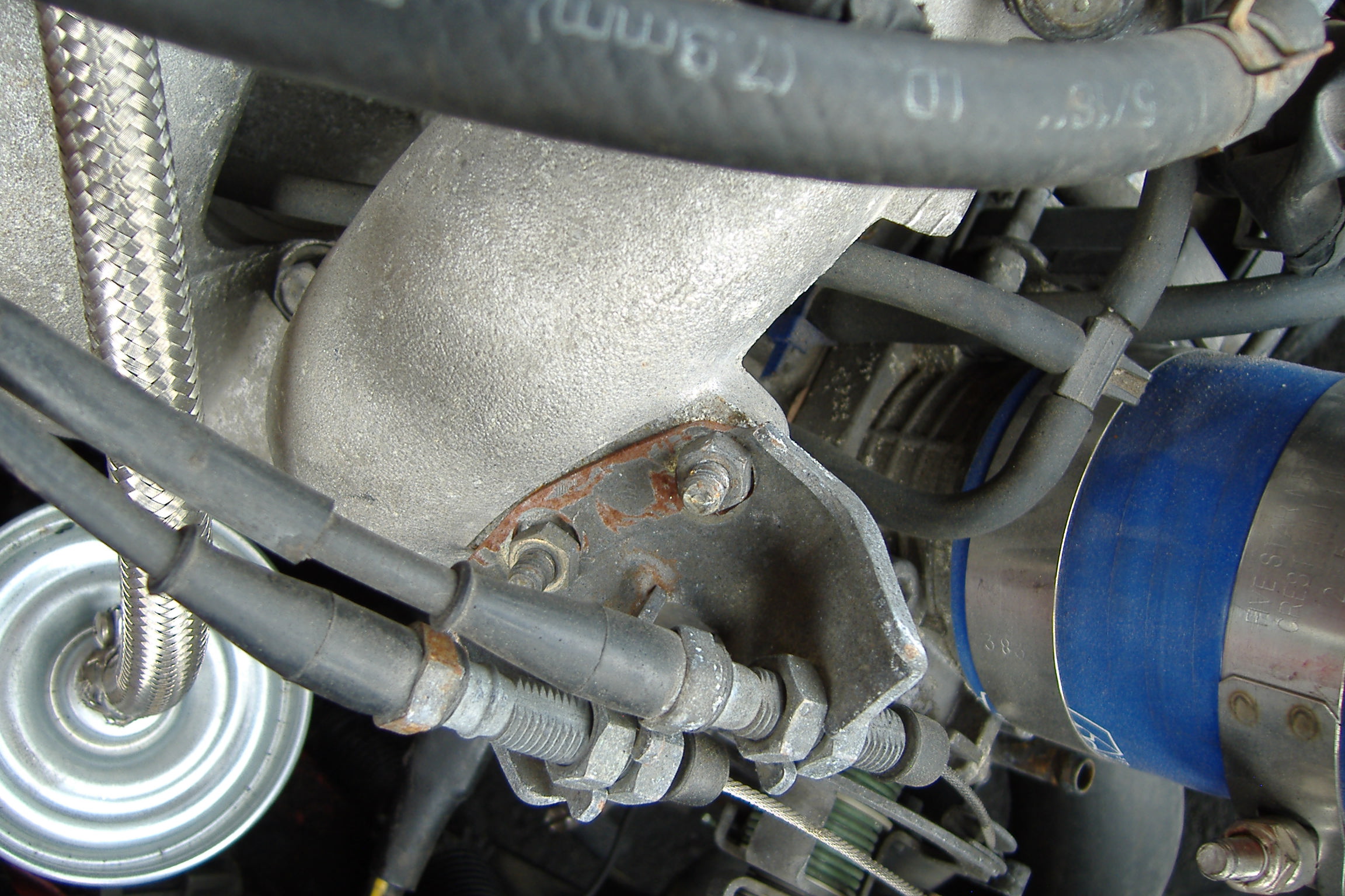

First things first, swap over the throttle body from your old KA onto the SR. Next, there are two different ways you could go. What seems like the easiest is to use the KA throttle cable bracket as well since it can accommodate both the throttle and cruise control cables.
You will need to first drill out the holes in the bracket a little. You must also grind off the back of the bracket. This is so you can position the bracket in such a way that the cables aren’t pulling crooked when opening the throttle.
Here is the KA bracket after I modified it to work.
