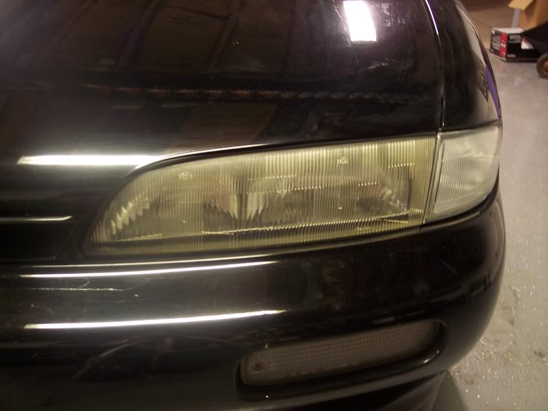

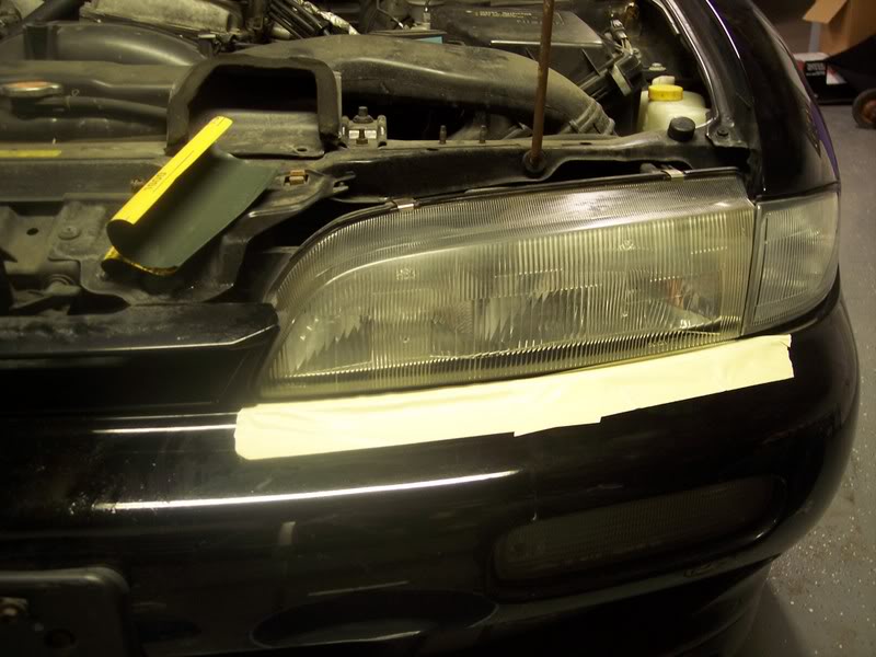

Headlight before starting this process:

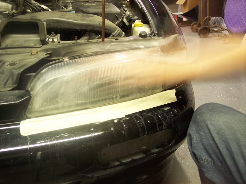

1: Clean the headlight with Windex or any window cleaner
2:: Tape off the bumper

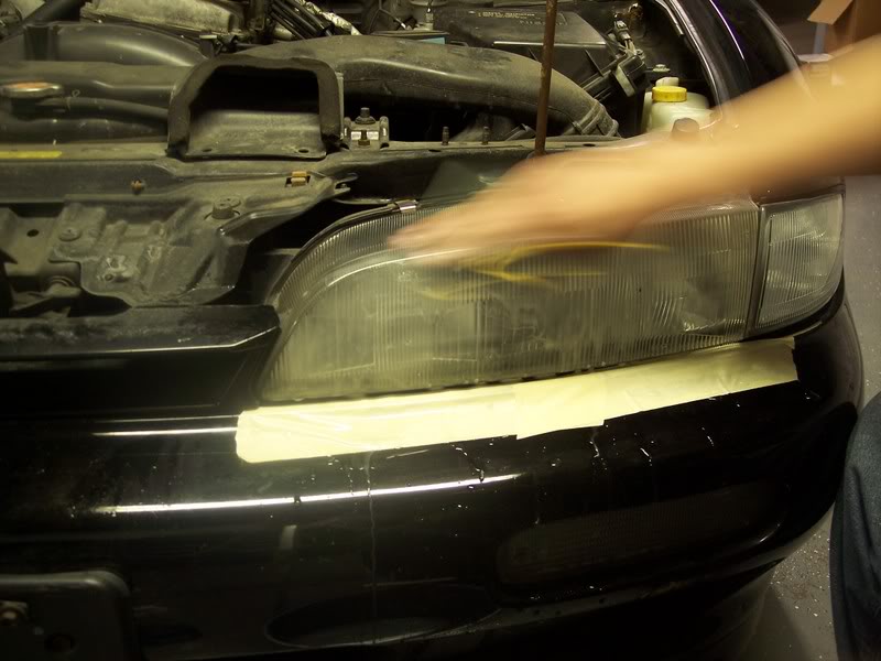

3: Wet headlight with water

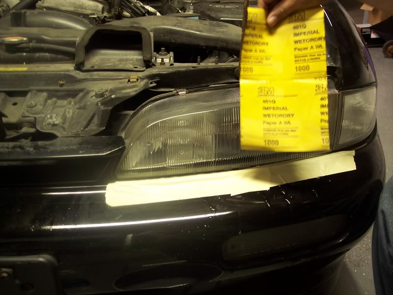

4: Wetsand with a grit right around 800-1000.
Note:Make sure you dip the sand paper in water to keep the headlight wet when sanding.
Note:The more white residue you see the better. that means that you are taking off the top layer of yellow stuff.

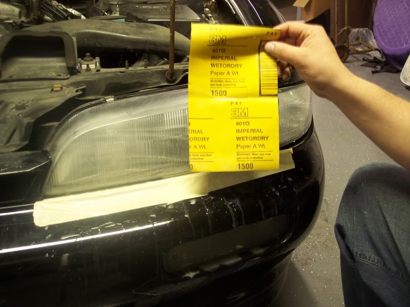

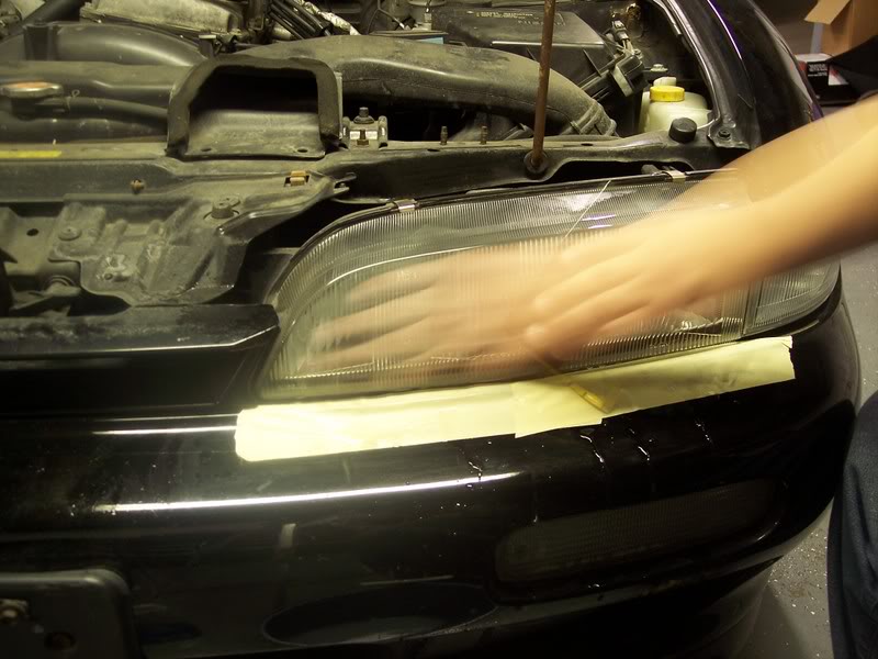

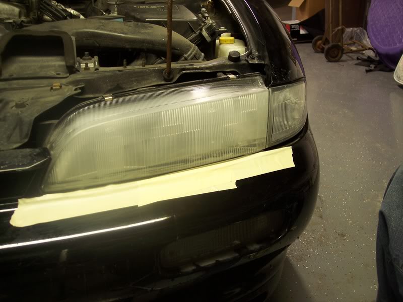

5: Switch sand paper with a 1500+ grit and sand just like you did the last one.
Note:This step is going to smooth out the headlight a bit. the more you sand the better it will turn out.

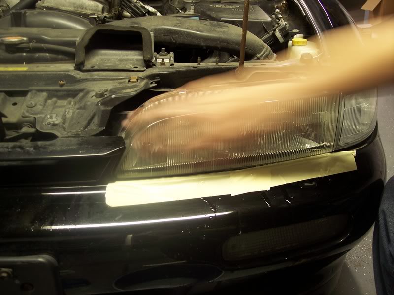

6: Let it dry or dry it off. It will look very hazy but that’s ok.

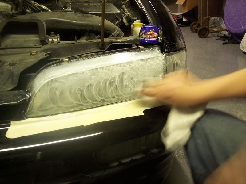

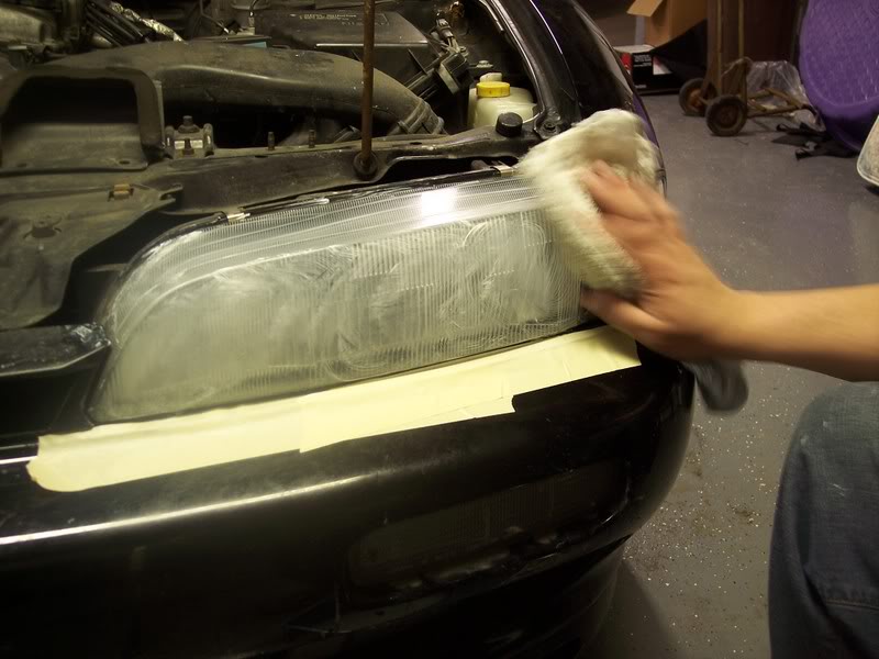

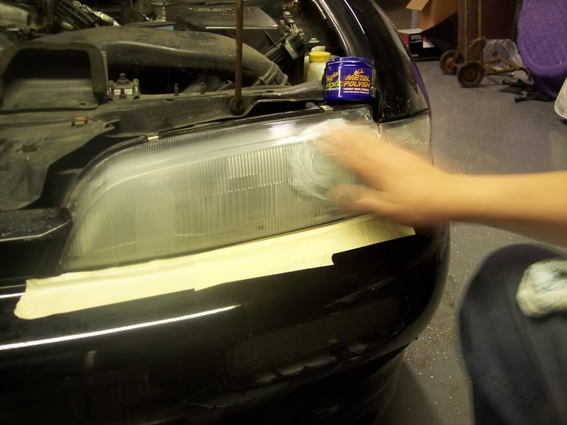

7: Get some Meguiars Metal polish or any other polish it ,whatever you prefer. Rub the polish onto the headlight.
8: Use a Terry Cloth towel and rub on the polish.
Note: The longer and harder you polish the better the shine will be.
9: When the polish dries use the a clean microfiber towel to rub off.The harder and faster again the better the shine.

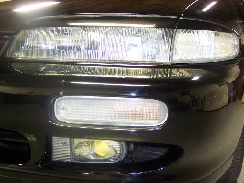

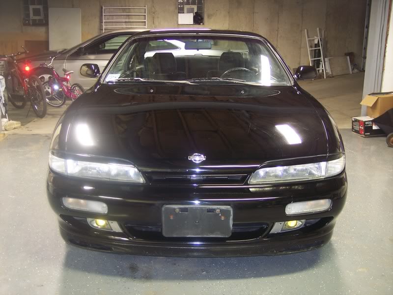

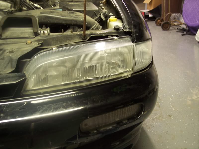

Step 10:Finished Product
Note:Now if you do this you can use a Buffer for better results. I didn’t use a buffer for this because everyone doesn’t have one. But in the next pic I did use the buffer for my final polish. I also put a eyelid on it.
UPDATE: The following show results after utilizing a buffer (I added eyelids afterward)
