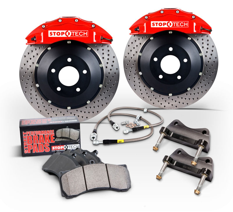

To solve this problem many owners invest in BBKs (Big Brake Kits).   Most front big brake kits consist of aftermarket 4 to 6 piston calipers and big 320mm+ rotors.  They are usually lightweight aluminum calipers and light two-piece rotors.  They provide excellent cooling capacity, great feel, and great stopping power.  Once you’ve invested the $2000+ initial cost, they are inexpensive to maintain as you’ll only need to replace the outer rotor and pads .  BBK’s are a great investment for the FRS/BRZ and if you can afford them, I highly recommend buying a professional kit from Wilwood, RB Performance, Stoptech, AP Racing, etc..

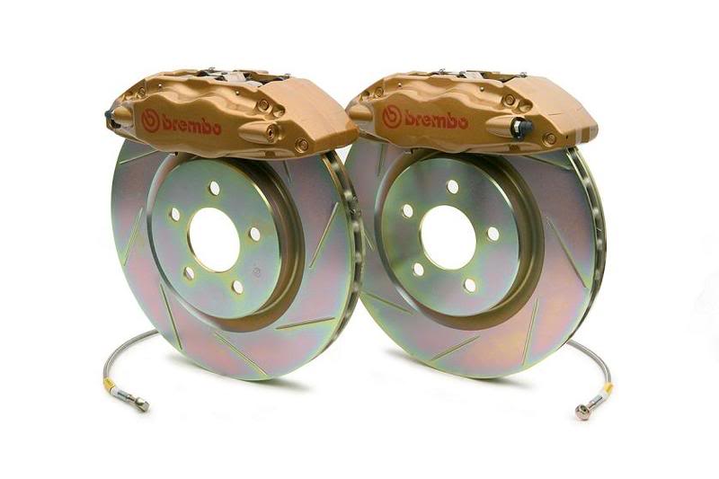

Another option for brake upgrade is the stock WRX-STI Brembo setup.  The calipers from 04 to current will all fit directly onto the ft86 (with a swap of the bleeders) and the rotors from the 2004 STI’s were 5×100, so those are a direct fit as well.  These are excellent upgrades and slightly cheaper alternative to the aftermarket BBK’s.   However, be prepared to shell out some big money.  You’ll spend on average about $1200-$1500 on used STI Brembo calipers.

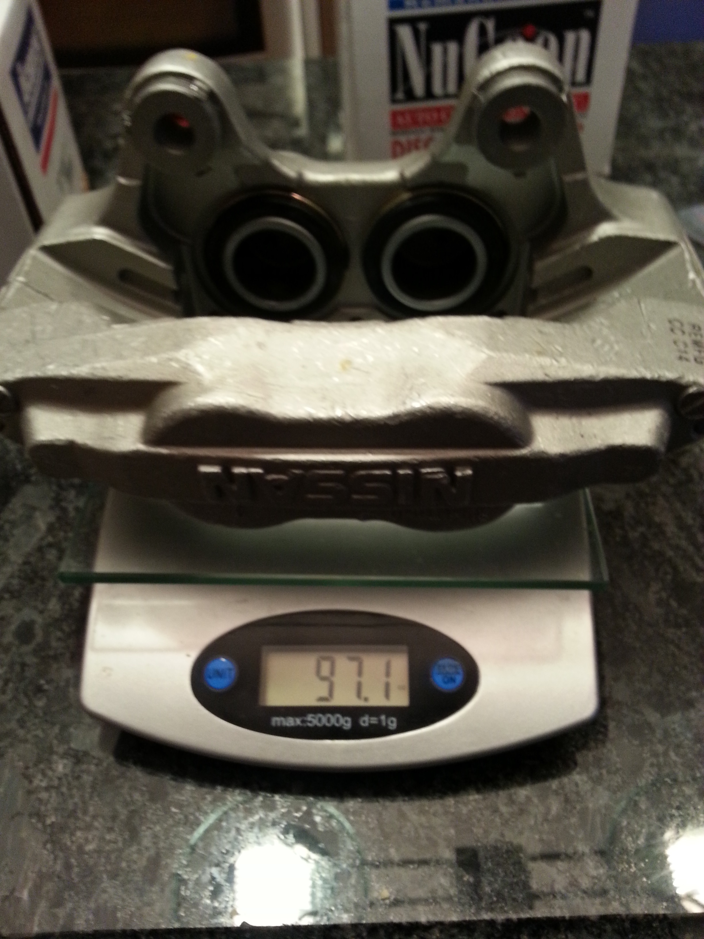

Calipers:   The Z32 was made from 1990 to 1996.  The best calipers for this conversion are the aluminum 30mm calipers from 1991-1992.5.   They weigh in at 6.1lbs each and save nearly 8lbs off the stock BRZ calipers and brackets.  The iron calipers also work and are a bit easier to find and a bit cheaper to buy, but weigh more (11.1lbs) than the aluminum calipers.   Make sure you get 30mm calipers.    For more details on how to tell the differences, see this page:    http://importnut.net/300zxbrakeswap.htm
20140619_21132097.1 oz = 6.1 lbs

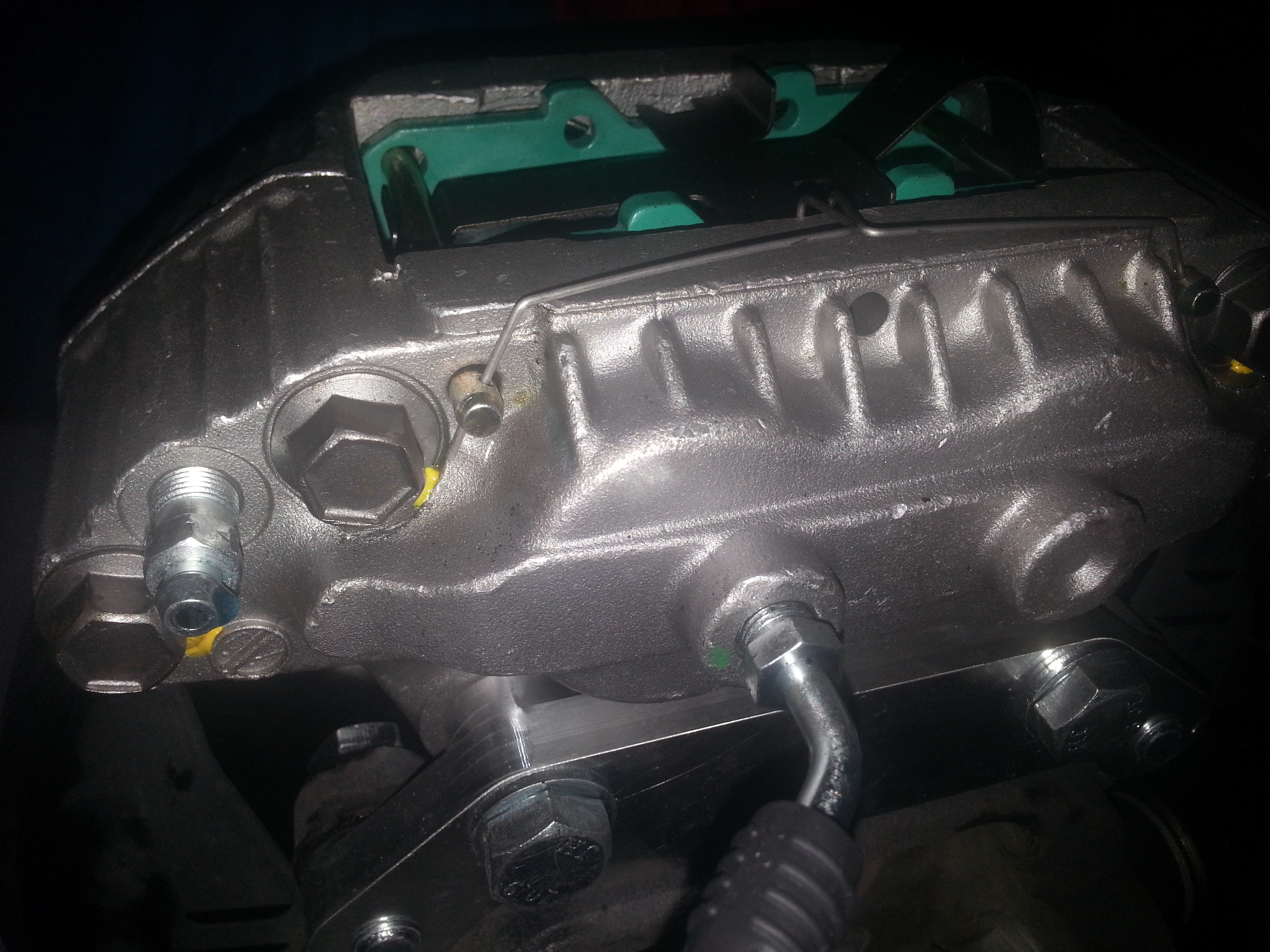

Brackets:  To allow the Z32 calipers to fit on this application you need these brackets from KNS Racing.  300ZX to BRZ/FRS Front Caliper Adapter Brackets
See the brackets and calipers attached at the bottom of this picture:
20140714_194858

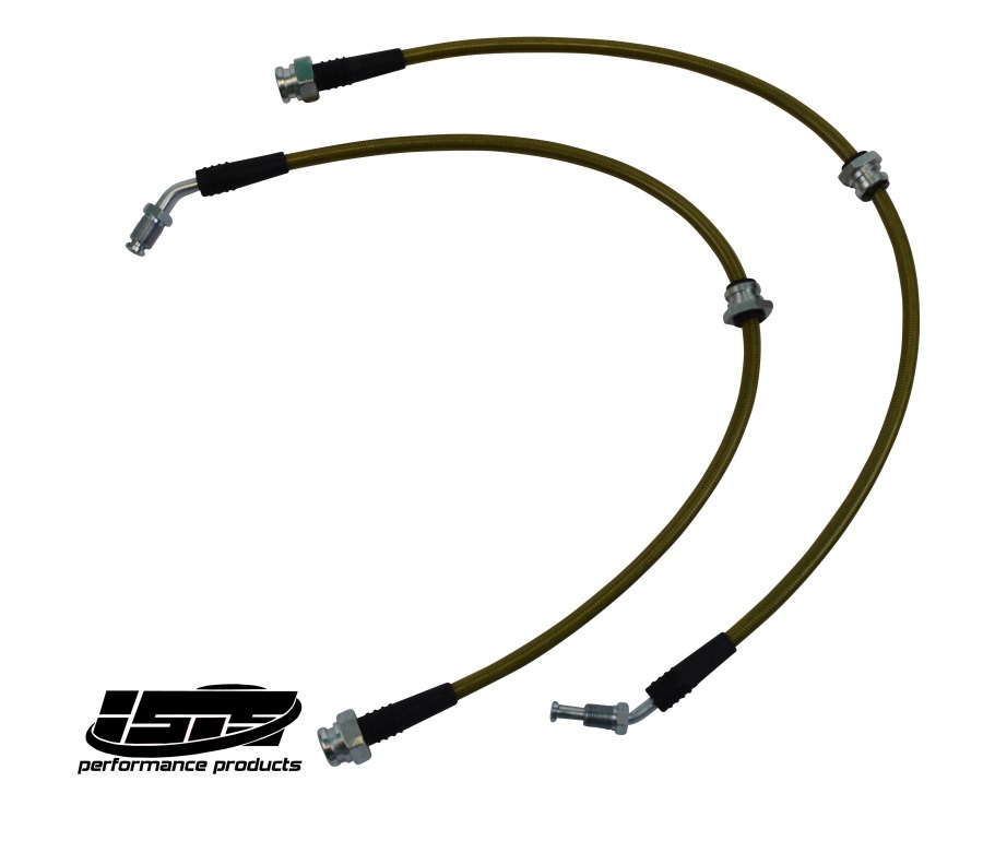

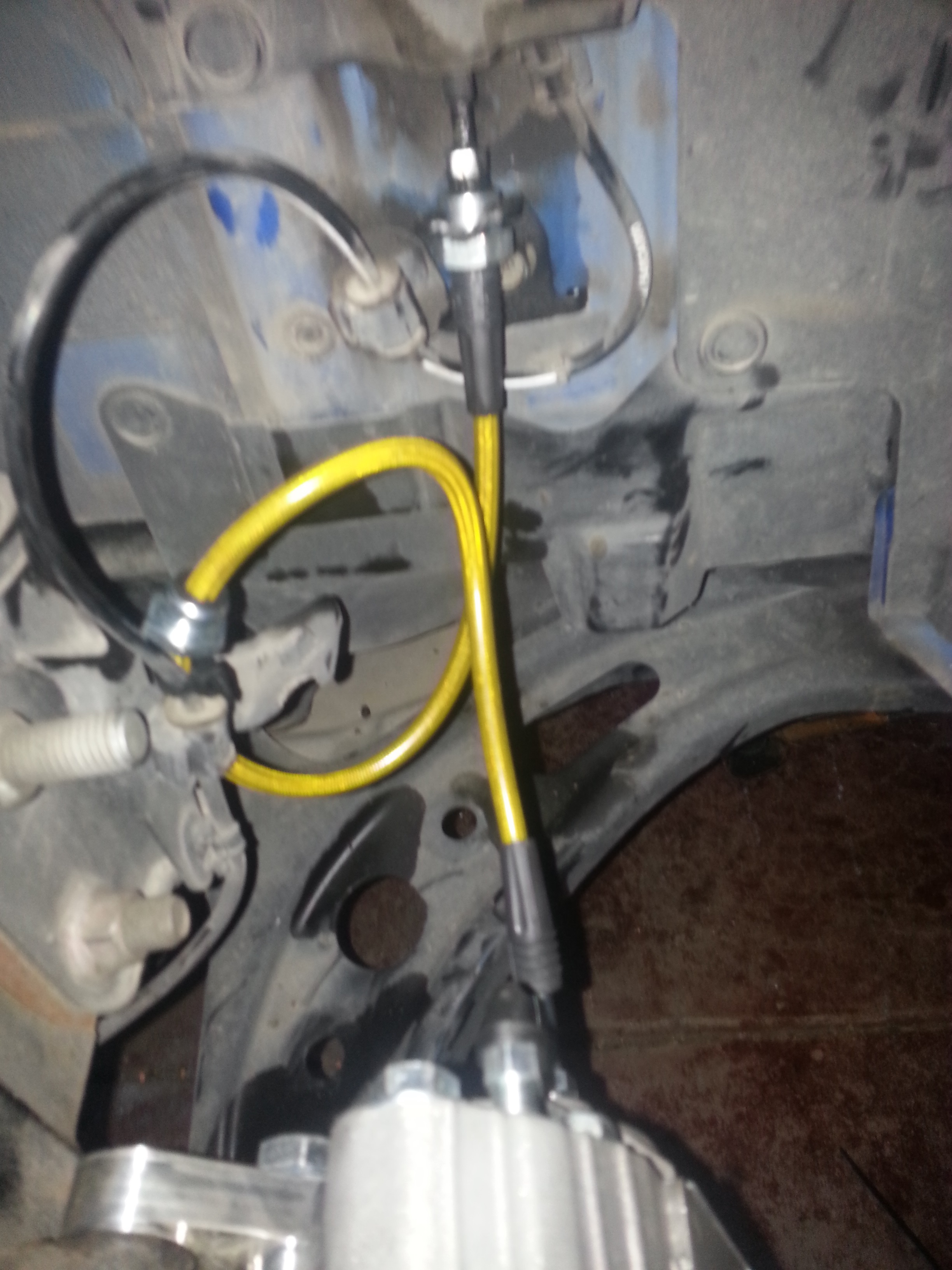

Lines:  You will need to convert your lines for this upgrade.  The brake lines that I chose for this are for 240sx to 300zx conversions.  These lines have the correct fittings to the hardlines at the top and the correct fittings for the Z32 calipers at the bottom.  I went with the Isis lines from Enjuku Racing.   These Isis lines have a really nice fitting at the caliper so that you can screw them into the caliper and then adjust the angle at which you want the line to come out prior to tightening them down.  Plus they are only $50.   Ken is a long-time NICO sponsor and provides excellent service and even more excellent pricing.   Enjuku Racing
Notice the fitting at the bottom on the right.. it allows you to easily adjust the angle of that line before final tightening.
