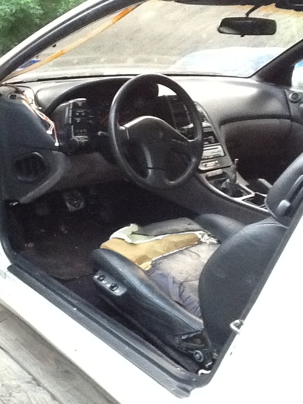

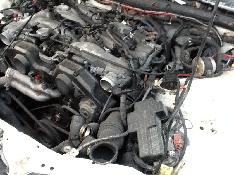

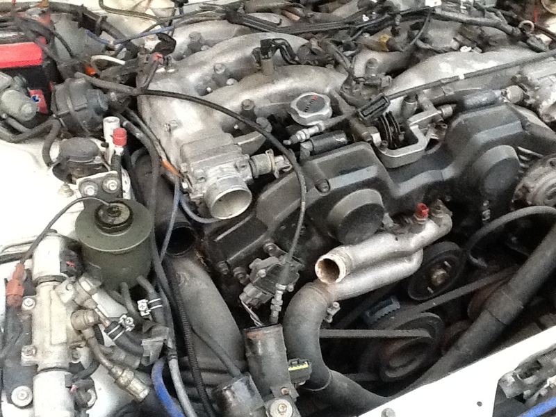

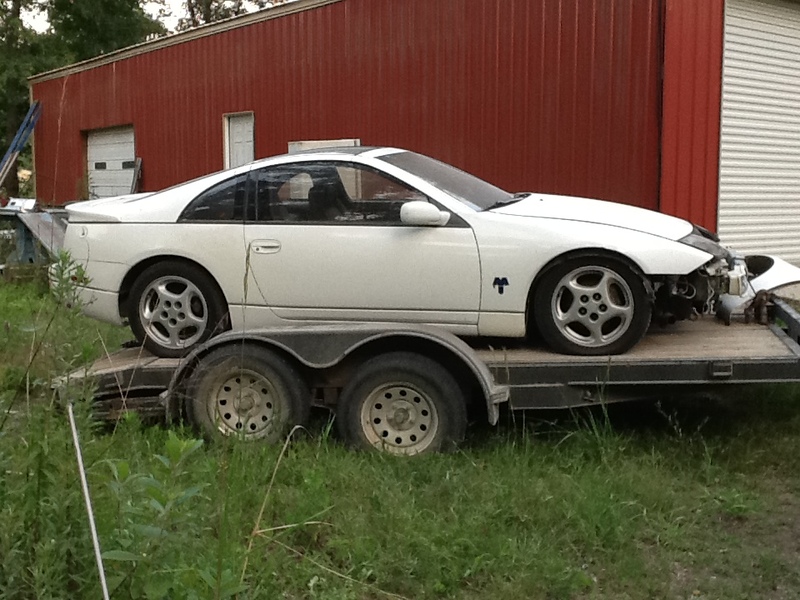

After about 6 months of looking around where I live in Florida, I ended up finding one 3 miles away from my father’s house in Louisiana while there on a visit. It had been sitting for 2 years with a cracked block, interior taken apart, but I saw the potential and purchased it for $1,000. Here are some pics of the day I put it on the trailer.
300ZX_TT_003 300ZX_TT_002 300ZX_TT_004 300ZX_TT_005
I think the images speak for themselves – There was much work to do, but I was up to the task. I found I had a few bonuses in it: JWT Genie Turbo Exhaust, JWT Pop Charger, KYB AGX Adjustable Struts, Blitz Turbo Timer, Dual SBC Blitz boost controller, Cometic Intercooler Piping, Nismo oil cap, and Stillen adjustable RUCAS. At the time, I knew nothing about the car, so ensued a couple months of reading and researching while removing and disassembling the motor.

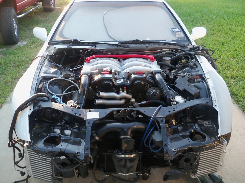

I planned on doing everything myself minus the machine work. I eventually found a donor motor in Miami that I tore down, had the block bored to fit 88mm Wiseco Pistons, heads checked, etc. It was like Christmas when I finally got the parts back and could start assembly! I had a lot of parts ready to go, here is a list:
-ARP Head Studs
-Nismo 740cc Injectors (first try was with Jecs 550s – I do not advise)
-UR Crank and PS Pulleys
-New Fuel Pump
-Competition Clutch Stage 2
-GSP Intercoolers
-Silicone Boost Hoses
-Selin Translator
-Amsoil oil-less filters and pre filters
-Silicone Radiator Hoses
-Bosch O2 Sensors
-Megan Divorced Downpipes
-Z1 2.5″ Test Pipes
-Ztuner ECU
I also love deleting stuff, so here are the deletes/bypasses I did:
– AIV
– PRVR
– EGR
– PCV Reroute
– Water Bypass
Lastly, here are the maintenance items I purchased and installed:
– Full Gasket Kit
– Oil Pump
– Bosch 02 Sensors
– 120 Timing Kit
– Main/Rod Bearings
– Spark Plugs
– Half Moons
– Alternator
– New Garrett OEM CHRAs (first time I tried to rebuild my turbos myself – I do not advise)

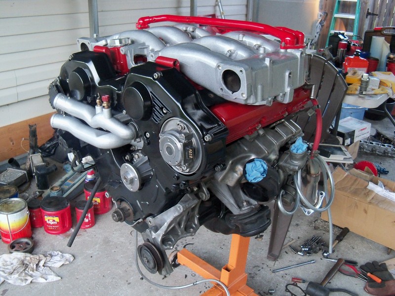

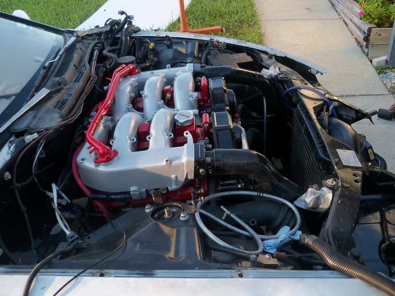

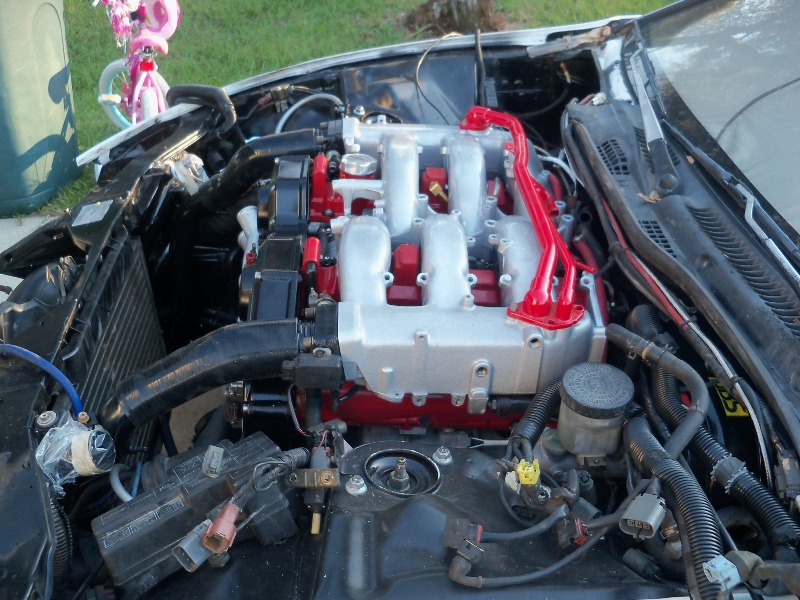

So, with all those parts, I was ready to go! I started building the motor following a great thread I found online on what order to do things and the FSM torque settings close by. After it was all done, here is a few pics of the motor:
Powerplant installed in the car!
300ZX_TT_010 300ZX_TT_008 300ZX_TT_009
