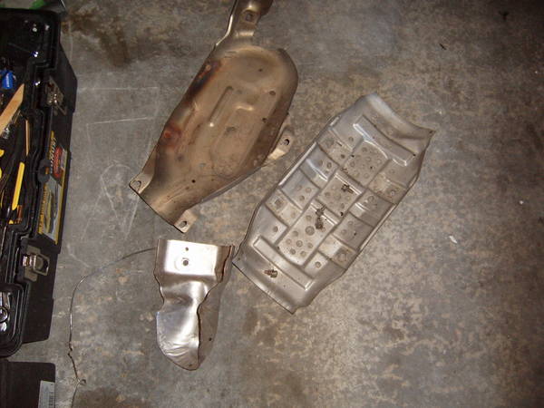

1. Remove all heat shields (10mm wrench).

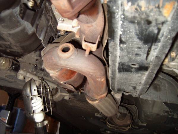

4. When all bolts are removed, take a 2×4 block and hold it to the body of car directly beside stock y-pipe at the rear bank. Take a 2 foot pry bar and put bar on top of stock y-pipe and under 2×4 block. Lift up on pry bar (with a lot of force) and stock y-pipe will pop out.
This is the stocker removed!

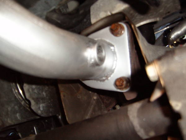

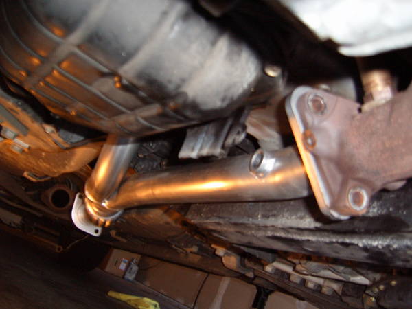

5.Put crush gaskets on new Y-pipe. Put rear bank up and use 1 bolt to hold rear in place. Front will need some convincing to go in. The flange will rest against the front bank down pipe. Tap (convince) with a hammer until protruding flange pops into down tube.
6. Replace 3 front bolts and 3 rear bolts.
NOTE. There is a shield between the oil pan and the new location of the front O2 sensor. Remove this shield (it won’t be used) and put bolts back in holes.

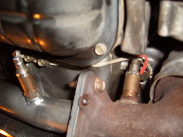

7. Replace O2 sensors.
See how California emissions have a lot of O2 sensors:

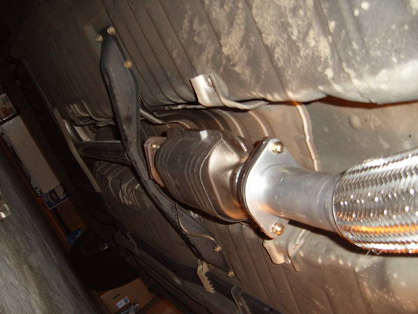

8. Put new cat in place and put gaskets where they should go. Bolt tight. Put new hanger in place.
