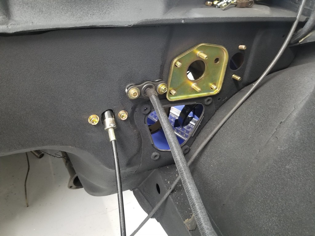

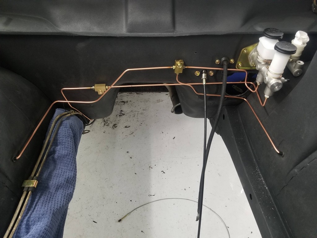

With the engine out, I noticed the old brake lines had been weeping, wrecking the paint on the fenderwell and frame rails. So, out with the master cylinder and the old lines. Plus, we’d be using different holes for the wiring and throttle, so I decided to clean up the firewall and delete the hood prop. Of course, with the new crossmember, I’d be upgrading to a steering rack, so the old box could go away as well. More holes to weld up, and more work, but it’s something that always bugged me, so may as well get it done. Here’s the fresh, smooth firewall, with new hardware, awaiting the engine install… and the new brake lines.

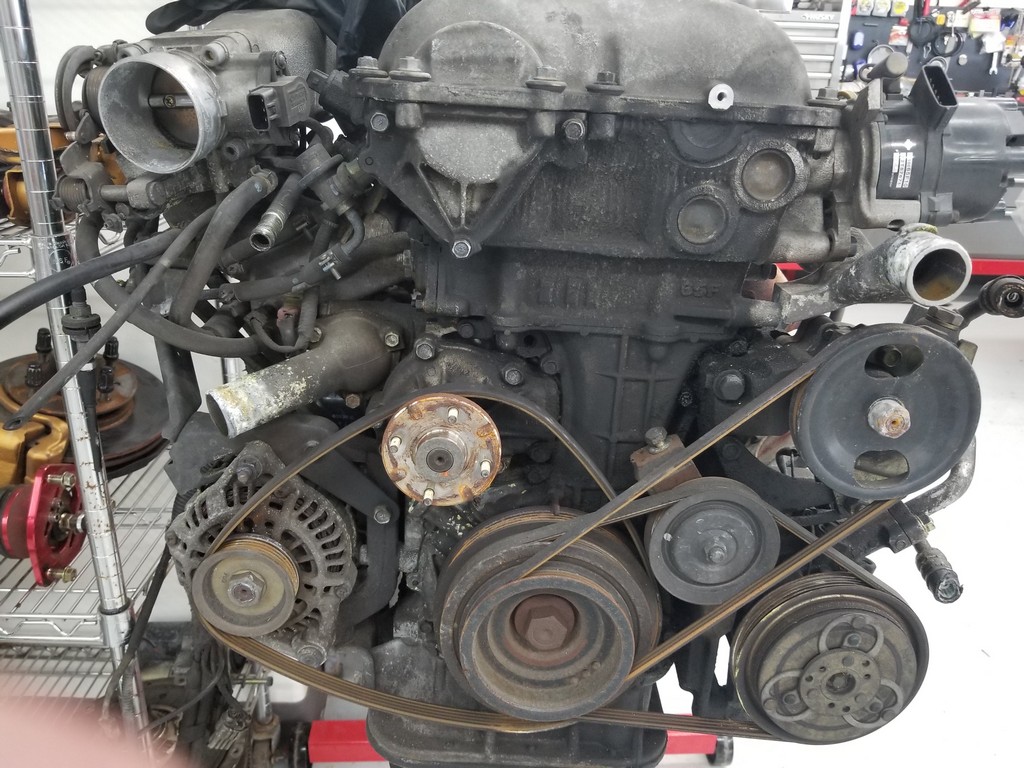

With the bay cleaned up and fresh, it was time to turn my attention to the engine. This one had perfect compression, and appeared to have never been touched. All the bolts looked factory-fresh, albeit coated with a layer of road grime. My suspicion was that the motor had a pretty cushy life for its 60k KM, especially with an automatic transmission. BUT, nothing gets installed looking like this, so disassembly began.

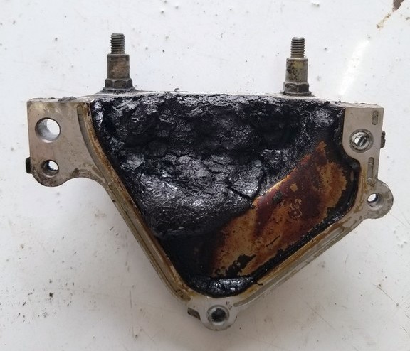

Cushy life indeed. Removing the valve cover and pan made me think maybe I’d made a mistake. I’d never seen an engine that gunked-up. In fact, I’d be amazed if it had more than a couple oil changes. Although the drained oil was clean, the thick black goo residing in the head and pan were terrifying. I mean, the VTC cam sprocket was literally encased in a cocoon of black tar. Here’s the VTC cover, just to give you an idea:

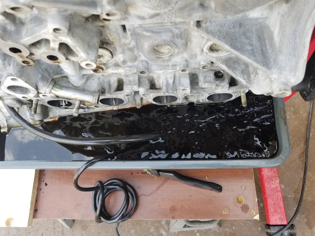

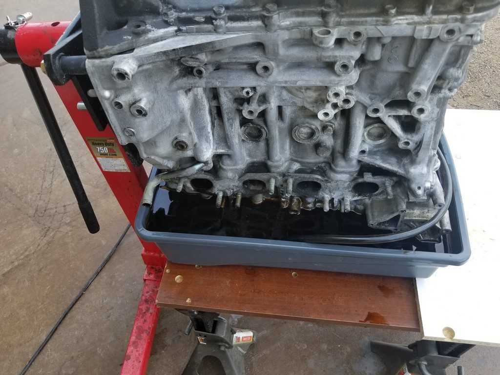

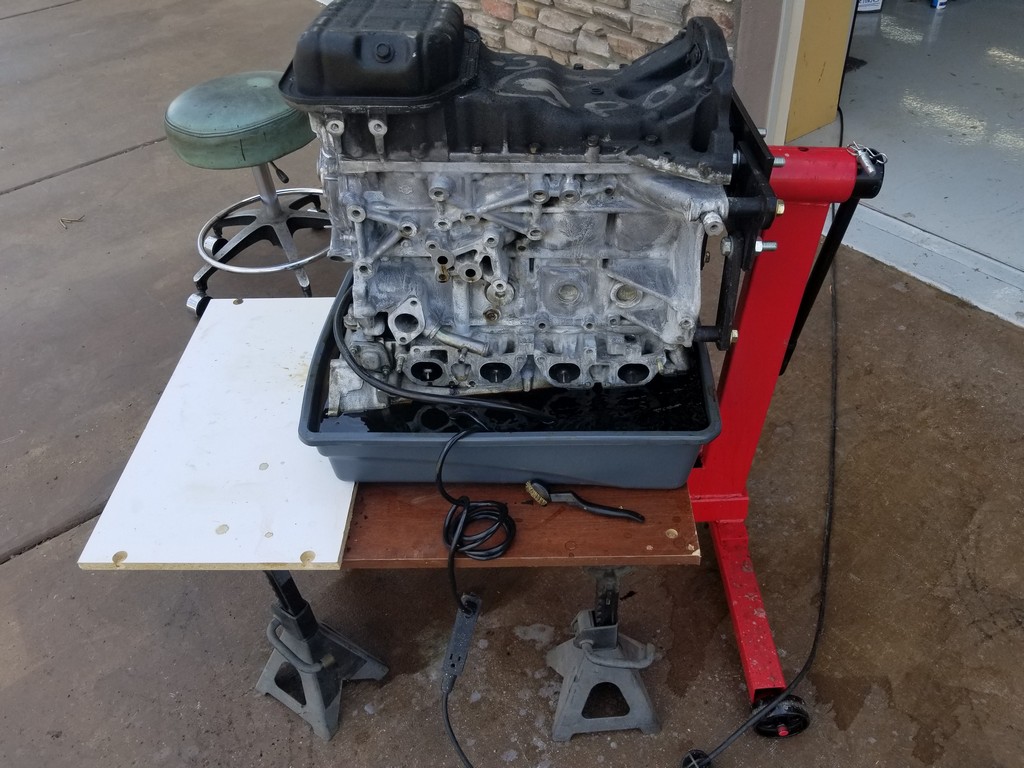

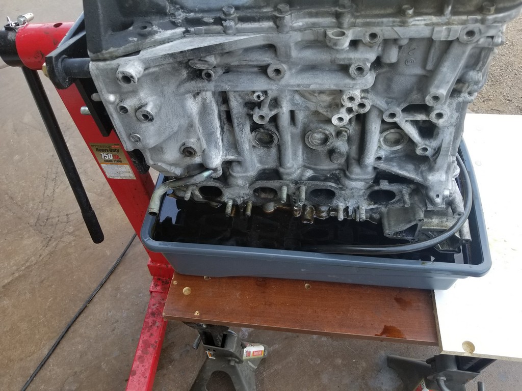

Now, how to de-funk an engine without a complete teardown and rebuild? Very carefully. I wanted to ensure that the solution went no further down than the valve retainers, and no further up than the midline of the crank. The rest would have to be managed by several immediate oil changes, after startup. I rigged up a cleaning station, so that the engine could be partially “dunked” in cleaning solution. With the engine immersed in a bath of my favorite degreaser, I circulated the solution with a small aquarium pump and a heating element, set to 100*F.
The bottom end sat in the cleanser for 48 hours. Another 24 hours to drain, and the surfaces looked fresh and new. Flipped the engine over, and immersed the head – same results. A good scrubbing of the exterior of the engine, followed by lots of tapping holes and chasing threads, ensured there’d be no surprises during reassembly. Finally, the block got masked, and a coat of etching primer and several coats of high-heat Eastwood gloss black engine enamel had the block and head looking factory-fresh.
