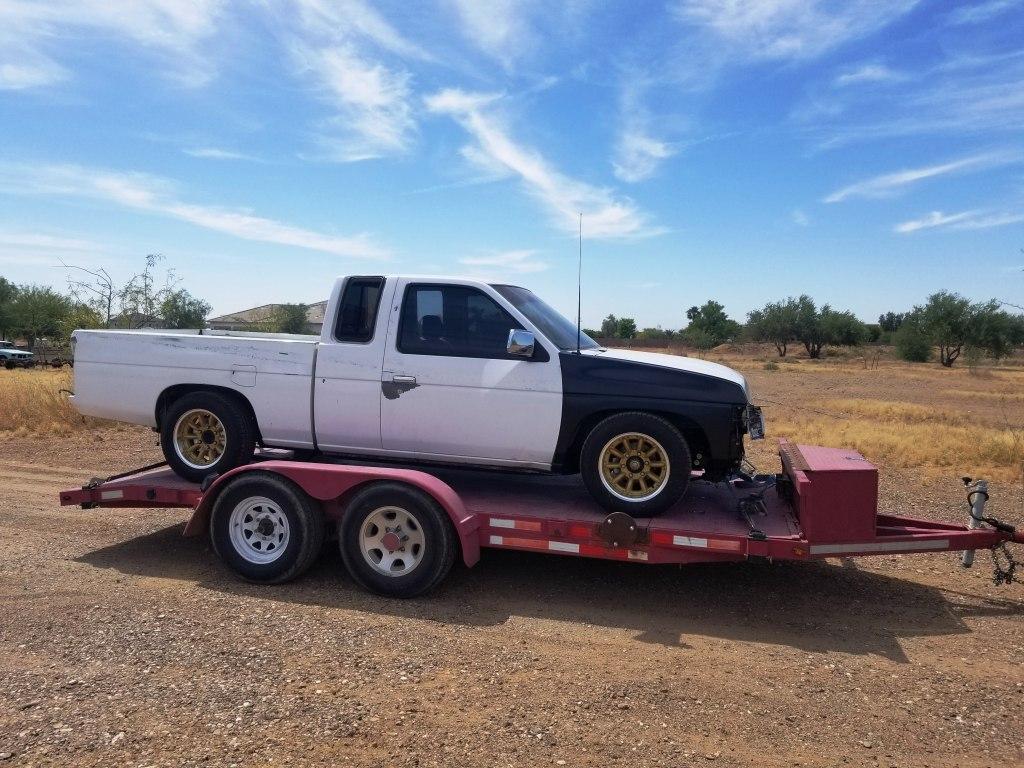

The truck lasted far longer than the relationship, but I recall that truck fondly… and it would be another 35 years before I actually owned one! Between projects, I ran across a not-quite demolished 1997 King Cab model for sale on Craigslist, and the price was right.
Now, small pickups in AZ command a hefty premium. Part of the reason is that they can be trucked down to Mexico and sold for far more than they’re worth in the US. Even a tattered, high-mileage example will sell for more than $3k here, because buyers snatch up all the cheap tired trucks and haul them south (10 at a time) for a fat profit. So, when I found this one, I called the owner and arranged to see it.

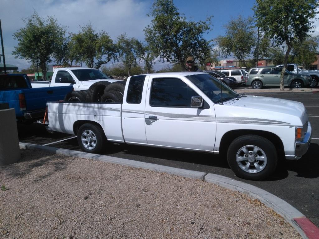

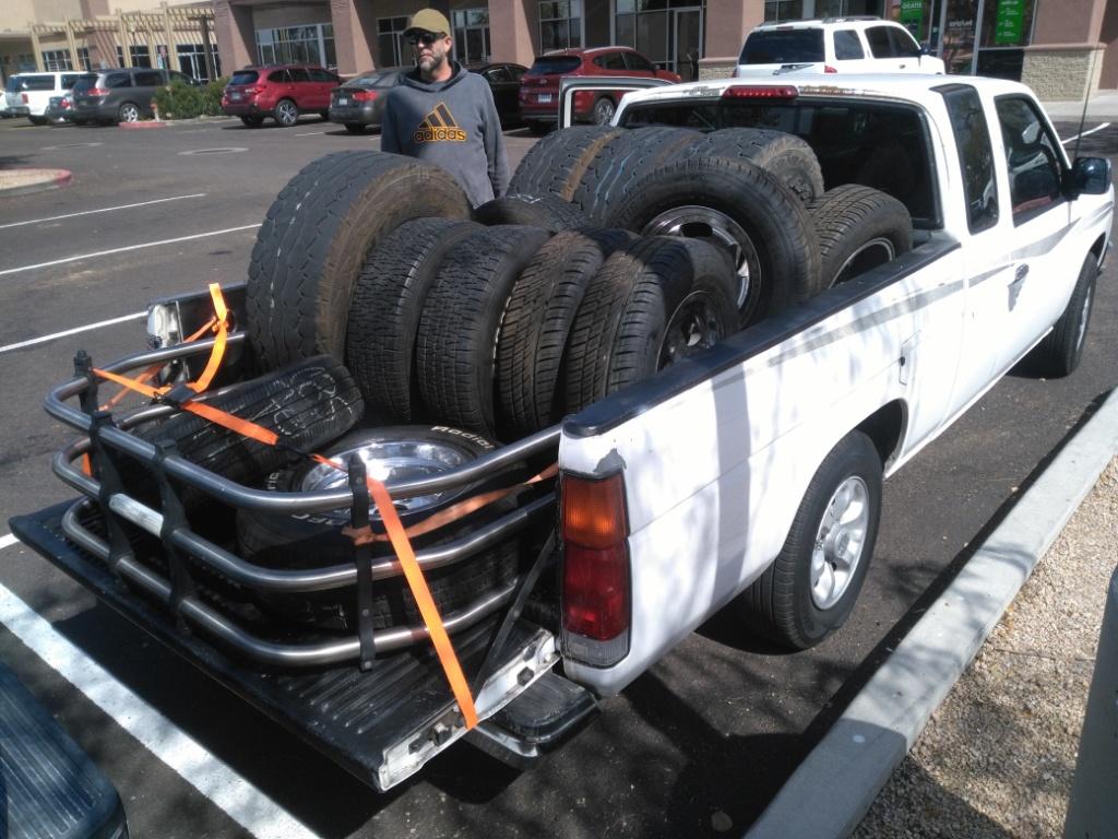

But, I was now the proud owner of a 5-speed, 175k-mile King Cab Hardbody that was bought new right here in PHX and never left the desert. They’re a simple vehicle, so I figured I’d make short work of this restoration. But first, she had some work to do, running loads of tires from Datsun Ranch to get dismounted, and taking us to lunch for a few days… It wasn’t long before the foul smell and sketchy maintenance forced me to park this one and get serious about doing something with it.

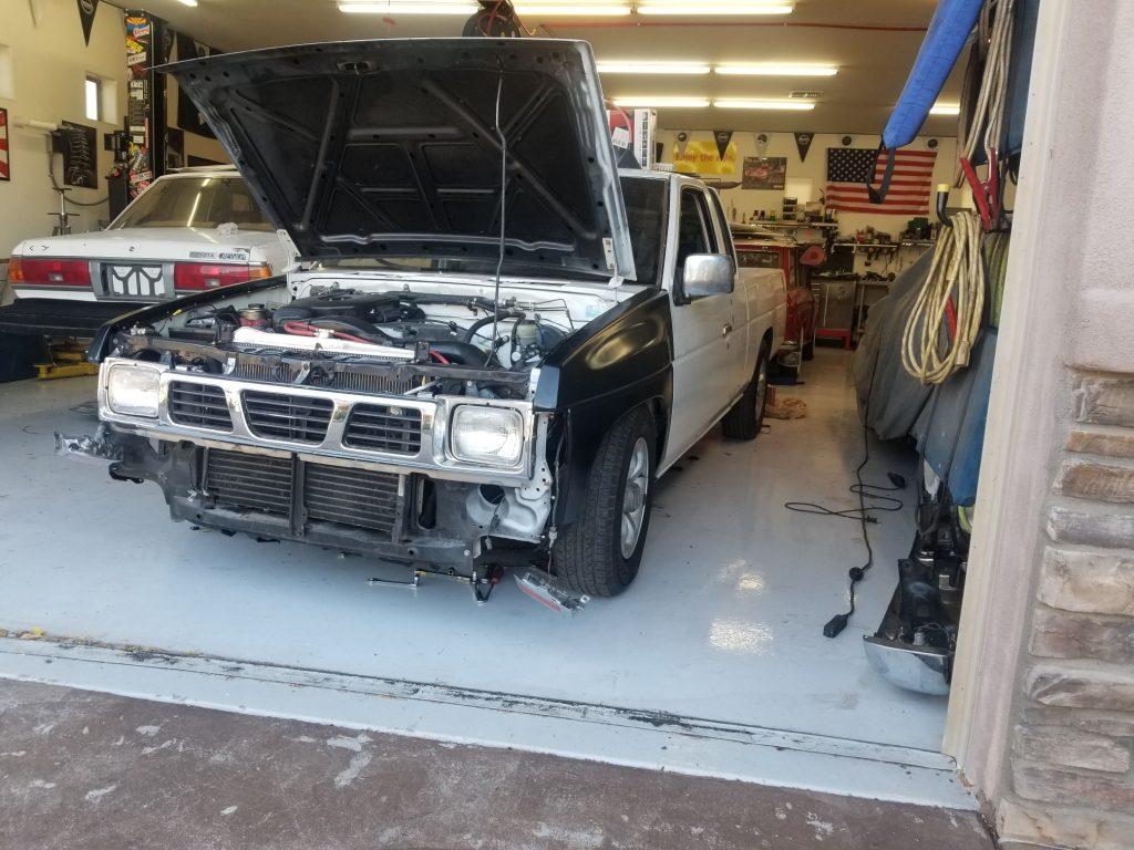

Next up, the motor and trans were pulled. Years of neglect meant every seal leaked, but miraculously, the compression was between 178-180 on all four cylinders. A quick look at the valves with a borescope revealed clean chambers, so the engine got scrubbed down, a new timing kit and water pump went in, all seals were replaced, fresh cap/rotor, plug wires and plugs, new motor mounts, power steering pump, fresh injectors, and a new SPEC clutch went in.
The Nissan Hardbody group here on NICO were super-helpful with sourcing parts, so I started collecting replacement bits. A dash from a truck in the Northwest, a fresh carpet kit, a pair of seats from a low-mileage wreck, and lots of other interior stuff started arriving at the shop (somehow, I’m still looking for a clean set of door panels and good sunvisors).
Looking at some other builds, I liked the look of the 4×4 front fenders, valance and flares, so I sourced a set of those from a wrecking yard, along with some power mirrors (which look way better than the “flag-style” mirrors that came on the 2wd truck). There’s a company that reproduces the cowl grilles, so they showed up next, and I topped it all off with a fiberglass roll pan for the rear.

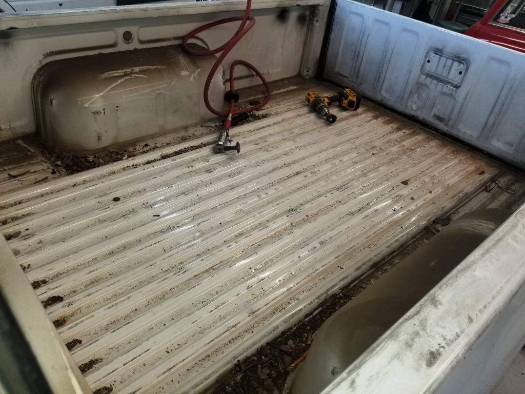

The bedliner was removed in order to do a spray-in liner, and I suspect it had been installed when the truck was new – the bed paint was almost perfect, with no wear or corrosion.

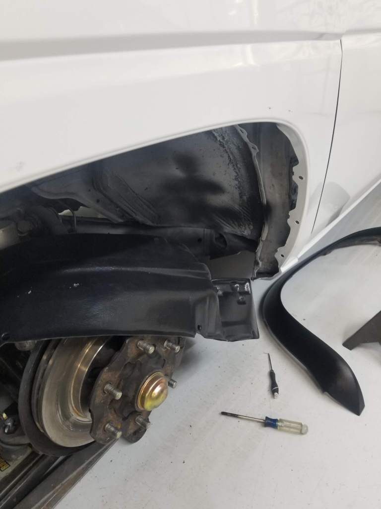

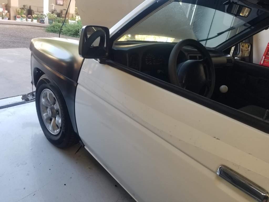

During all of the disassembly and reassembly, I discovered the truck had been whacked in the driver’s side front corner at some point, but had never been reported. Some creative repairs were done, but fortunately they were limited to the bumper, inner fenderwell, and fender. Some hammer and dolly work, along with repositioning the bumper brackets and corner marker holes, and everything lined up almost perfectly. This was a budget build, not a concours restoration, so I wasn’t even mad at the result.

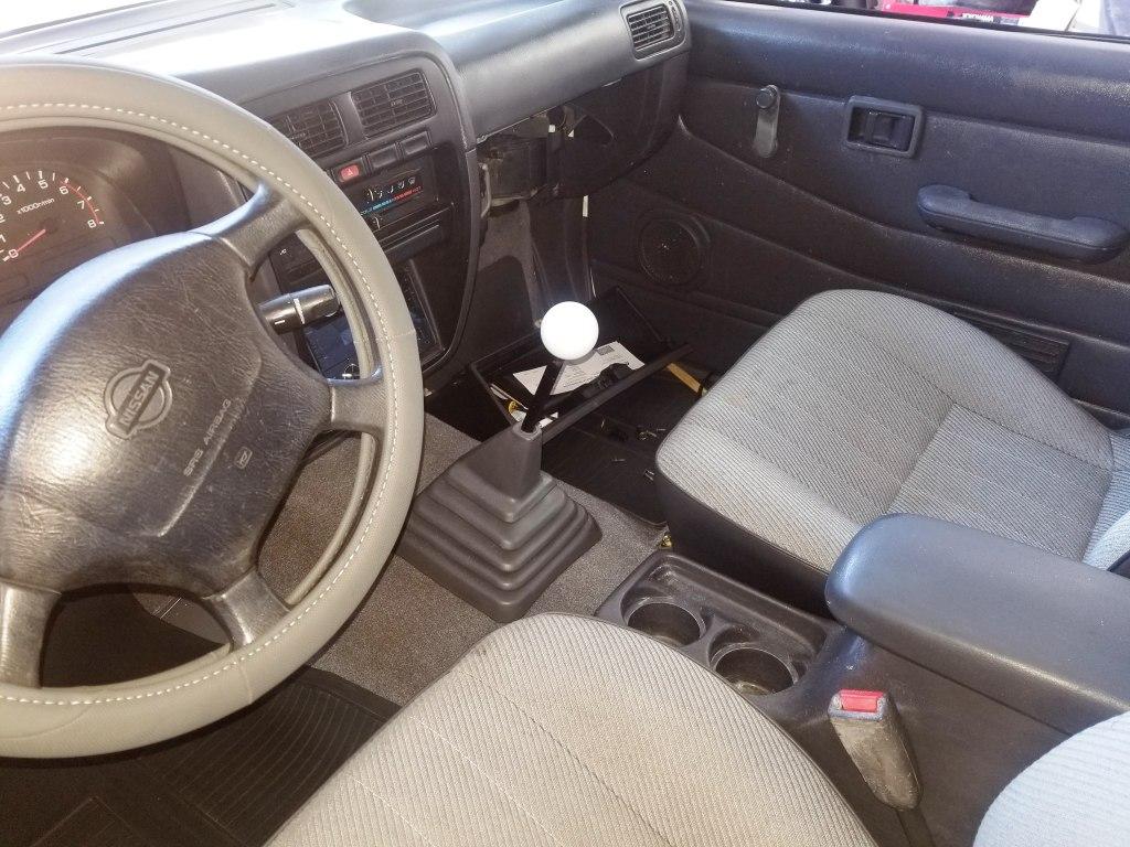

Reassembly went by quickly, and the interior really turned out better than expected. Dash installation had always been kind of a “No thanks” job for me (I HATE being up under a dash) but this one wasn’t horrible. A couple missteps getting the HVAC controls reconnected, and nasty cramps from laying on the not-quite-flat floor, but it came together nicely. A new double-DIN head unit, a set of 6″ door speakers and some 6x9s in boxes behind the seats, and she’s ready to cruise.
